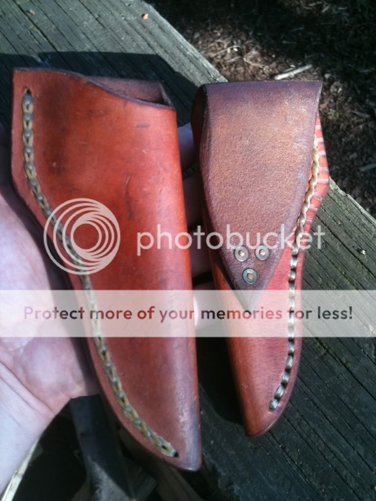

Paul, while your on the horn, can I request comments/critique about the sheaths? (You are the expert.) Have you made anything similar, or variations in this style? Ed calls it a pouch style sheath, and they are quite rugged! Minus any beauty it might lack.

As for his sheaths they look simple and well built besides for the I guess you would call them rivets . I would prefer stitches.

David, per your request, the Ed Fowler sheaths, that I have seen both in photos and in hand all have several features in common. They are ALL, no nonsense, pouch style sheaths that are hell for stout and should last any one a life time (particularly if they die when they ought to).
They all appear to be made of unlined harness leather either oil tanned or oil finished. It appears to be about 10/12 oz, leather cut from the shoulder, butt or other other strong part of the side, because the flesh side of the leather is not fuzzy and rough. They are all stitched with what I believe Ed calls a chain stitch (and I call Arrowhead stitch). They are stitched with "Artificial Sinew" which is a heavily waxed nylon and darned near as strong as an anchor rope on a battleship. Integral belt loop held by two or more copper rivets. (I don't use rivets period, but if I did and I wanted it to stay together forever, those would be what I would use).
Under extreme hard daily use I suppose one could wear one out, just like you could a pair of really heavy duty boots, but I bet it would still be holding the knife securely on the last day.
Paul

Thanks Paul, quite a write up! I hope Ed will see what you wrote.. I know it mirrors his intentions, the sheaths and knives.

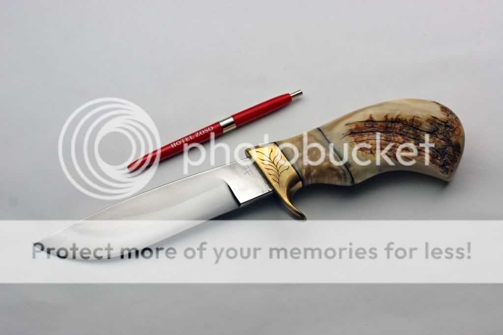

Rob, I really like that little "Fawn", and by that i mean I REALLY like it!
Paul
Rob, I also like that Fawn alot! Its a good photo and shows how clean that particular knife is. Also the sheephorn has alot of translucent thing going on.
I really like that one, Rob, looks like a cutting machine ! :thumbup:
Doug

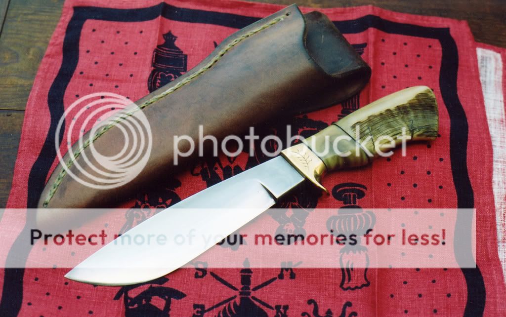

This one is what my friend Jose calls the Fowler "Bolo". It was the first real Fowler knife I bought, back in 1998 (Blade Show) close as I can remember. From dealer Cleston Sinyard. He said that Ed had originally made it for a Frenchman to use in a contest.
The Fowler aesthetic doesn't usually do anything for me, but that Bolo really speaks to me. Congratulations on being the owner of such a fine knife.
