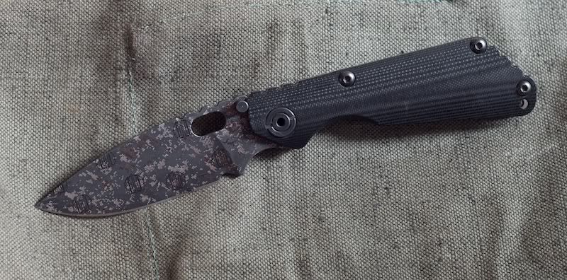

EDC!-Which knife or knives are you carrying today???
This beauty just fell in my mailbox so I'll carry it today :)

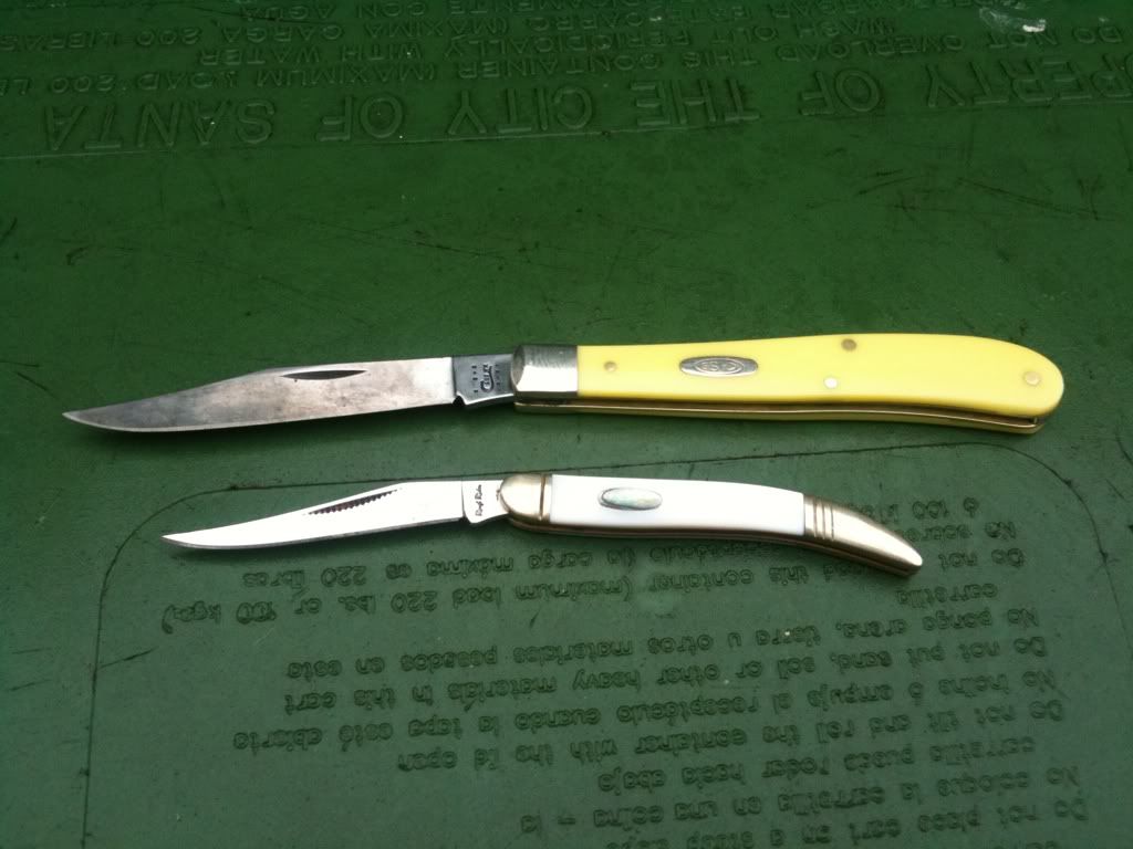

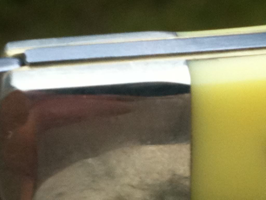

Case just cant get it right.
After receiving 2 different Slimline Trappers from online vendors, I returned the most recent one to Case. 5 Weeks later they sent me a replacement knife with the same problem. When the blade is open, the backspring does not sit flush.

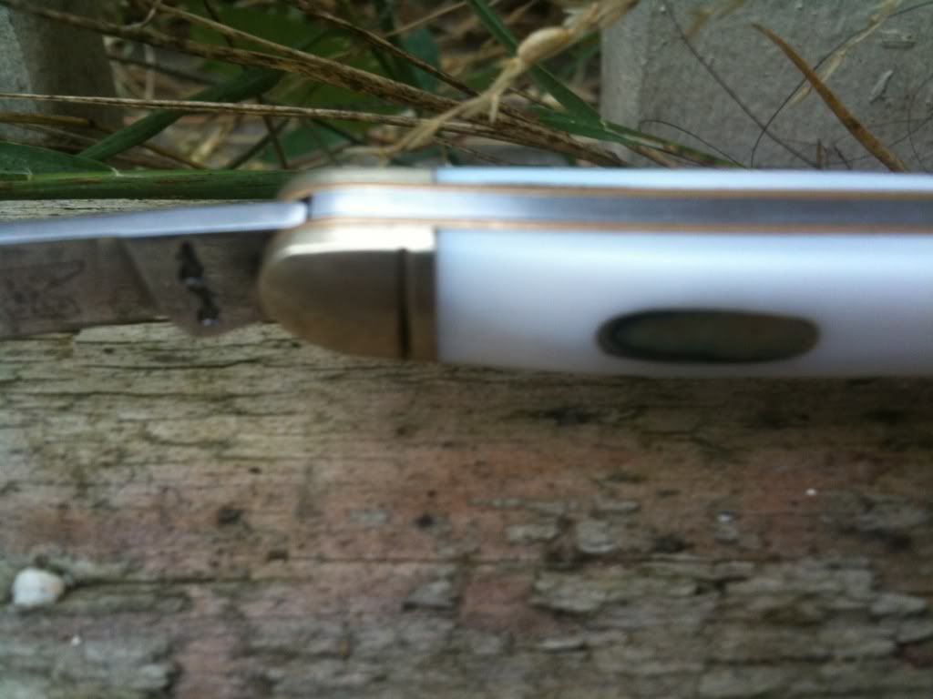

My Rough Rider mini toothpick does not have that fit and finish problem.. I dont plan to buy any more case knives online.
When I spoke to Case service, they told me they could grind down the backspring so it sits flush when blade is open, but then the backspring would sit low when the blade was closed. I explained that such a "repair" would not be satisfactory, so they replaced the knife with another defective one.. oh well, Im keeping it anyway.
OTOH, the case has a very nice size blade for apples and food. The mini toothpick actually bends if you try to peel an apple with it..
first pic is the Case backspring, blade open, then the Rough Rider, and then both knives, on top of my garbage can..
When you have the knife around halfway you should be able to get a diamond file in there to take a little material off the spring seat on the blade...this is why I do not own a Case knife.
