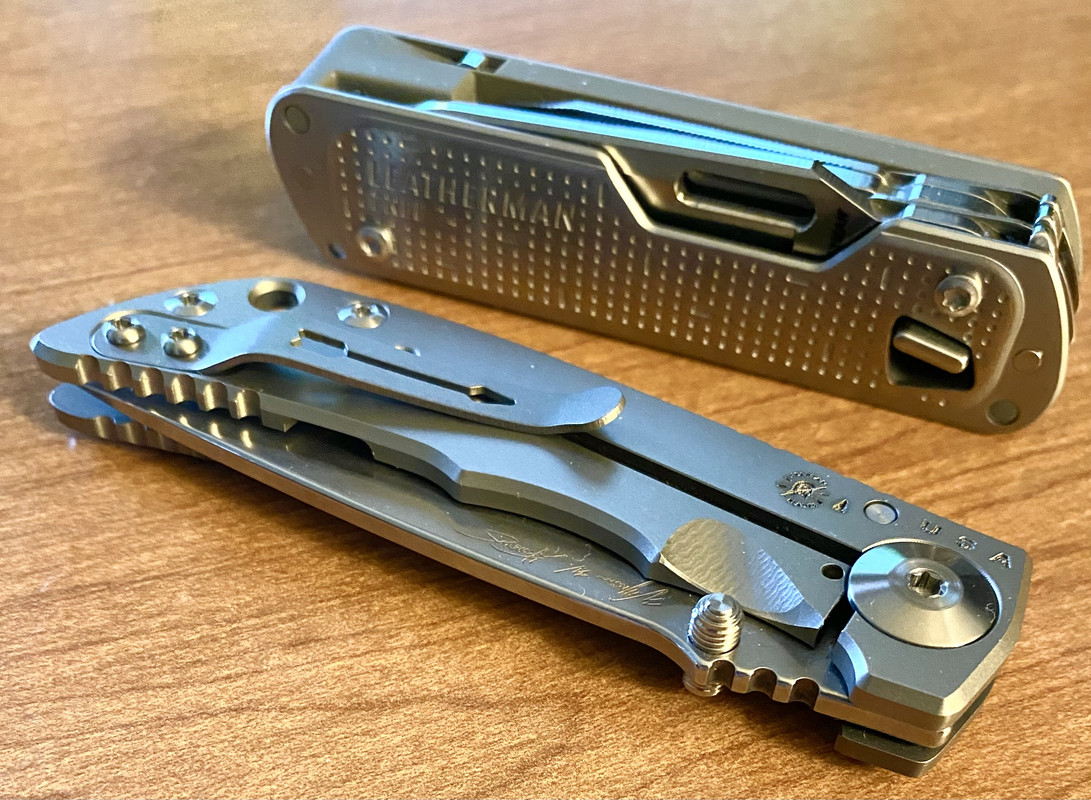

Decided to trick out my OG Shaman with a set of textured titanium scales. I'm very happy with the results! Did have an interesting experience with the install.
Being the lazy bastard that I am, I decided to remove one scale at a time and replace it. That way I wouldn't have to do a full take down. This worked well enough, but when I tightened everything back up the blade was off center, and there was a ton of side to side blade play. Since shortcuts rarely work I had to do the full take down anyway.
What I found was the factory had installed the captive pivot backwards on the knife. I bought it new and had never serviced it so it had to be the factory. The reason I had never noticed it before was they had pressed the pivot in with enough pressure to leave a burr in the captive side liner where the round was forced in against the flat.
A little clean-up, removing the burr with a jewelers file, getting the pivot in correctly, oil and assembly and the action is perfect. I was never in love with the knife because the action was too loose. After, it's got just the right amount of resistance. Will be getting a ton more pocket time.
