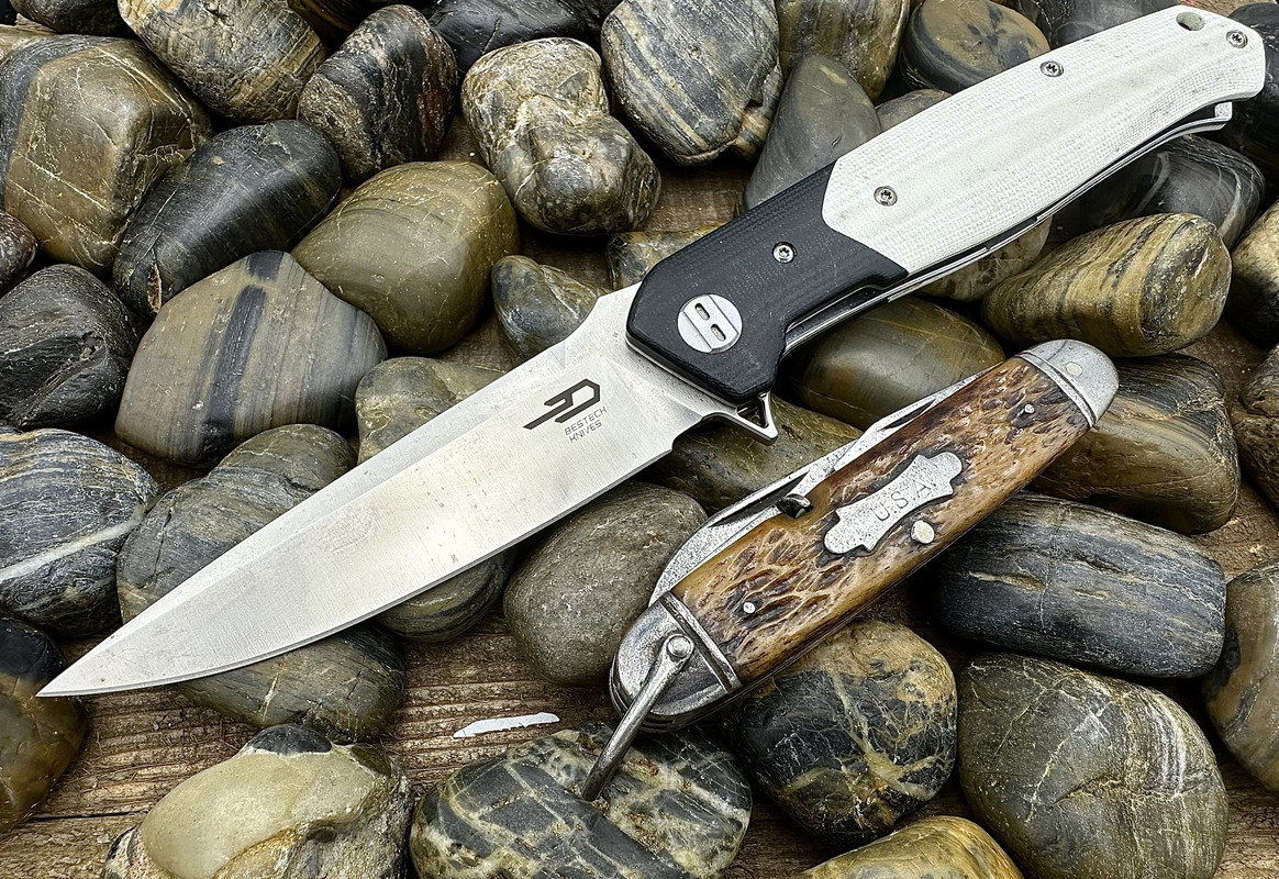

I've been pretty much absent from these pages lately as I've been spending a lot of time both on youth b-ball admin for my club and league as well as feeling like crap as my nasty cold slowly abates. I've actually even had to write practice plans and run a few tryouts, despite being basically retired from coaching for a number of years, as I've had to sub in for one coach plus helping out a former player and coaching rookie as we're fighting to build a new team at one grade level.
Anyway, I've been carrying the same knife for a few days and finally got to snap some pics late this past afternoon before heading out to an early evening tryout/practice. At the midpoint of this three-day carry it actually was a Wilkins Wednesday.
That guy on the right is really cool, what is it?
Here's the sale thread.....Pretty cool...... BogdanS BogdanS does nice Work!!👌
