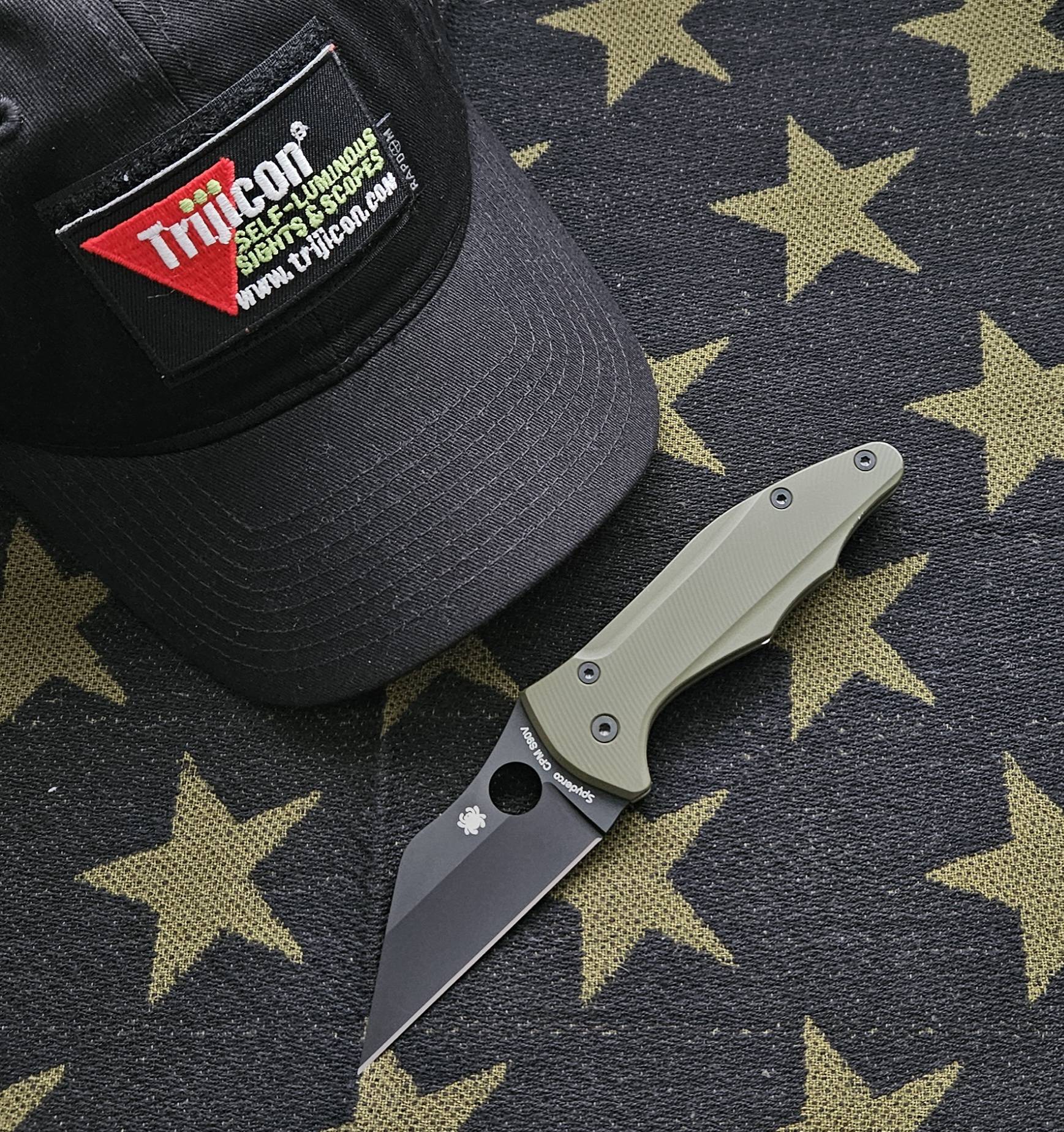

Had to take the wife to Walmart this morning and just happen to see one of the ozark trail crossbar locks figured I would give it a try. Fully expected it to be crap but it’s actually pretty darn good for $8IMG_8745.jpegIMG_1522.jpeg
