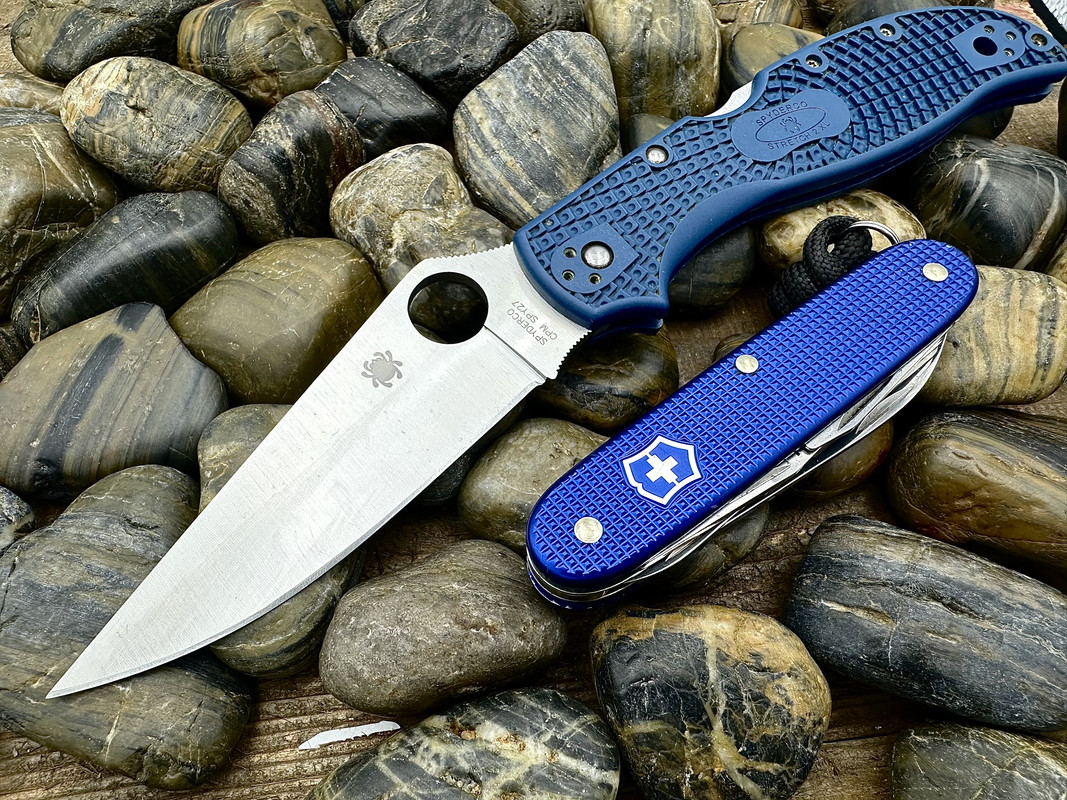

Carrying these two after a fresh sharpening:
