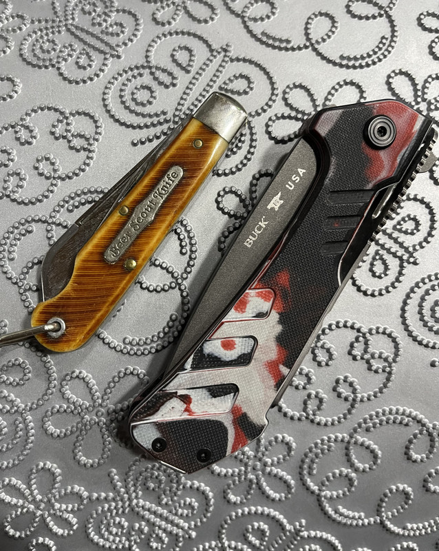

Anyway, today was dark and wet and I didn't get any fresh pics, but here's a couple oldies of my Micarta Mar Monday carry.
