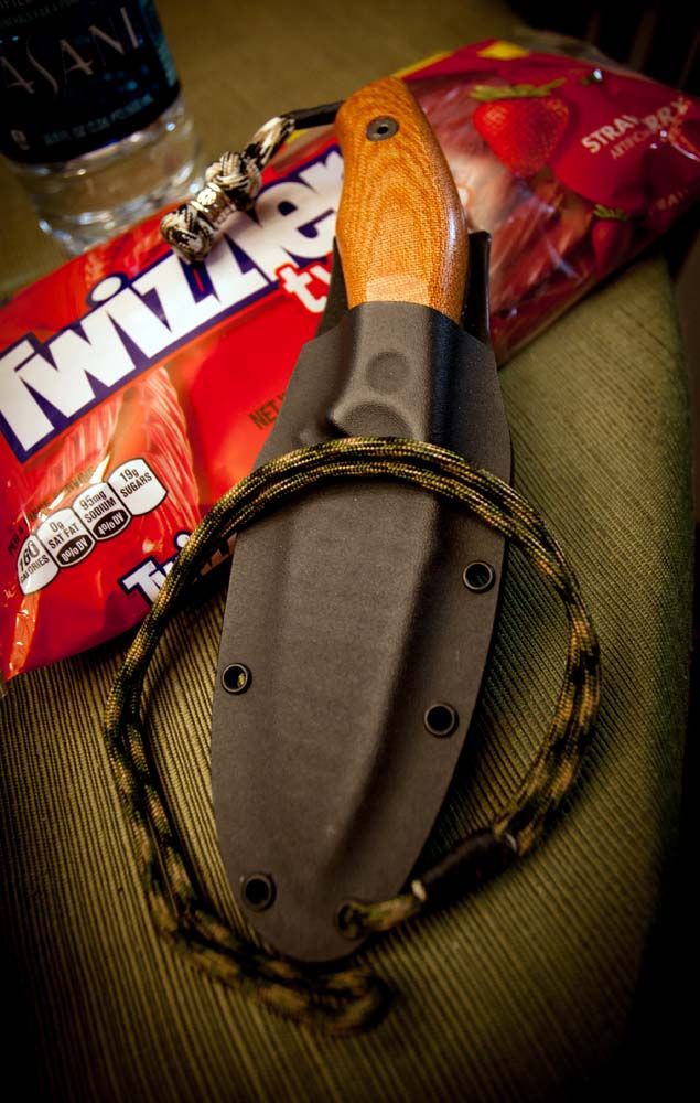

That be sharp, so is mine, quite sharp indeed! Here's a quick shot taken tonight, knife sheathed up, a static cord attached at the bottom that I loop around the belt and slip the sheath between me and my belt, grabbing the knife, it comes into play quickly and out of the sheath as it reaches the end of the static cord, which will leave the sheath dangling but that does make it easier to return, safer too. I've taken to this type of carry as sheath knives are not welcome at work, so a more covert carry is in order.

the Twizzlers are for the road trip tomorrow to the Ashokan Seminar ;) a bit of a drive, about 4 1/2 hours

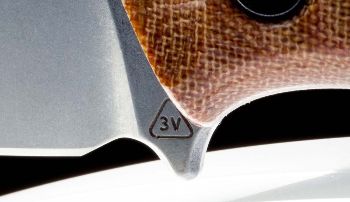

after having and using this a for a short while, I wanted to make note of some of the design and execution on this knife
EDC_edge_start.jpg~original
Notice how the edge starts out, there isn't a sudden abrupt drop as some will make, but a nice gradual slope up and onto the edge, a great compromise for those that need to have the edge out a little to help during sharpening.
Also the metal guard area that drops below the micarta has very subtle chamfering done, making it somewhat easier on the mitts during use. Now for me, I'd prefer that the micarta came further down to really provide some fuller area to have your finger come up against as even the rounded edges are still small rounded piece of steel and that can impact against your finger, small point but just an observation.
Everyone I have shown this knife to just loves how the handle's shape is angled and how the micarta is both machined and the surface finished, just superb Nathan, well done sir and Lorien kudos on a great design.

you'll notice in the photo that the leading angle of the sharpening notch is shallow, as Gary rightly pointed out. Although you give up some edge for it, cloth, cordage or whatever doesn't hang up in there. Very important consideration for a knife like this, and like most important considerations done well, you'll never have to consider it since you'll never need to notice it :)
Yep that's what I was pointing out :)
