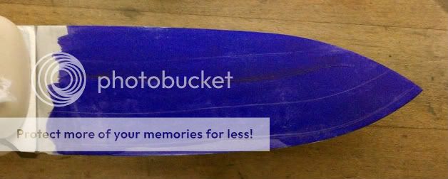

Great observation! Dan Farr and I were discussing this thread, and he suggested I posit a 'down and dirty' method of measuring the blade's overall profile:
First, magic marker or Dykem your blade:
Next, set your calipers for the first thickness scribing (in this case, .020"):
Straddle the blade with your calipers, and gently slide it the length of the blade. Repeat with greater thicknesses (in this case, .050" and .100"):
This will tell you a couple things... how much meat you have behind that edge along the entire length, and whether or not you've got high spots or dips (intentionally or not!). Thanks to Dan for presenting this to me at his shop this weekend... I'd been doing it on a point-by-point method, making a smear of measurements along the length of the blade instead of all at once!
Thanks for sharing that, Matthew! I was curious(and nervous) to try this on the 4" woods blade I had posted earlier. There has been some work done on it since and it is freshly etched. The final sharpening still has to be done but this is where it sits at .020",.050" and .100". It is right where I wanted it, with a gradual thickening toward the tip. The spine is 1/8" thick.
Very cool Matthew, like making a topo map. That's a great, understandable way to illustrate the overall geometry of the blade. :thumbup: Please pass my thanks on to Dan.
