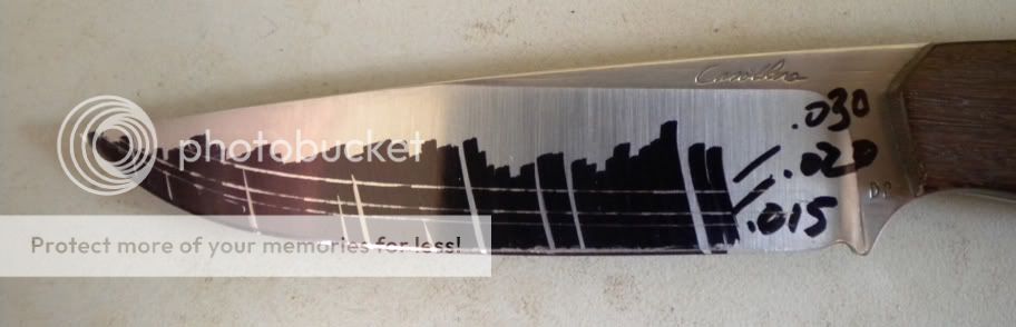

Edge geometry

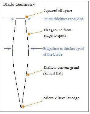

Wow, a lot of thin geometry. Are you using thin steel to start or do you like something with meat at the spine? My go to thickness for an outdoor knife is 5/32. but I use 9/64 to7/32. D

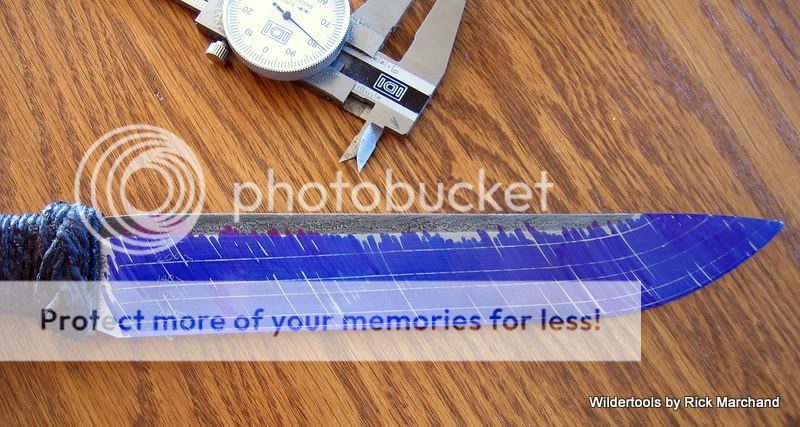

This is my personal user (Model, Tanto) and and flagship for my over-engineered line of bush knives. 1/4" at the Shinogi(hope thats the right name) At 8 1/2" long, this thing chops like a 14" parang. It is perfect for what I need in a bush knife. It obviously wouldn't "excell" at wittling or kitchen work because it's so honkin' thick.
I am really liking this blade mapping thing. I get to go back and view my old blades with a new set of eyes.... thanks again for bringing this up Matthew.
Tanto @ .020, .040, .100, .140, .200 and .250

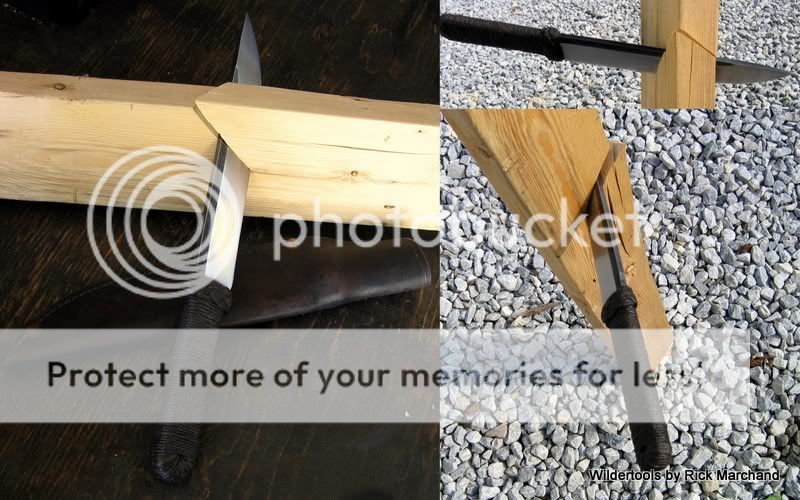

Very nice. What do you call it, in case one pops up on the exchange.
tell me you batoned that knife into the wood Rick, or that you drank some radioactive concoction which gave you superhuman strength. If the latter, please send some my way
No, the knife is just SO sharp it moved through wood like it was butter. Right, Rick? ;)
That is not batoned or faked in anyway. I was really surprised it bite that deep... I will remove it (it has been in there for almost a week... lol... and give it another wack on video this time. I don't go for that trick photography crap!
