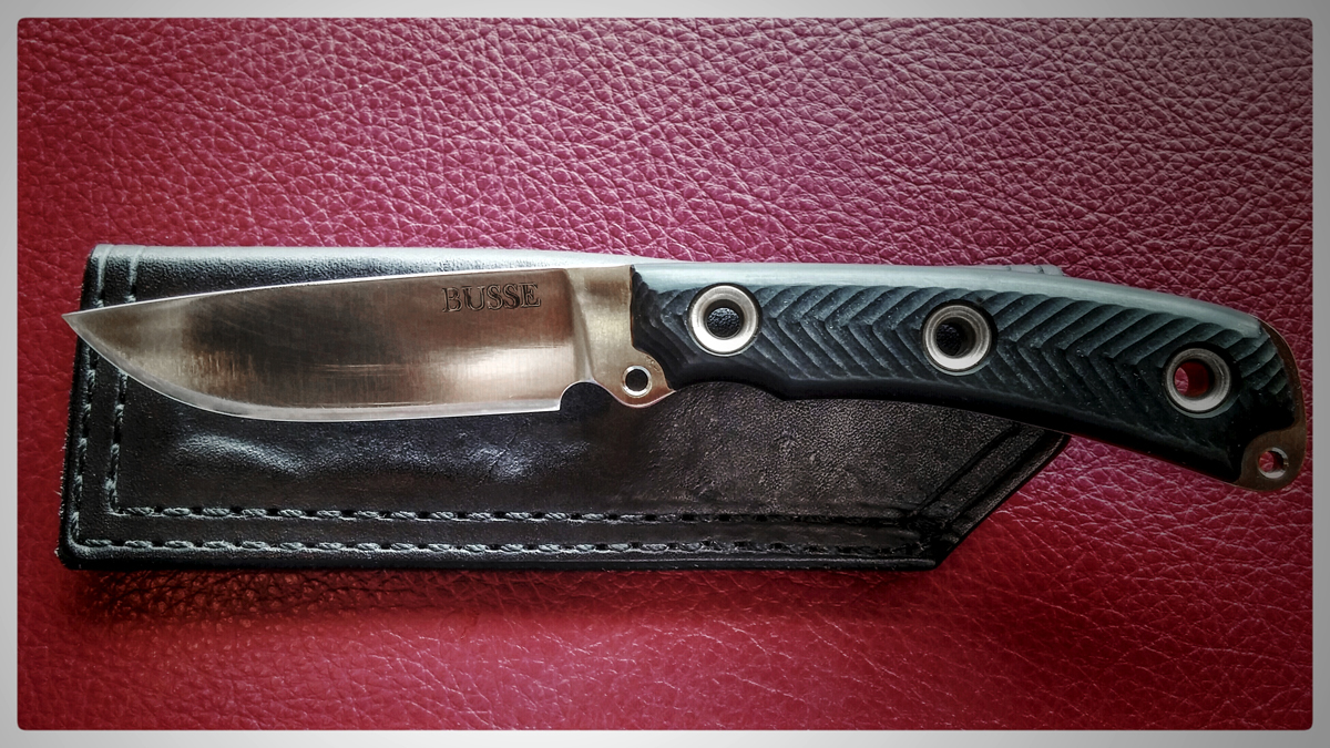

Sharpened my one and only busse for the first time today:thumbup:
Only convex edge knife i own, and only have a sharpmaker..
Had read about the mousepad/sandpaper method..
Too easy!! And cheap
[/URL][/IMG]
[/URL][/IMG]
[/URL][/IMG]
[/URL][/IMG]
Its a lightsaber now!👍
By far the best knife i ever had👍
Until today i only stroped on a old belt too keep it sharp.
But the edge had got some dings i could not straight out, so took a few swipes on 1000grit wet/dry sandpaper..
It's perfect again!
This thing cuts like a demon! Oak, hard plastic, fingers.. Its all just like butter👍
Never had anything impress me like this blade!
This i will bring to my grave!
