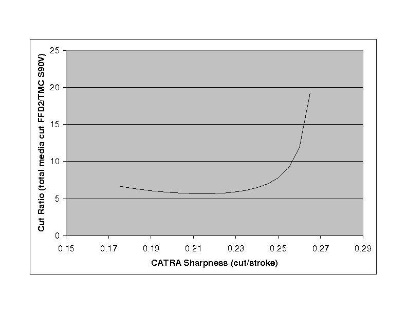

But I haven't been able to understand how you estimated the uncertainty for the cut ratio. That's why I keep asking the question.
It is determined a hundred times or so in the montecarlo fits and an average and standard calculated.
Would you show me how to transform the functions so the advantage of FFD2 is a million percent?
This is highschool algebra, let f1 and f2 be two functions. Now if you are taking a difference then scaling the function will scale the difference :
Diff = C*f1-C*f2=C (f1-f2)
A ratio is no different simply consider the transform g(x)=exp(x), that will induce a huge ratio transform. You have to show that the transform that you use is physically meaningful.
Yes, and I maintain that the "transformation" I use is physically meaningful. I do a difference and a ratio in order to convert from total media cut and total number of strokes to cut per stroke, which is the CATRA-defined measure of sharpness. Do you maintain that this is an improper transformation?
If I were calculating ratios of exponentials arbitrarily in order to inflate performance ratios, I'd feel that your concern were warranted. Is there a particular transformation we've done that you feel is unfair or inappropriate?
BTW, I'd still like to know what it is that becomes "undefined" in your analysis of our data. I haven't been able to make anything become undefined.

Parameters are undefined :
http://www.bladeforums.com/forums/showpost.php?p=4652989&postcount=103
Parameters are defined :
http://www.bladeforums.com/forums/showpost.php?p=4653019&postcount=104
Here is the text of this link that you posted;
There is no statistical proof that the FF blade has superior edge retention because the blunting factors are too uncertain because of a combination of three factors :
1) lack of data in the initial region where the rate of blunting is high
2) lack of data in the tail region of S90V
3) high uncertainty in the data
In regards to the initial low cutting ability of S90V. Based on examining the actual data there is a misconception in the above. It was stated that the S90V blade does not cut as much material at the start. The first point measured is AFTER 20 CUTS. This is much too far too make such a statement as the initial rate of blunting can be very high for large carbide steels, especially if the edges are acute and/or polished. I would affirm if the cuts were measured at 2,4,8,16 then you would see a much higher initial performance from S90V.
The above data is also a very poor way to compare the blades because what it does it take two dependent variables which are highly noisy, divide them and magnify the noise and then plot essentially two dependent variables so now both the x and y axis are highly noisy. This actually reuquires very complex methods to fit properly even with simple models because this adds another element of nonlinearity into the problem. What should have been plotted is just the stroke count and amount of media cut. This would give a much smoother curve as the x axis variable is independent then and has no noise. It is also much more straightforward to rationalize as it just shows how much media is cut after a certin amount of passes.
The above graph attempt to show the sharpness after a certain amount of media is cut but as I noted it magnifies the noise and introduces an additional nonlinearity. I'll look at the other data shortly.
You assert that parameters are undefined, but you don't show which parameters from which fit algorithm. I've been asking this question now for two weeks, and never got an answer.
If by parameters, you mean the a, b, and c parameters, I would point out that the plot shows values of the a, b, and c parameters. The parameters are not undefined. The fit model did not fail to converge.
Quoting from your link:
Note how the plot is much smoother and more stable. This is also due to cumulative plots being inhernetly an averaging process plus not plotting two dependent variables. Fitting this data is MUCH more robust because of these two issues and note the model parameters are precisely defined.
Now based on the model and the results you can say that over the course of the material cut that the Friction Forged blade outcut the S90V blade by 30-50% more material under a given amount of work. This would be directly used by the used to infer how much more cutting you would be able to do with the knife with a given amount of fatigue.
It is also possible from the model (just use the equations) to find the other intercepts if so desired. If it is unclear then just ask and I can perform the required calcuations.
Again, you don't describe which parameters are good.
If by parameters, you mean the a and b parameters, I see that a and b parameters fit. However, I don't believe you've explained the model that you are fitting to obtain a and b. So I still can't replicate your work.

Since Cliff hasn't told me how he proceeds, I can't duplicate his work. So I'll show you what I would do to determine cut ratio based on the curve fits.
First, I want to point out that the specific values of the "blunting parameters" are of very little importance in this analysis, IMO. These parameters are just "semiempirical" (I would say "empirical", but that's a minor point of difference") parameters used to make a curve fit the data. Once we have the curve fitting the data, we can use the curve, even if there is uncertainty in the parameters.
Since the metric of interest here is cut ratio, or the relative cutting ability of two different knives at a given sharpness, we'll calculate this ratio, given the curves.
For each curve, we have C(x) = Ci/(1+ax^b). We solve the curve for x (which means the total media cut for a given sharpness C(x)). This results in
x=((Ci/C(x) - 1)/a)^(1/b)
We then calculate the cut ratio as x1/x2, where 1 and 2 represent the different blades.
I've plotted the data from this calculation below. It may be difficult to understand. On the X-axis, we plot the CATRA sharpness, in inches of media cut per stroke. Low sharpness corresponds to later in the test, so the curve appears "backwards" from what one would expect. The initial results are on the right hand side of the curve, and the final results are on the left hand side of the curve. On the Y-axis, we plot the cut ratio, or the total media cut for FFD2 divided by the total media cut for S90V. If the performance were equal, the cut ratio would be 1.
As you can see, there is a very high initial cut ratio. This is due to the unexplained higher slicing sharpness for the FFD2 blade at an equivalent REST push sharpness.
Later on in the test, the cut ratio decreases, then finally increases. The minimum cut ratio is a bit over 5.
My earlier hand calculations showed a cut ratio of about 2. The difference between the two calculations is that this calculation is based on the average, or curve fit, estimate of the performance. The previous calculation was based on the maximum estimate of the S90V performance and the minimum estimate of the FFD2 performance.
What are the potential problems? I think I finally figured out what Cliff was concerned about. The a parameter for S90V has a mean value of 0.0016, with an uncertainty of 0.0019, which means it can't be shown to be statistically significant to be different from zero. If these parameters were independent, we'd make it zero, and recalculate the curve. However, the covariance matrix of the parameters shows that the parameters are not independent, so we can't just toss it out.
I don't attribute this parameter value to "noise", as Cliff does. Rather, I attribute it to the fact that the measured data for the S90V doesn't appear to have the same shape. I think this is what Cliff meant when he said we didn't test the S90V long enough. But we were only interested in the data during the sharpest portion of the blade life.
In future testing, I'll be more careful to do multiple repeats, micrographs of the blades, etc. I agree that the data could be better. But I also believe that the data does tell a story and have some information, and that the FFD2 performance is better than S90V.
Carl
