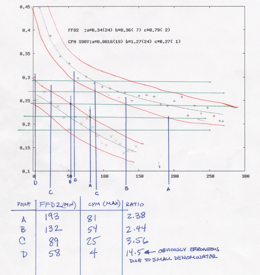

I've done some analysis. I realize it's only by hand, but here it is.
This is done with data you plotted, including our data and your fit. The data has the "difference equations", i.e., we matched it to CATRA ERT data by calculating the (media cut per stroke) by dividing (difference in total media cut) by (number of strokes).
As can be seen in the image, the curves fit the data quite nicely, even though there is noise.
Since Cliff prefers to calculate a cut ratio, and the non-linear optimization routine he uses can't handle the amount of noise in this data, I decided to try a worst-case analysis.
I offset the actual curve fits by enough to completely encompass the data. There is no statistical basis for this, but the red curves on the above figure show performance that enclose all of the measured data.
Then I drew horizontal lines on the plot. The plot does show the weakness that there is a limited range of data on the y-axis (cut per stroke). This is because we stopped measuring when we got REST values above 3.0N, which corresponded to a loss of shaving. Our primary analysis was not based on these curves, because we weren't using Cliff's algorithm. So the data is not well suited for Cliff's algorithm. Probably the next time, we'll take more data to do a better job of matching his algorithm.
At any rate, there are four horizontal green lines that cross through the red curves showing the maximum performance of S90V and the minimum performance of FFD2. At the intersection of the green lines with the red curves, I've drawn blue vertical lines. There are two lines labeled A, two labeled B, two labeled C, and two labeled D -- one coming from the maximum S90V performance curve, and one coming from the minimum FFD2 performance curve.
Where the blue lines cross the x axis, we have a measure of the total media cut to a given sharpness value. Then, in accordance with Cliff's procedure, I've calculated a cut ratio.
Based on this data, I believe it is conservative to say that the FFD2 has a cut ratio of at least 2, compared with S90V.
No, I can't put confidence limits on the data. Yes, I'll be working on it over the next few days. But this is the data that Cliff said he couldn't draw any conclusions from. And I believe conclusions can be drawn, even if they're only preliminary.
Cliff won't like this, and will say it is misleading and biased, and not supported by the math.
I'll let the reader be the judge.

I found Carl's exercise of plotting the data and using the easiest curve fitter available (your eyeball) valuable after the exhaustive numerical methods discussion. Look at the data - hand draw your own best fit lines (mine is almost on top of the one drawn using all the math), draw the limits of accuracy (or noise) as Carl's red curves show. Look at it and decide for yourself whether the data points show a strong trend or are all over the place (too much noise). The data looks pretty good to me using the trusty eyeball method.

...that a soft edge will bend, a too-hard edge will chip, and a just-right edge will flex, then return, without chipping or bending.
This is a completely undefined test, all steels have an elastic region obviously. I showed years ago how the same edge would pass or fail (both ways) this test simply by adjusting the angle. THis is basic metallurgy and shown clearly by any stress/strain graph.
No they don't, there is a math definition of that statement and it failed there as I described clearly.
I don't prefer to use non-linear methods, the curve is non-linear so you have to if you are going to model it.
[/quote]... because we weren't using Cliff's algorithm. So the data is not well suited for Cliff's algorithm. Probably the next time, we'll take more data to do a better job of matching his algorithm.[/quote]
THis is just absurd again, it isn't a personal issue. Again, the data is perfectly fitted by the model I developed, it is only when you manipulated it that the noise grew and it became undefined.
This isn't difficult at all, do it the same way I did for the cut ratio.
You can draw conclusions from anything, the point is are they supported by the data and do the transformations you have performed make sense. If you have two functions f1,f2, the difference or ratio of these functions will be effected by any calculations on them. You can make this difference or ratio as large as you want by the appropiate transformations on the functions. You could easily transform the functions so the advantage of the FF D2 was a million percent. Don't tell me this isn't obvious to you.
