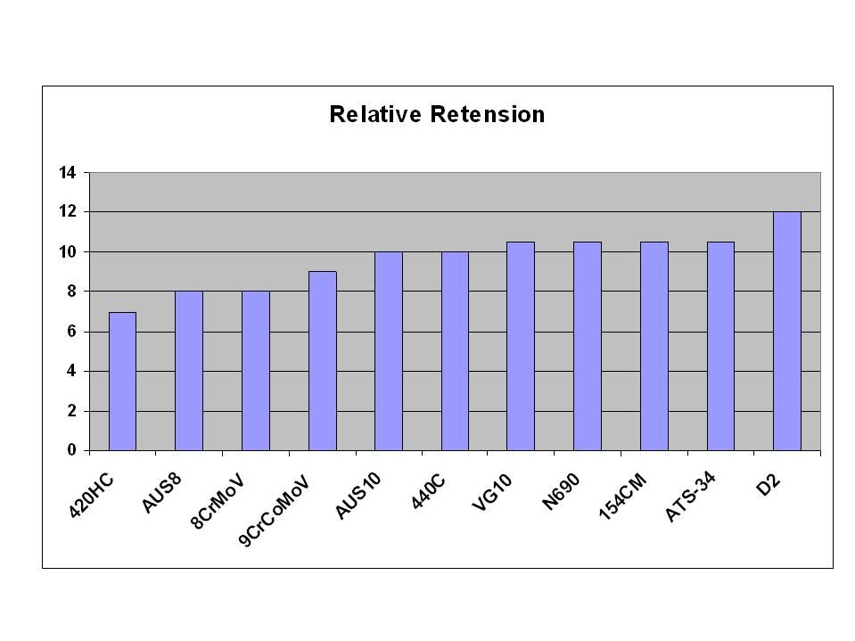

Some time ago I posted a comparison chart showing the relative edge retentions of a number of popular alloys.
http://www.bladeforums.com/forums/showthread.php?t=641279
More recently I compared ZDP-189 to VG10
http://www.bladeforums.com/forums/showthread.php?t=743238
The method I have used in comparing edge retention remains as follows. I measure the Rockwell hardness of each blade. Then I sharpen the blades to be tested at a precise 15° per side until I can not see the edge when magnified under a 3x hand lens. I then make 20 slicing cuts in 3/8” manila rope with each blade. Then I examine the edges for damage under a high intensity light with a 3x hand lens, looking for the edge and for shiny areas. The advantage to this technique is that, once hardness is considered, only the alloy changes. The blade profile is no longer a consideration. (for a further discussion of blade profile and its affect on edge retention, try this thread:
http://www.bladeforums.com/forums/showthread.php?t=730419

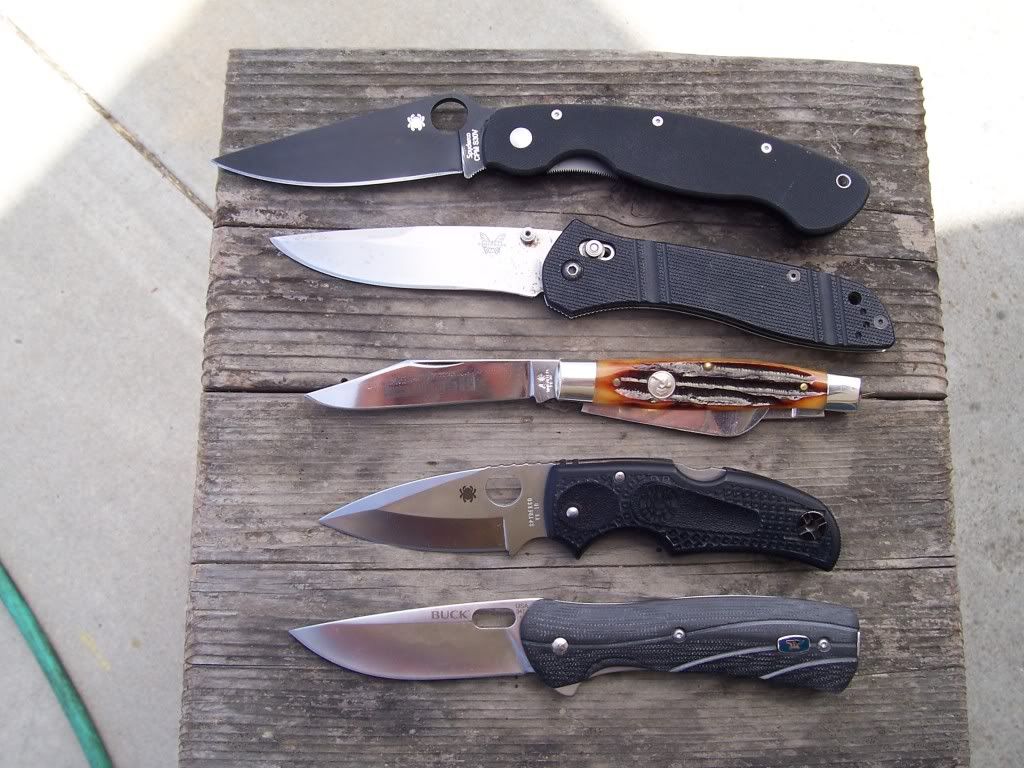

Recently Dennis Strickland loaned me a Benchmade 710 in D2 and a Spyderco Military in S30V. To this I added a Native III in VG10 and a Buck Vantage Pro in S30V. So the lineup for this comparison looks like this:
Alloy_____________________Rockwell
Spyderco Native III VG10______59.2
Spyderco Military S30V________58.3
Benchmade 710 D2___________61.6
Buck Vantage Pro S30V________59.7
Note: Normally you can only measure Rockwell hardnesses ±1 because that is all the calibration standards are good to. So normally one could only say that these are 59±1. except for the D2. However, these were all measured on the same machine, calibrated to the same standard. Therefore, in this case, the differences are valid differences.
To sharpen I used tried several methods. The one that I settled on was to use a Sharpmaker rod at the 15° per side setting to support DMT stones, xtra-coarse, coarse, fine, extra fine . This may have tweaked the results a bit because the recurve of the Benchmade 710 made it impossible to put full blade in contact with the stone. But I did check the edge before each run and I could not see any edge. So I think the comparison is valid.

Here is my modified chart.

You have in the picture of the Queen Stockman in D2
Any stats?
Well, I started to test the Queen as well, but decided that 4 knives to test at one time was about what I could handle. I did one run with it and based on that I think the Queen D2 is less hard than the Benchmade. I cannot measure the Queen because you need a section with flat parallel faces. On the Queen that is only found on the tang. Stockman tangs have to be annealed so you can bend the blades so as to nest together, so I cannot get a valid measurement there. I will probably run a separate comparison of the Queen D2 against the Spyderco VG10 one of these days and see what I can tell from that.
