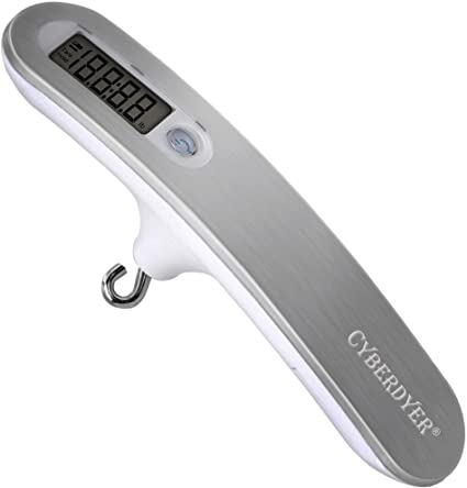

I thought I would share my method of sharpness testing. I created this long before I ever even heard of the BESS so I don’t think I can be accused anything.
I have 1000 feet of three strand Kevlar. I had bought it for a project but I didn’t need most of it so this became my test media. I simply tie it into a little loop about 2 inches in diameter. And I hang it off of an archery scale that has a peak value so I don’t even have to look at the read out. The scale has plenty of accuracy and sampling rate.
I slipped the loop over my knife at a point where I have marked with masking tape to get consistent results. I set the scale to grams. Then I pull up on the archery scale while keeping the knife stationary. It seems like pulling fast or slow does not change the result and I get extremely consistent results with each knife.
I think if I can find a conversion factor I can convert this to BESS data. That is what reading this thread has been helpful for. It seems to be a linear scale based on force so I’m gonna test those razor blades and see what number turns my grams into the accurate BESS number.
This whole set up cost me less than $20 and so I thought I would share it. Even if it’s not compatible with other measures it’s very consistent with itself.

Oh the Kevlar is not expensive. I dare say it’s actually cheaper than fishing line. 1000 foot reel cost me $20. It’s easy to tie into a loop which fishing line is not. This saves me the trouble of having to make a jig to mount the line in.
As far as testing a certain spot along the blade, that would be the same problem that the Edge Up tester has isn’t it? I just usually test a few points along the blade. The middle and a point closer to the tip and one farther toward the choil. So far my results have been consistent all along the blade.
This is the same scale I use for my homemade trigger pull gauge. Those things cost up to $100 and get a far less consistent results than my little homemade set up. I bent a coat hanger wire and put heat shrink wrap on the end. To protect the trigger. This gives me a two for one set up.
The real test will be coming up with the number that converts my razor blade result to a BESS result. The problem is I have to have blades with known BESS results to test that against. I don’t know anyone local with an Edge Up. Is there something you can buy with a known BESS number In addition to a razor blade? Preferably something in the 100 to 300 range?
If the scale is linear then it will be easy. As in (grams of force) multiplied by X equals BESS. But since the BESS number supposedly describes the apex radius in nanometers, the relationship of force to BESS might be on a curve rather than linear and the result might require a more complicated equation.
Isn’t somebody here using an Arduino? I would think they would know the math needed to convert grams of force into the BESS number.

I think I answered your question in my previous post. It depends if the relationship of force to the BESS result is linear or on a curve. It’s still math and it’s obviously what the Edge Up scale does. It converts weight, which is just another way of saying the force of the cutting blade, into a BESS number using a known test medium. It’s just a matter of finding out what the equation is, and then adjusting it for whatever test medium you happen to be using.
Anyone with a scale and a piece of string and figure out the force required to cut something with a given blade. But you need either blades of a known BESS number to calculate a conversion, or you need to know the mathematical relationship between applied cutting force and BESS.
The Edge on up BESS number is actually already grams of force, based on cutting approximately a 0.2mm fluorocarbon fishing line.
If you get yourself some 0.2 fluorocarbon line, that could be your direct comparison.
