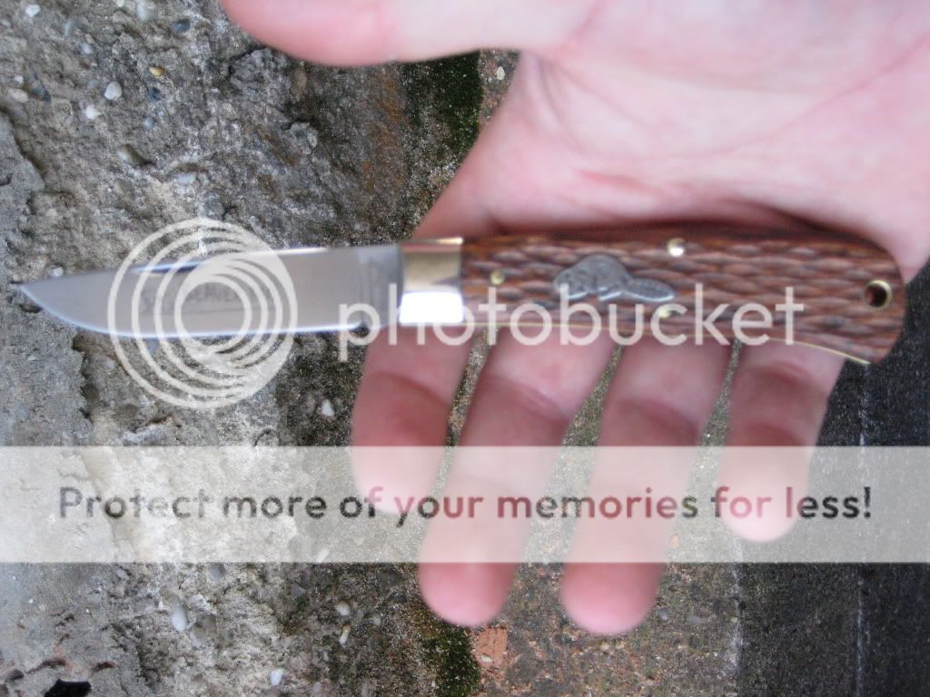

I also have a nice single bladed GEC. A #73 Beaver Tail
Here´s an inhand pic, maybe this can help a little.
I really like the slim design. It fits really great in the backpocket of a jeans. I´m really happy with this one. I think I gonna get another #73 soon :)

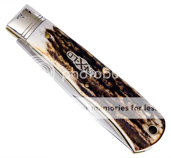

The GEC 73 single blade is probably my favorite all around knife. You can get them in a variety of materials. Some materials such as stag and primitive bone will add width to the handle and can have unique contours. I have quite a few of the 73's as I really caught the bug for them. If you are looking for a slim and sleek knife a nice bone version will be very classy and still be strong. Some of the burnt stags can be very slim as well, but this is something you have to look at on a knife to knife basis. I have a genuine stag that fits my hand like a glove but after a while I got tired of the extra thickness taking up space in my pocket. What I found is a burnt stag I had laying around in the tube (and pictured above) is just perfectly in between the slim and thick handle widths. I have yet to use it because I have been putting my 85 single blade through it's paces. With that said, the 73 is a more versatile knife than the 85's IMO.
With the 73 you get a flush tang to the bolsters when closed. This leaves no area for lint or dirt to build up and compromise the action and eventually the pivot. It is a very easy knife to keep clean with the only area needing a pipe cleaner being the well. You get just about the best blade grind geometry I have seen on a sturdy knife of the size. They get sharp and work hard. The blade to handle length ratio is also one of the best and compares to most customs. The newer ones with the lanyard holes have an easier and smoother pull but still have decent snap and strength.
Overall I don't think GEC makes a better single blade knife. I am very partial to slipjoints over lockers so I pick these over the 72's every time. When it comes down to it if you get one with a strong handle material that is well put together the 73 is a knife that should last a lifetime and have a little class at the same time.

I lean more towards the #72s myself, but day-yam, that's some killer schtag right there. It wouldn't be out of place on a custom.
Thanks Rick. I was pleasantly surprised when I opened the tube and first laid eyes on this knife. Not bad considering I bought it sight unseen.
