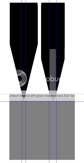

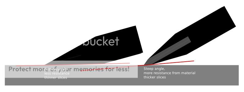

What I wanted to express was just that when there is less resistance (acuter edge), it cuts better. Kind of same like when you sink into snow where wide pawed snow leopard doesnt.. :rolleyes:
I guess it could be explained with physics but Im not really good in terminology, especially in english.
Here some drawings I made:

Good drawings. Put a straight edge to work. In both illustrations, a full flat grind would produce a more acute edge than is physically possible with a "Scandi" grind. A hollow grind would produce an even more acute edge -- with the wedging resulting when cutting thick enough material.
Depends if it really is full flat grind. Usually full flat grinds have a secondary bevel that takes down the whole idea of full flat.

And a "Scandi" grind typically includes a secondary bevel as the knife comes from the factory. Everything depends.

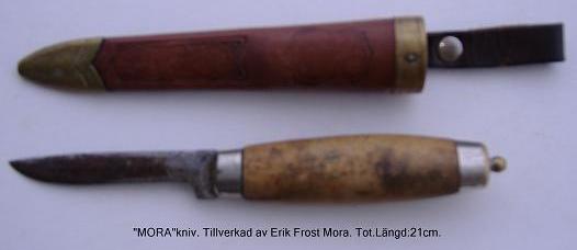

About traditional Scandinavian knives .
Don´t really matter if the knife is a beater , or a one of a kind masterpiece ,
they´ll probably have a "Scandi grind" edge ,
Some will keep the original edge profile , others will not , it´s about personal
preference
In essence , most Scandinavian knives comes with a basic grind , then it´s up to you .
You may do whatever you want with it , the knife-maker has done their bit .
Sooner or later most look like this anyway ! :D
http://www.cultur.nu/knivar/mora/morakniv120kr.jpg
