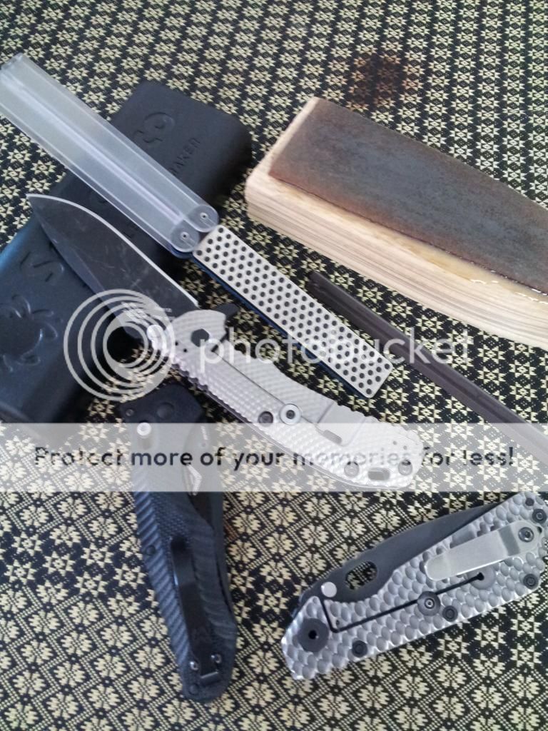

From my pic it look much worse IRL and took me to 2 hour to sharpen the chipping out with DMT Extra course diamond.
I'm not sure what you talking about but from my experience with 3 knife from ZT one from Microtech and another one from Lionsteel, I wouldn't considered Elmax a tough steel by any mean.
Interesting, it took me less than an hour to put bevels on an A11 blade at 62.5 that was .015" thick with a 320 grit SIC stone, yeah the blade didn't have any edge bevel on it all all when I got it, it was .020" behind the edge when I was finished.
Would have taken a lot less time with my 120 SIC, but I wanted to see how long it would take me.
So I am not sure how it took 2 hours to remove some minor chips out of ELMAX, I could have ground the whole blade away in that amount of time.
I don't have sharpening jig then I have to do it free hand.
Could have done the same with my Norton SIC Stones FREEHAND, have a Fine, Med and Coarse that I use.
Would have taken maybe 10 mins max, not 2 hours....
