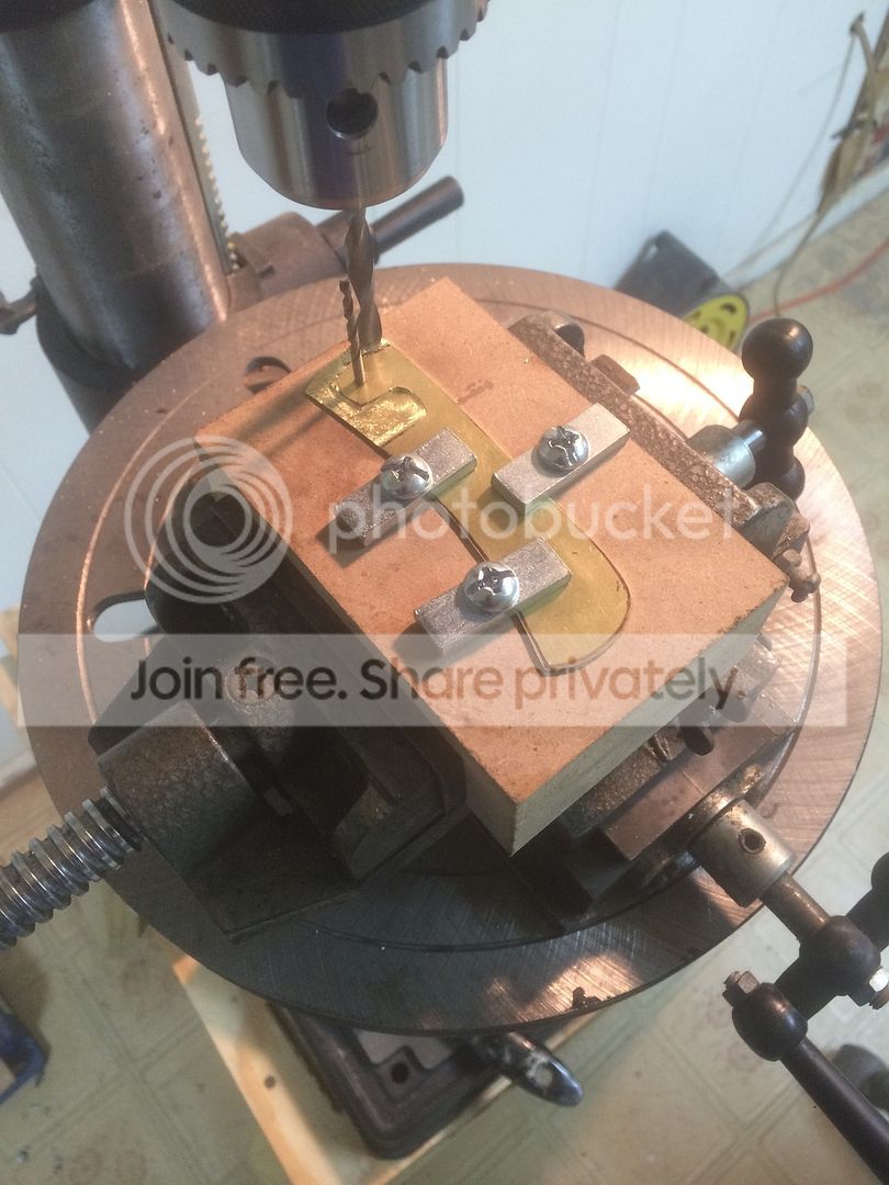

Ok I have been trying everyway under the sun to relieve brass liners without a mill.
Now it can be done but does not look very clean.
So the idea now is to use an end mill bit in the drill press.
I know sideways movement is not the way to go, so I am thinking of just plunges into the liner.
I'm sure it will take some time but it my last hope for a cleaner look.
I'm going to pick up a cheap HSS mill but this evening and just give it a try before spending bigger money on real good end mill bits.
Question is two flute vs three flute
What do you recommend?
I've never machined anything
And has anyone tried this already ?
I'm sure it will but got a jig to hold it.
I do understand the danger, I plan on taking very very little off at a time.

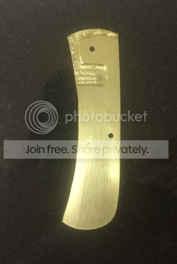

Well it worked!
Just got to learn to use the knobby thingies at the same time to make a nice radius.
It was only one pass, trying to get my machine set up to take .0025 was impossible.
I fed it super super slow had everything bolted down solid.
Glued two pieces of 3/4" MDF together at work today and set up the jig to hold liners.
Probably took two hours.
I might have been able to go faster but was not going to ruin my drill press or bit.

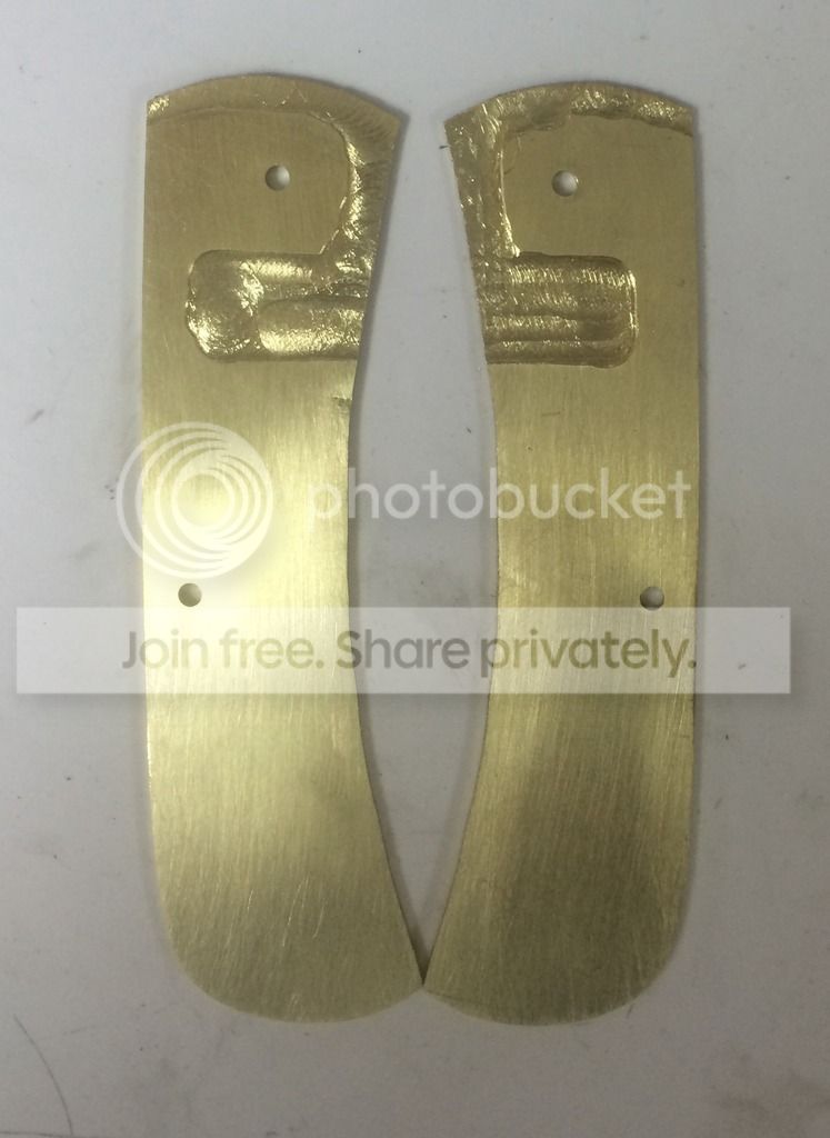

Got the second one done in half the time...
Getting the radius a little better.
Nathan I'm running at 220 rpm and feeding very slowly using a 1/4" HSS spiral cut bit.
To improve performance and less wobble what type end mill would you recommend ?

That finish is appalling, I suspect that cutter is beat up. A sharp new cutter that isn't so much longer than it needs to be would help. I'd use a 3/8" 4 flute carbide, and spin it faster, but the specific cutter you use isn't all at important.
Remember not to climb mill in this setup.
I do agree the finish should and can be better with the right end mill.
Just knowing now that this can be done, I can now buy a good end mill with no worries of it just setting.
I had to google climb milling to understand what your talking about.
And I'm sure I did, so will now try not to.
