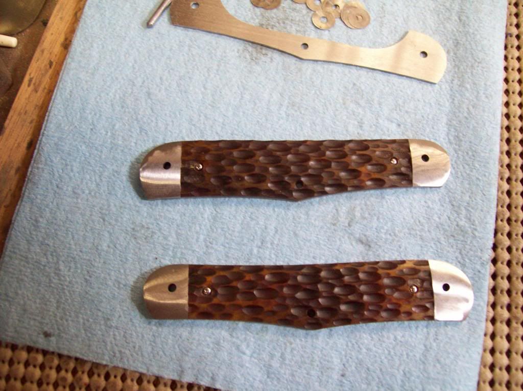

Beautiful work... Your stuff is always impeccable. Do you have a shot of the top with blade open? I'm thinking the spring has to be thicker than the blade.... am I correct Enrique?
You are correct the about the spring being thicker than the blade. The washers are .004" think so there is a gap that size on each side. If you take the bolsters real close to the end of the spring it does not show bad at all plus it makes the knife shorter. I do not like to see a knife with a real long bolster out to the frot. I think that in that case just make the blade longer. I have always relived my liners all the way to the top to meet with the end of the spring so this is common for me to see in my knives. I do not have a picture of what you want to see since this knife has been shipped but will get one when I can.

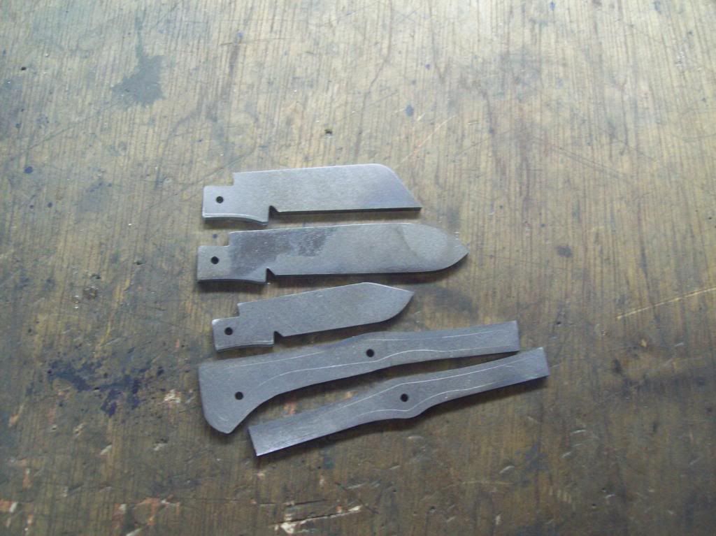

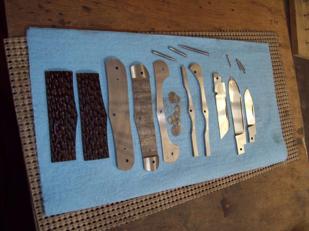

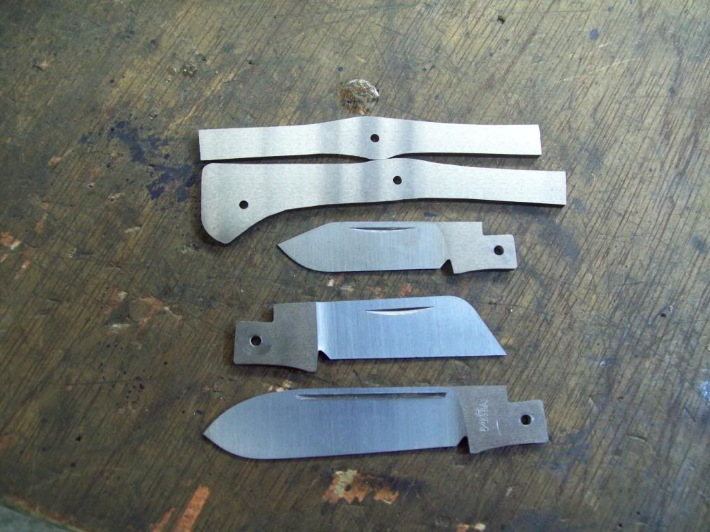

Here is the first photo of the knife build. Here are the basic parts just profiled to shape.
Here are the parts now surface ground. The springs are .008'' thicker than the blades as this knife will be having no blade relives and have washers.

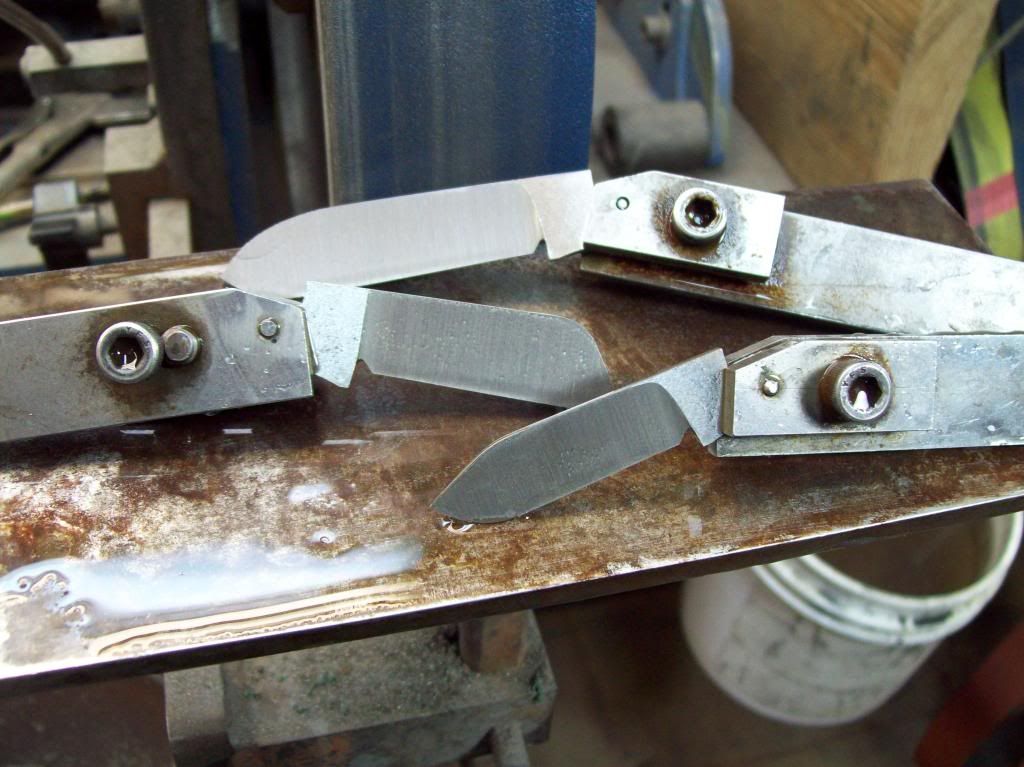

Now we have the blades ground. I rough grind them using 120 Northern Blaze belts and then I jump to a Hermes J Flex 220 and leave the cutting edge at about .035'' thinck.
Here I'm cutting the long nail pull with a slitting saw. This is a slow process to keep your saw cutting good and make a nice clean cut.
Now I'm cutting the cresent style nail nick using a fly cutter at low rpm and using cutting oil. This is also a slow process but worth the wait to get a nice clean nail nick.

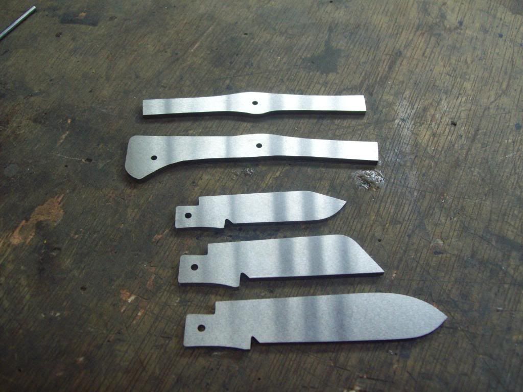

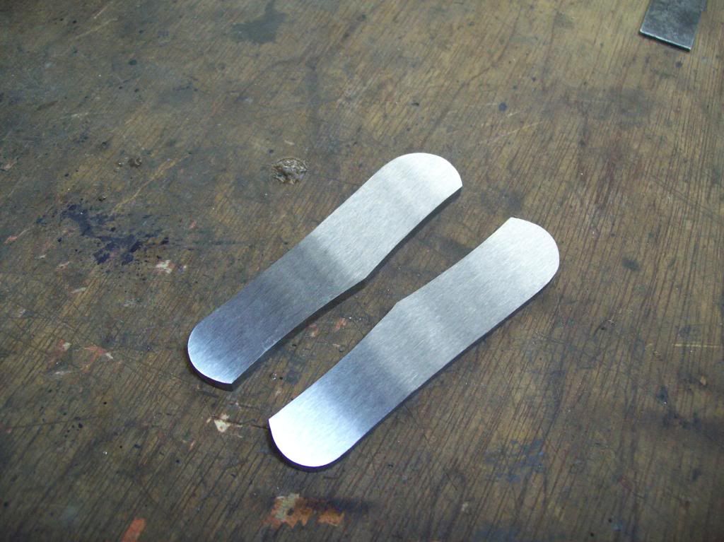

Now we have the liners cut out and surfaced ground ready to be machined. They are made out of 410 stainless steel in 3/16'' stock.

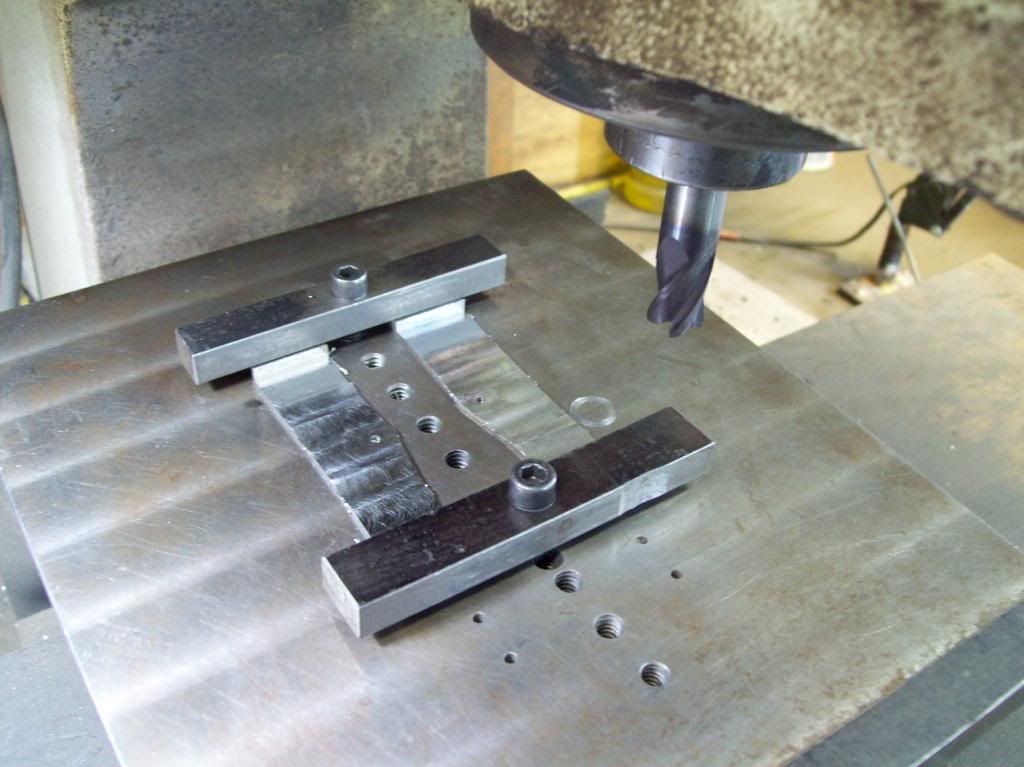

Here I'm maching the handle material pocket on the liners.

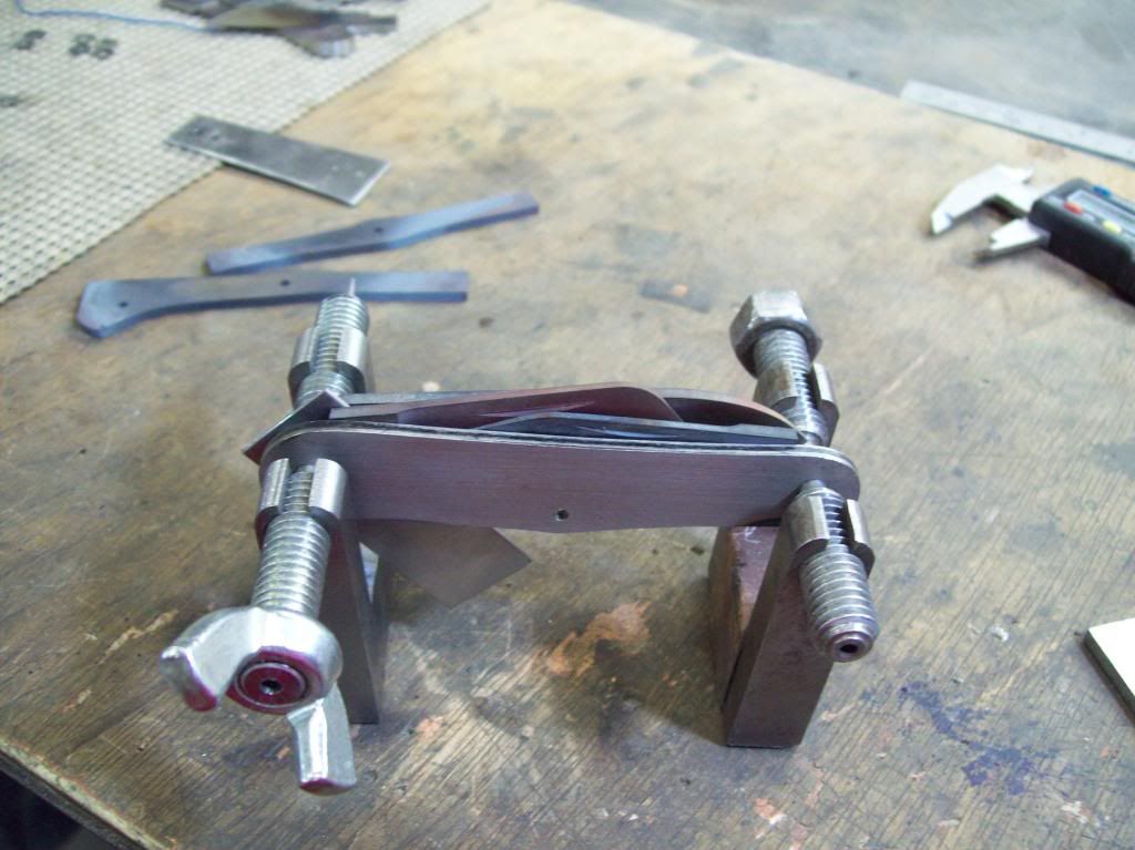

The parts are now harden and can still be moved some so now is the time to check for propper blade clerance. Here I have them claped to a harden template of the handle that is surface ground and flat to check for clerance between the blades. After checking ok they are ready for the tempering cycle.
Here are all of the parts after some labor intensive massaging of the parts and they have now started to work against each other in harmony.

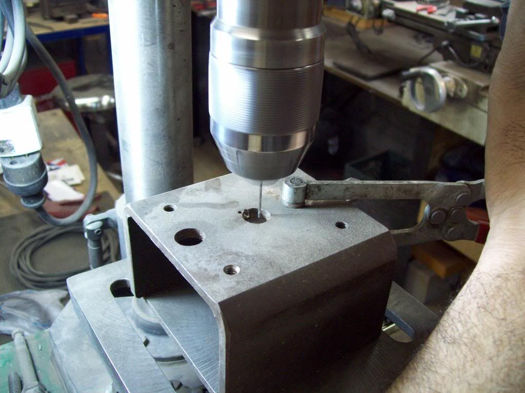

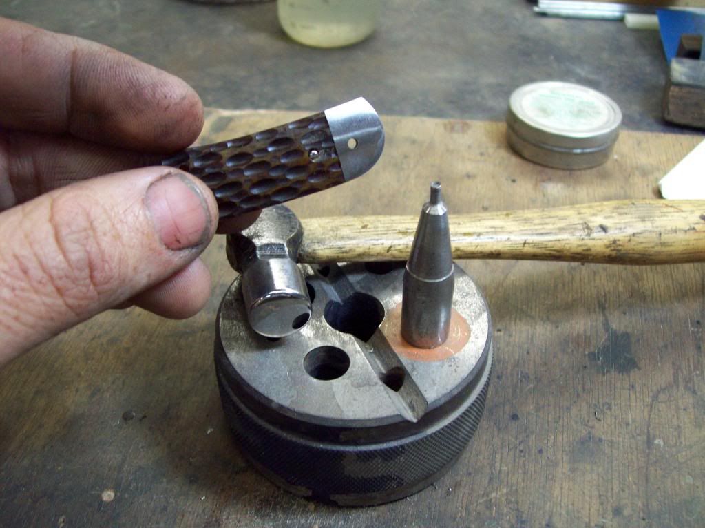

Now a picture of me back drilling the handle material.
Here is the basic setup that I use to pin the handle pins. I use domed head stainless steel nails that I polished before pinning them. This is something that Tony Bose shared with me.

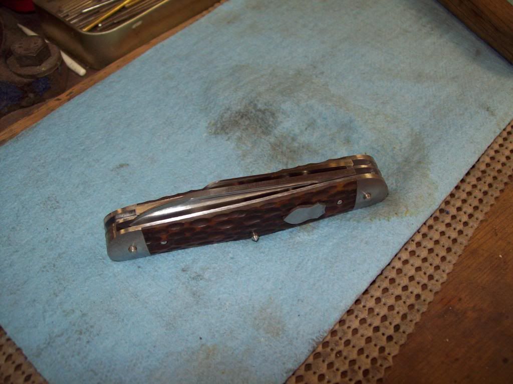

Finally we have the knife put togher for the last time and ready to be pinned.

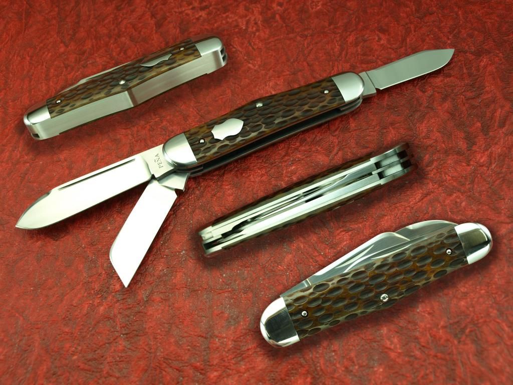

And now the finished knife.

Well, now I can post that I am the proud owner of this wonderful cattle knife as it just arrived safe and sound at my home.
Thank you, Enrique, for building this beautiful knife for me. Despite your excellent photography, the knife far exceeds what is depicted...and that is yet exceeded by the precision of the build and the quality of the action.
At 3 1/8 ounces it is just right for its class.
I now am fortunate enough to own five of Ernique's knives, all of them excellent. This one, however, marks in my mind his transition into that rare territory occupied by only the very best makers of slipjoint knives. My congratulations and thanks.
