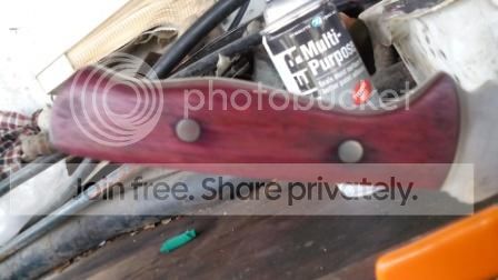

Well I shaped the handles today and they didn't pop off yet so that's a good sign. I like the stainless steel look.Maybe I will try aluminium next. Should be easy to peen.
I use T88 epoxy, bridge holes, pins, and only use spring clamps. If the mating surfaces are not flat don't try to force them flat with clamp pressure, this is just a recipe for disaster, get everything flat, then all you need is a spring clamp.
yes I noticed one of the slabs was bowing out a bit.So If it pops off from there I will just fill with epoxy and hope it fills the gap
Looking good, but you're burning the wood by overheating the pins as you're grinding and shaping the handle scales. That alone can compromise your epoxy. About the only thing that will consistently get ANY adhesive to fail is heat.
Yes tge steel pins caused burning but i wad going to leave the burn marks. I actually considered burning a few more spots for looks
Ha!! Creative fix for a problem!! Nice!!!!
I'd be interested to see how it turns out, if you do.
Learning not to get the pins hot is a tricky one, when you're first starting. Everyone does it. Sharp belts and patience are the key.
