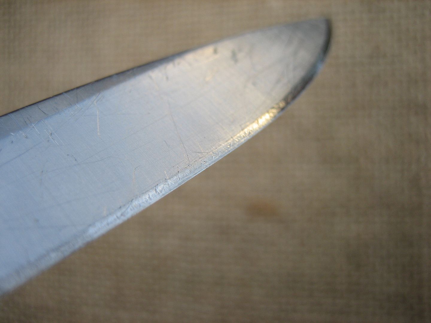

Well my initial impressions after using the ERU for a couple of weeks are it is very well built,I would have no problem chunking it anywhere in a pack or tacklebox. It's design especially with the robust sheath makes it seem pretty indistructable. It would require no "special placement" or packing in your gear, just throw it in as is. That in itself makes it very desirable. Now as for the using of it as Fred states it is not the "end all" sharpener, it will not replace your sharpening stones. When I used it my biggest fear is that would work the same as the carbide steel sharpeners. The traditional carbide sharpeners seem to sharpen a blade by beating it into submission with the ripping off of the old edge, not Fred's though. The ERU feels as though you are smoothly refining your edge between two high quality sharpening steels. I would love to have this with me while skinning or fileting. Initially I had the same impression about the belt clip being unnecessary or that it should be removable. This opinion changed after a few uses for me. I liked that it naturally kept your fingers in a safe position. Although, it would be nice if it had the previously mentioned "cut outs" and a removable clip!!!
Jared
ERU Review
1) Initial impressions – Well built from sturdy materials. Good looking sheath. Simple construction.
2) Instructions – Clear and easily understood.
3) Operation – It took a little while to get used to centering the knife, but a few minutes later the process was simple. The sharpie marks method of aligning the blade works very well. The knife I sharpened first had a much steeper bevel than I estimated, but about four adjustments later, I had a perfect match.
Opinions:
Positive – I liked the look and portability. I could easily see a hunter clipping this on his belt or tossing it in a camping pack.
I really liked the ability to match the tool to “my” edge angle…not the two or three some factory thinks I should be using.
Operation was just as described. It won’t shape a bad edge, but will bring a previous good edge back quickly. The edge produced is “rough” or “toothy” in the way that makes a good general use cutter. I had no problem slicing meat and tomatoes after touching up a dull kitchen knife. It won’t replace a good bench stone, but will touch up a blade for cutting chores quickly and efficiently.
Negative – The one thing that really is a concern is the need to place the fingers directly below the blade. Placing the ERU in a vise with padded jaws solved that problem, but unless you conveniently have a vise in your kitchen or backpack, I think most use will be hand held. If I used this a lot in a hand held position, I can easily see cutting my thumb eventually.
The top of the carbide plates is sharp. They catch and scratch if sticking up when in the sheath. When placed in the sheath, placing it in with the carbide downward is a good idea.
