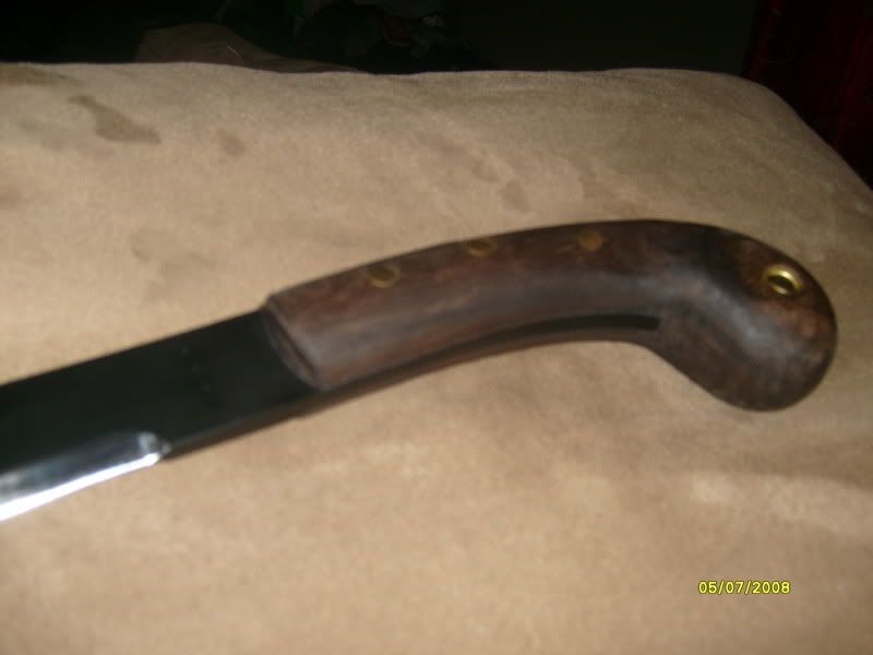

Again this is just my opinion and experience... I'm thinking of an axe handle or machete when I picture the larger heel and of a carving knife when I picture the top of the handle being larger.
Like this: (Landi Kinzua?)

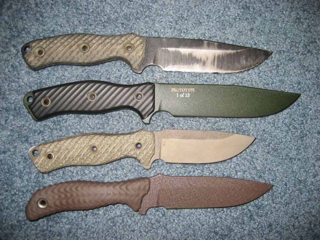

Just thinking out loud here, but I also took some measurements and pics for you guys... just something "quick and dirty" but I think it shows some of the differences well:
I think it really helps to see the 162's scales (or any for that matter) next another knife that's more familiar.
From the top:
Ontario SK5
Bark River Knives Bravo 1
Blind Horse Knives Bushcrafter
Benchmade Bushcrafter 162
TOPS B.O.B
Becker BK15
The thin-ness at the top of the BK15 drives me crazy and I feel like I'm trying to make a tight fist to hold it... I'd use this knife for cutting rope or anything I'd just need some power for. The handle on the BOB is great and I like the length of it, like I mentioned before the SK5's scales are "wrong" from first glance... no palm swell, block and straight but once I handled it I think it's great and it just "works". Somebody mentioned the "works" part in a review and it just stuck with me when describing the scales.

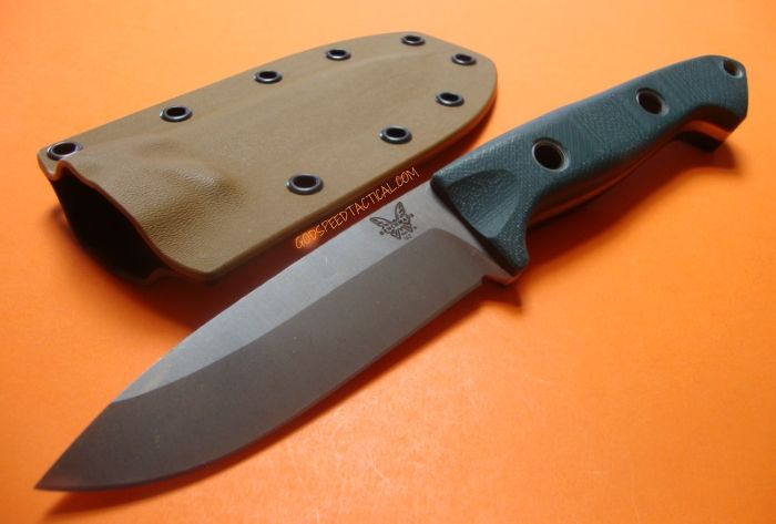

Benchmade Bushcrafter:

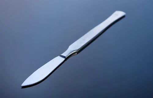

For fine controlled cutting, you should be using much LESS power, and that doesn't require a thick handle for support. For heavy chopping you need more power (and a thicker handle to provide the support) but that also translates to less control of the cut. More power also translates to higher rate of fatigue.
The BM162 tapers at the guard and even provides the thumb-grooves for pinch-grip like the TOPS BOB (unnecessary, but whatever), BUT it is SO fat immediately behind the taper that pinching there makes little sense. You will instead pinch the blade itself to give you the wide flat surface to control the cut, but meanwhile your middle-finger rests under the guard while trying to grip the poorly located golf-ball-like handle-swell which is useless in contributing leverage to twist/turn the blade.
