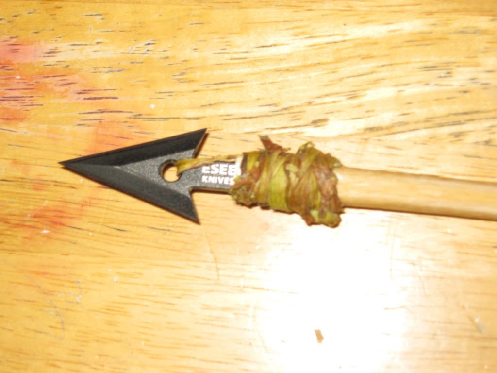

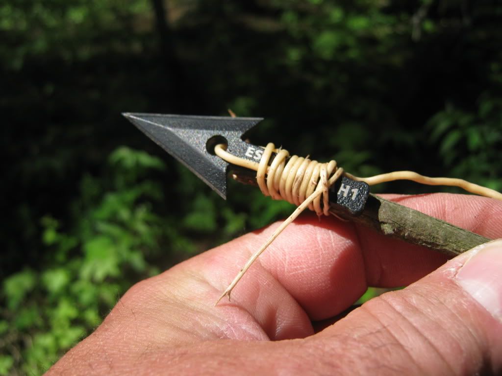

Mike, dental floss or braided fishing line would be better for balance without losing significant strength.
pitch glue is pretty simple if you have the ingredients and something to melt it in - it's just melted pine pitch with some wood ash and a pinch of ground calcium carbonate (catalyst - helps it set better rather than stay sticky) which comes from sea shell, snail shell, or egg shell. (ground limestone also works, but not as well as the organic sources)
