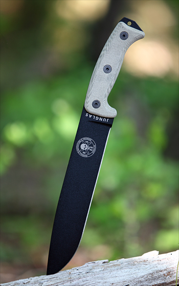

I got a chance to use a Junglas a couple weeks ago.
For the price, it is a really good knife.
The handle is one of the best I've ever used. it is better than many similar knives that cost much more.
The sheath is also better than many others I've used, plus, you can reverse it to right or left handed.
Overall, I'd give the Junglas a BIG :thumbup:.

I would like to buy a Busse Bushwacker Mistress. I personally held the ESEE Junglas and I loved it. The handles felt awesome, as somebody previously mentioned. The weight of the knife felt good, well balanced.
I have not held the Busse Bushwacker Mistress. I would hate spend $400 on something that I've never personally held. What if I don't like the weight or handle?

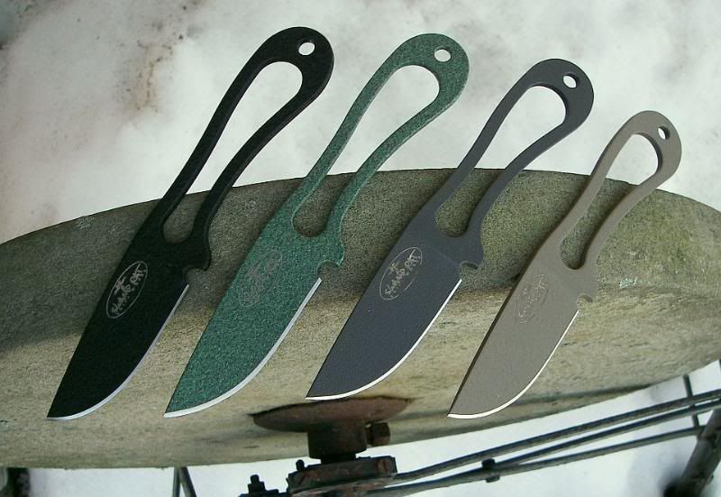

please allow me to add some more confusion to your thoughts since you are considering Izula.

Here are the stats for the Junglas :
O.A Length: 16.5"
O.A. Handle Length: 5.88"
Maximum thickness: 3/16"
Weight: 22.5 ounces (Knife Only)
Weight: 33 ounces (Knife and Sheath)
High Sabre Blade Grind
Hammer Pommel
Canvas Micarta Handles
Black Textured Powder Coat Finish
1095 Steel
Serial Number On Pommel
Standard Equipment: Kydex Sheath w/ Cordura Backing
swamp warden
Hehe, no confusion there I'm afraid as I already ordered it 3 days ago. But these look sweet too! What I love about the Izula is it comes with a no nonsense survival package and nice sheath. For the price its hard to beat.
Also another point for the the Junglas is the handle uses screws. Changing or modding the handles seems easy. On the Busse I would have no idea how to do it...
Well I got one of those wardens for $50 slightly used, so I don't think I walked away with a bad deal. But I hear nothing but good stuff about Izula.

They are similar in dimensions I have both of them sitting here on top of a tupperwar box next to me. That said, the Junglas comes with an excellent (I do mean excellent) kydex sheath. The Busse BWBM didn't but the Scrapyard sheath for the Dog Father is a perfect match for $20.
My Junglas is #22 and I got it pre-ordered for about $15 less than I see them going for now. Maybe the dealers jumped the price up $10 -15, not a dealbreaker.
The Junglas came sharper than the Bushwacker "Battle Mistress" ....BWBM...;) The Infi holds a better edge and longer retention than the Junglas after being touched up. Busse doesn't ship them hair popping sharp for safety reasons....the claim is anyway.
In hand there's no comparison, the Junglas delivers for it's price point - big time - but it's handle heavy and warm in your hand (heavy canvas micarta). The Busse is blade heavier and feels cool (literally) in hand. I have a G-10 handle. It's also much roomier than the Junglas which kind of locks your hand in place if you have big mitts.
