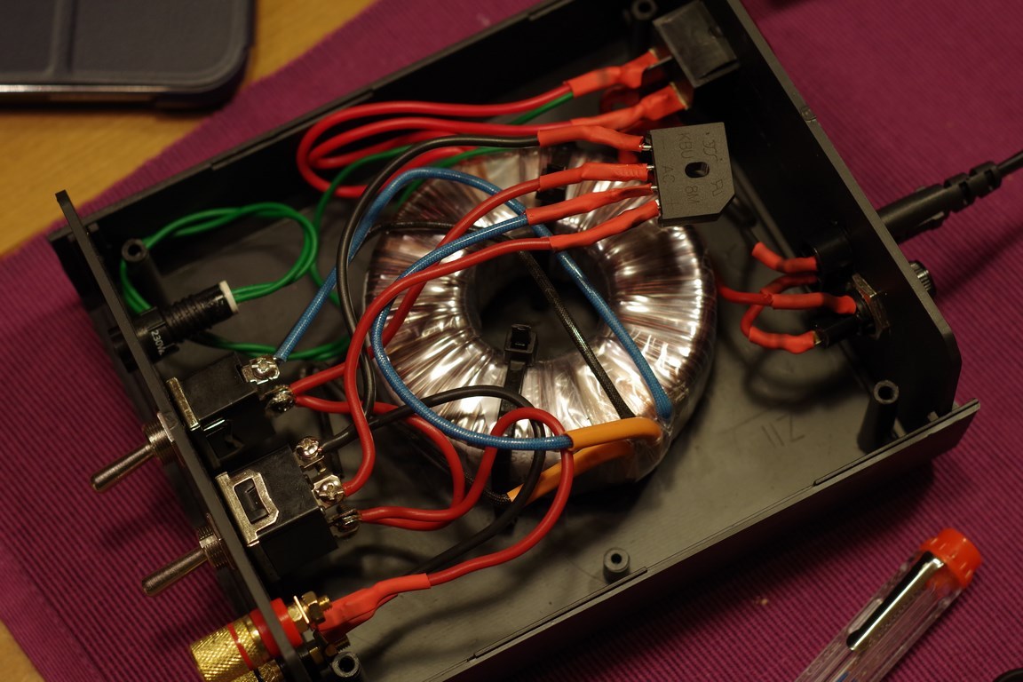

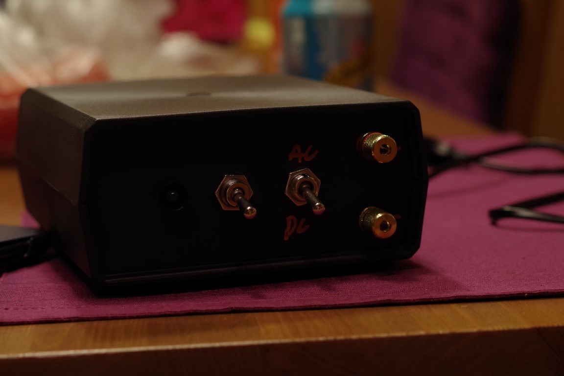

If you are electrically apt, you can build a very good etcher yourself. If not, buy a full power unit. You need 0-24VDC and AC output and enough current to get a good etch. You want large enough a carbon block and felt pads. Wire connections need to be with proper banana plugs. A meter is needed for voltage readout. Lights are needed for AC/DC and ON/OFF. A foot switch to start/stop the etch is a great add on.

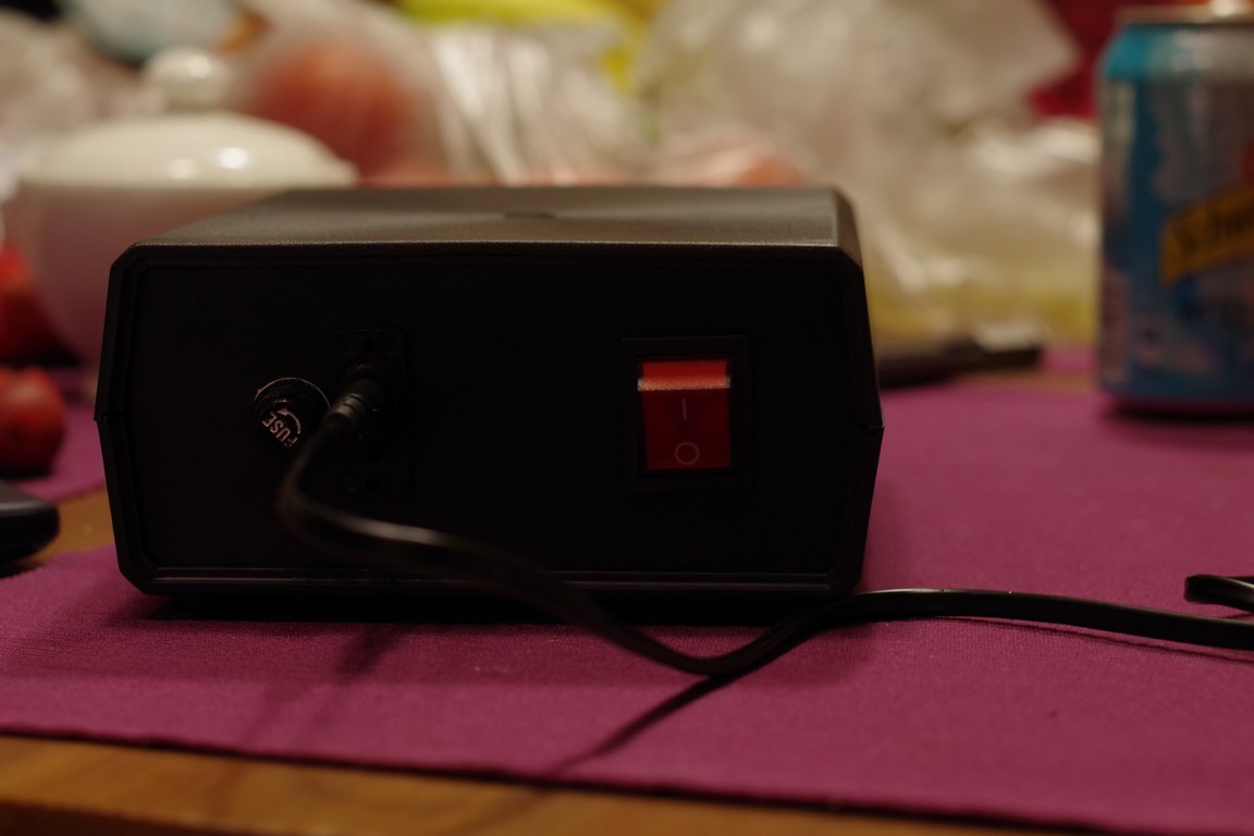

Kosa: Very nice and clean etcher you built there. I'd like to see a capacitor added to smooth out the DC output. As you have it now, your DC turns on and off at 50Hz. A small capacitor would make it constant DC.
