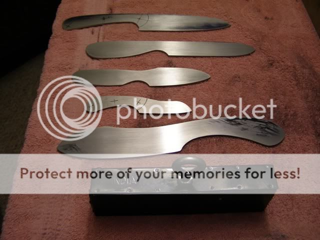

Thanks, here's a horrible pic of some stuff in the works, including the Kephart and Nessmuk.

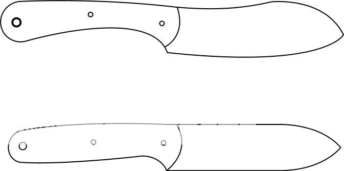

Here's a better pic of the top one:
I like the weird, almost inverted drop point that I have going on; but, I'm listening. Eventually, I want to sell what I make, and can only sell what others will buy. I really do appreciate all the feedback.

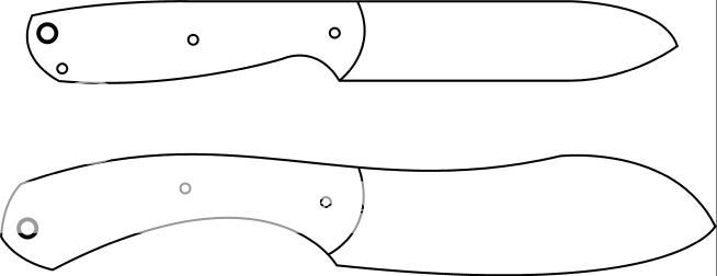

Here's the updated Nessmuk and Kephart designs:
I flattened the curve of the handle on the Nessmuk, rounded the butt more, and moved the lanyard hole in.
The Kephart, I increased the height to 1.25", the handle is 4.7", the blade is 4.3". I added a slight swell to the top of the tang, elongated and reduced the height of the index finger cutout. The curve of the butt is asymmetrical; I wanted a more gentle curve at the top of the butt for palming the but of the knife.

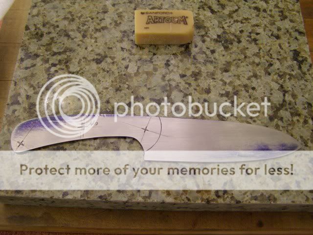

Sometimes designs have great lines and look great on paper and then when you cut them out just don't feel right. It's very important to go through this step and re-evaluate.
I applaud you for doing it.

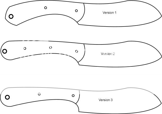

Here's the evolution so far:
Daniel, the third version is starting to look like one of yours. I'm not trying to reinvent the wheel; but, I don't want to copy others' designs.
