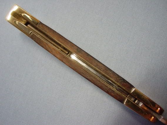

So I am going to start with one of the pics I put up earlier and go from there.
In this one look at the old ones right at where the handles meet the bolsters.
And then down along the edges of the right hand knife. Can see the adhesive.

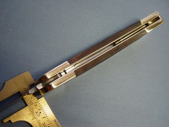

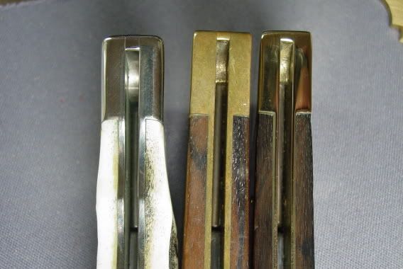

Believe me when I say, that isn't visible with just a casual look at either of them. This high res camera does bring out things that may not otherwise be noticed. So here are some more pics that you may find interesting.

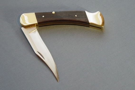

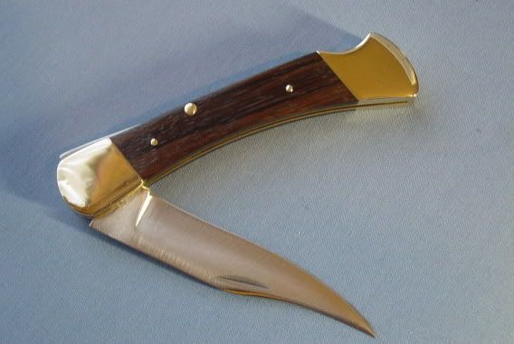

ok, ok, I am showing off, or not, a 3rd version, minty? This and the rest, is the knife on the right.
Might give you an idea of what I am seeing... and it is on both of those old ones. First time I ever noticed.....
