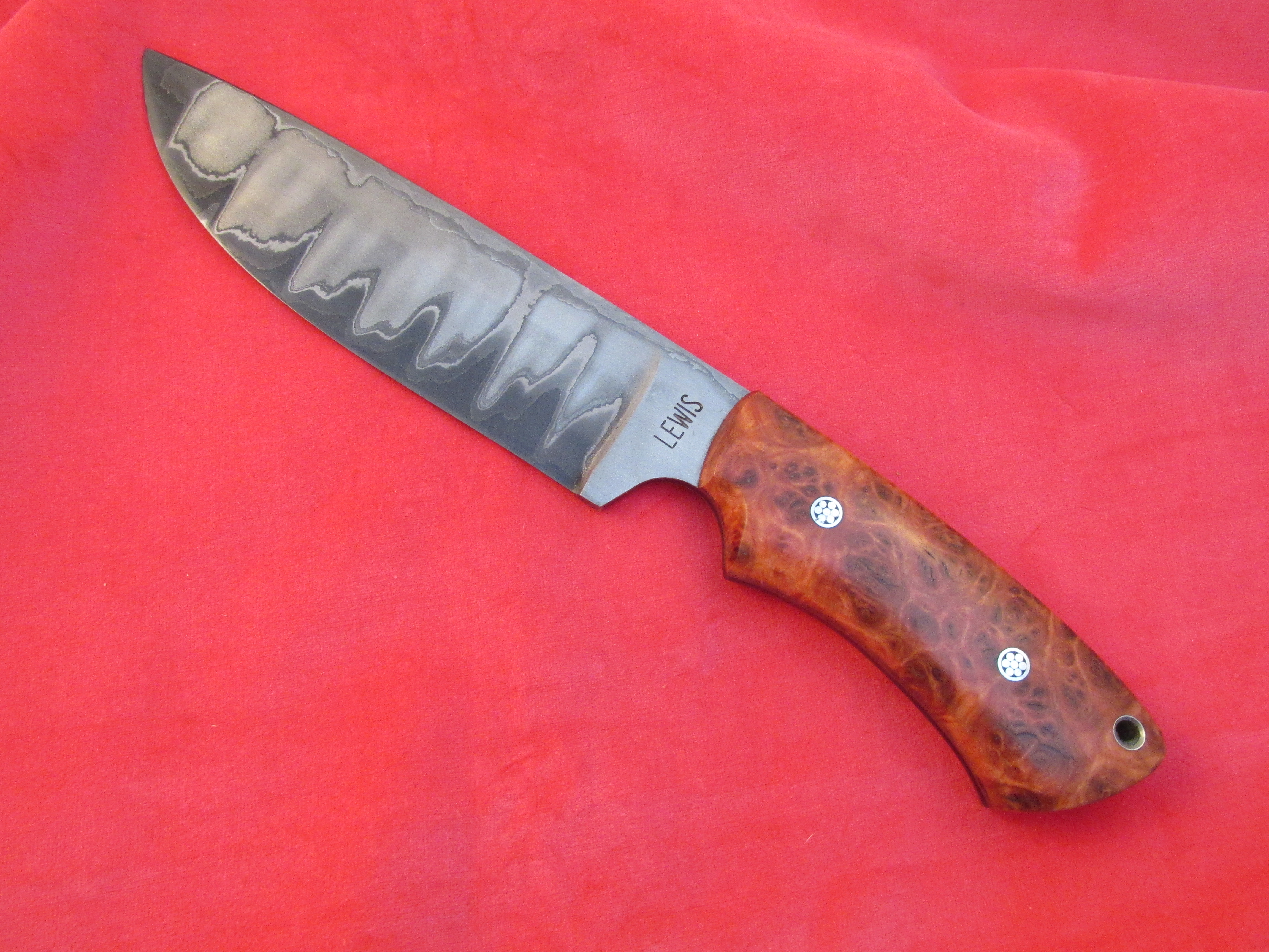

My method is to sand to 1000 grit, then dip in 3-1 FeCl for 30 seconds. Neutralize with Windex and baking soda. That's it.
Oh by the way I'm using 15n20 with a 1084 core.

That's an awesome looking knife Tom.
