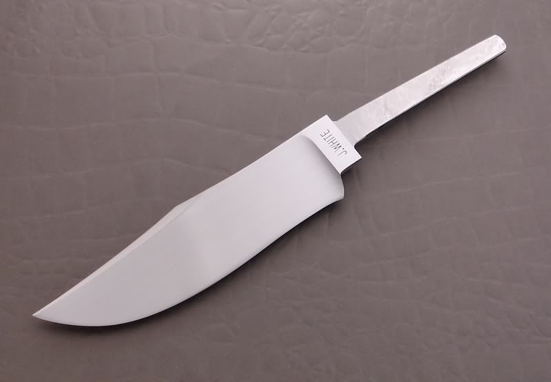

Photo #2: Blade ground, sanded to 1200 grit.

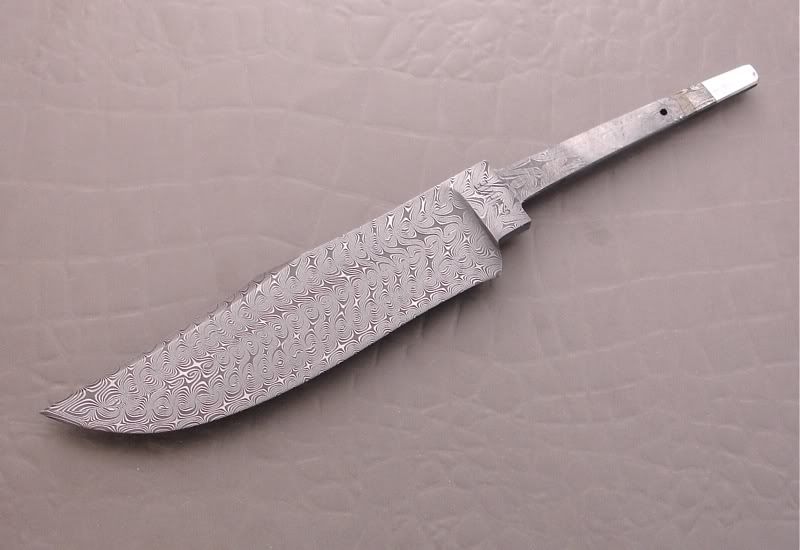

Photo #3: Blade etched. So that's what it looks like inside there!

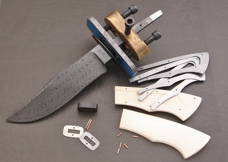

Photo #4: Lots of pieces here. Guard installed.

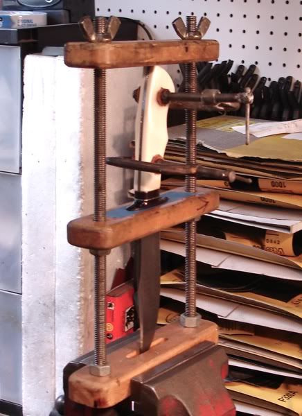

Photo #5: Final assembly and glue-up.

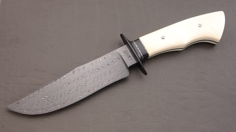

Photo #6: 6 inch, four-bar Turkish Twist Damascus blade, rust browned Damascus flared "S" guard and collar, file-worked S/S spacers and 3-piece frame, Pre-Ban Ivory scales, faceted S/S pins.

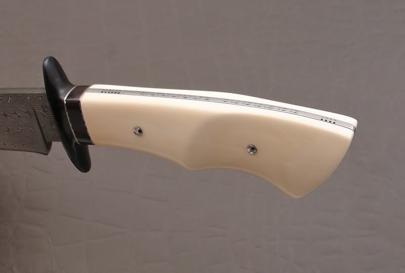

Photo #7: Shaped handle scales.

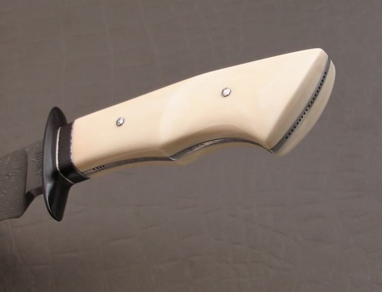

Photo #8: Another view.
The client's wishes moved from hunter to fighter as we exchanged drawings, and focused on color, texture, and purpose.
We think we wound up with an Exquisite Assassin.

I may run out to the shop right now and build the jigs in your pictures!. Thanks for posting those!
Just a fantastic piece John. So many tremendous details, but the rust-browned guard really makes it for me. Congrats to the happy new owner.

Geez.. that is some nice John. I would've had a heart attack peining the pins on those scales. :p
Exquisite is most definitely the word to describe that knife. The file work on the butt of the frame is a great touch.
That is really nice John I like everything about this knife but you had me with the dark guard and domed pins.

John, this is a stunning and beautiful knife. The dark fittings against the creamy ivory dress it up to black tie worthy. And I love how the Damascus pattern follows the profile. You're amazing...
Wow John. Spectacular. Again. The forged blade profile and the way the damascus pattern follows the recurve edge is just brilliant
