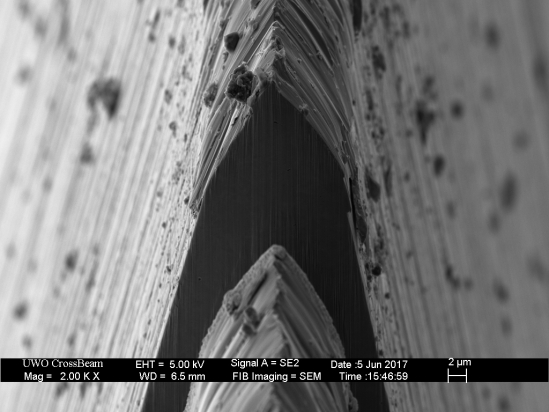

The following 2 SEM images taken by Todd are of the same carbon blade steeled with a grooved (ribbed) steel as compared to "steeled" with ceramic rod
Grooved steeling
Ceramic rod steeling
Though they look quite similar, showing an improved apex and micro-bevel, the traditional steel does it cleaner, while the ceramic rod creates scuffing on both sides of the edge - and where the presentation cut is important, traditional steel is preferred.
