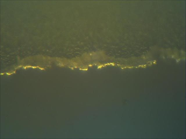

Making reasonable pictures with an USB-Microscope takes quite a bit of practice, so that's what i'm doing at the moment.
The idea for this thread is to show some pictures of untouched factory edges from various brands, so feel free to contribute if you have some as well.
This is the first one, a factory edge with a buffed apex on a Spyderco Paramilitary 2 in CPM-S110V steel and a measured edge angle of 30 degrees inclusive:

Is that really a microbevel though? I think of a microbevel more as, for example, "sharpened at 15° with a 20° microbevel"... vs. a lot of factory knives that seem to be sharpened at X°, but then buffed at a fairly steep angle to remove the burr... and mainly on just one side, so the two sides won't look the same. Not exactly the same thing IMO. (Also what causes people issues when they go to resharpen a 'factory' edge).

That's what it looks like to me as well. Can see some definite rounding just behind the apex of the 'microbevel', which is what I'd expect to see on an edge buffed as such. Also looks quite a lot like the original factory edge on my Spyderco Manix2 in S90V.
That minor distinction aside, these are good images nevertheless. :thumbup:

I just checked the other side of the bevel (the side i didn't take pics of because of the clip giving difficulties with focussing) with my Victorinox loupe and it looks indeed a bit different.
Will recheck with the USB-microscope tomorrow, but what i think i see is an incomplete more narrow "white line": some parts in between seem to be without, but there is also a piece of burr remnant just in front of the heel.
It's of course a buffed apex, must have been tired while choosing the words.
