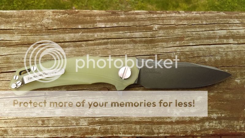

I discovered that the liner lock on my knife can fail rather easily with some pressure one the spine of the blade to the point that I can make the lock fail with my hands, far from a wack or baton. The lock simply slides to the side and allows the blade to close. I feel unsafe using the knife now knowing how easy this can occur.
I'm simply spreading the word for those that have one to check it. I suspect it's a defect as it seems to be fairly well liked and I kind of liked it before realizing that the lock was faulty.
I've attempted to contact stedemon about the knife. I know it's manufactured by Zon Knife Co but I cannot find any contact information for them with a google search.
Here's a youtube link to the ease of making the lock fail. It's not searchable (only viewable with link) as I don't care to drag the companies name through the mud but want to share my experience as it's the first knife I've had where this has occurred.

So I was only holding the scales like that so you can see through the knife and see the lock.
I'm holding the knife steady with my right hand and applying straight downward pressure with my right hand, like if you were closing a slipjoint against your hand. I think because the angle on the back of the knife where the liner rests has such a high angle, the lock simple slides back to the closed position and fails. I guess this has been a fear on liner locks but I've never had one fail so easily. I would trust them for a spine whack but this is far from that. I've never been able to make a lock fail like this with my hands, not using a more violent action.
It would be similar to a test like this, except it might be 10-20lbs of pressure that caused it to fail.

Stedemon rep contacted me thanks to efforts from BladeHQ. They're going to send me out a lockbar to make a swap and see how that works out. I'm glad they're willing to help still, which is awesome. I was expecting to have to ship it somewhere for repair/inspection or something like that if they were even willing to assist.
I think this is another scenario where getting knives through a reputable shop is best if hesitant about QC issues but I am pretty relieved they're still willing to work with me on getting the knife in working order. As always, very happy with BladeHQ but I would be remiss if I didn't give some credit to Stedemon for helping me out when they clearly don't have to.
