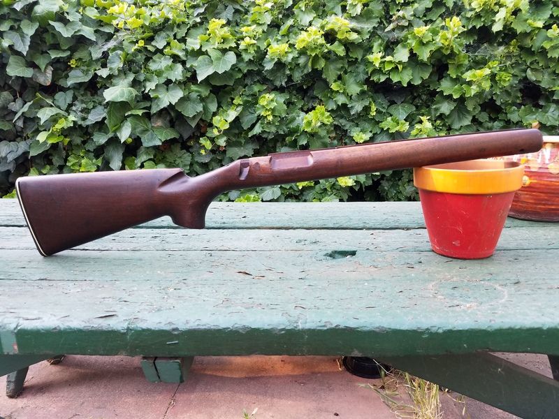

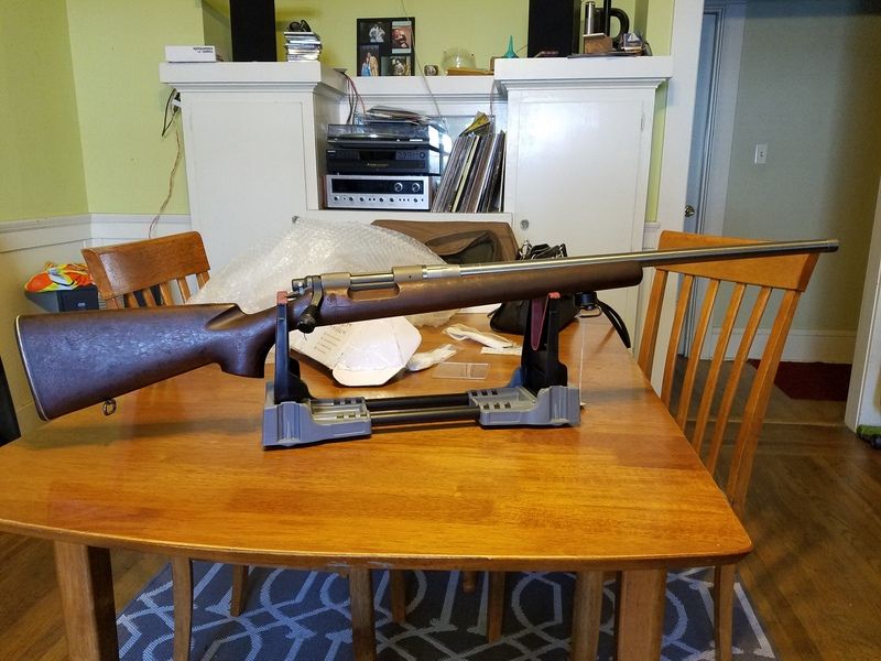

Well, got another rifle project rolling, this time a bolt action, long range prone rifle. I chose 260 Ackley Improved for the caliber, just got a sort-of-temporary stock from a 1960's era Remington 40X target rifle. Been cleaning it up with just a refresh rather than a complete strip and refinish.
Here's after the clean and refresh on the finish...

That's looking good Xander! What wood is the stock, looks nice. I'm a big fan of bold and break action, nice and simple.

Thanx Daniel, this one is good old plain Jane American Walnut. Nothing fancy about this wood, but it is high quality, very straight grained and strong.
I'm going to let the final coats cure a bit before I put it in a padded vise and start chipping away with chisels.

I thought it was Walnut but was not sure... nice looking material! I wast to buy some for scales, it has a classy look.
Chisels - is that so you can bed the barrel or the likes? cool stuff!

Yeah, walnut is nice to work with. I need to open up the trigger area inside the stock because I use an aftermarket trigger, then I need to open up the barrel channel a little bit because this barrel uses a barrel nut to hold it on which the originals did not. Next is the recoil lug on my rifle is precision ground .250", which originals were thinner so the sl9t in the stock is just a little too small.
Once I get all that to fit, then I go and remove a bunch of material around the action and install pillars, then epoxy bed it.

Cool, that is kind of what I was thinking. Yes walnut is awesome to work with.

Chisels are fun to make, I've made a few specialty ones before, I might make some more though for the barrel channel on this stock.
