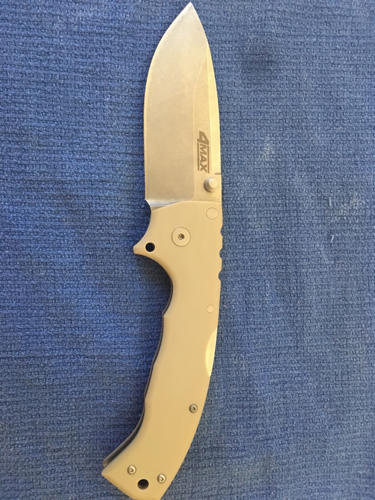

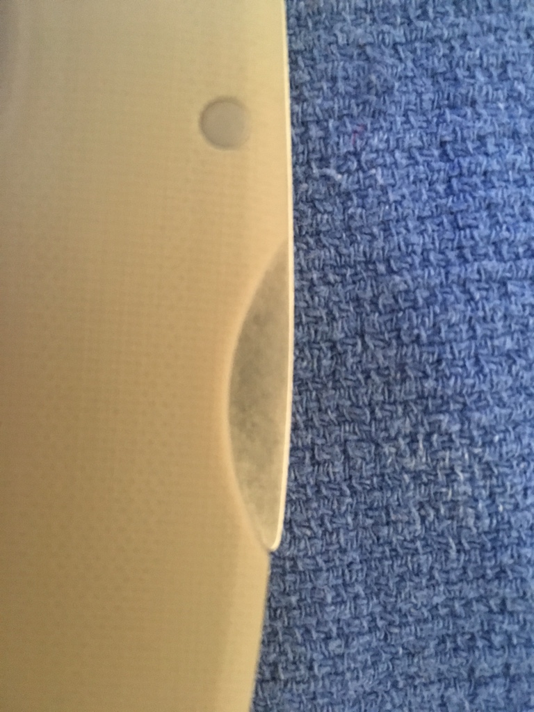

I just got mine. Same way.
On a side note, everything else about this knife is perfect. And the Triad feels as nice and smooth as my Uncle's AD10.

Same with mine - it seems great in every other way. My impression was CS is going to repair them by replacing the rocker with the new ones they are having made. So you will get your knife back otherwise as purchased. Works for me. I really want this knife, been waiting a long time, and do not want to wait on another round of manufacturing or risk not getting one at all if they can replace a part.
Hey CS Rep, thanks for the response. Quick question, so is it safe to assume that cosmetic flaw like this is covered under the warranty, hence we will get repair/replacement services?
Also, based on some of the pictures posted here, i would argue that this may not just be a cosmetic, but a functional/mechanical flaw. With the raised lockbar, there is a good chance that when you grab the handle hard, for example during hard downward cutting or even chopping, the lockbar would get *slightly* depressed and come lose. Obviously this won't generate enough force to completely disengage the lockbar, far from it i would imagine, but this will cause some vertical blade play during use and thus accelerating wear to the lock bar.
I dont own a 4MAX(too big for me, but would appreciate an AD-10 sized one), but i have personally experienced the issue i described above on my Medium G-10 Espada and American Lawman. I can say that for my examples, the lockbar aren't even raised as high as the example shown here.
I agree that it's a mechanical flaw - it's especially noticeable on older designs like the Espada series where the lockbar cutout is closer to the pivot. I've also noticed under strong hammer grip the lockbar gets depressed slightly and caused slight up and down blade play. Since the updated Voyager series the cutout was pushed further back with the indented lockbar, which solved the issue at the cost of being a bit harder to close one-handed.

It seems that yes, a small number of production 4-MAX folding knives were sent out with a raised lock bar that is not seated flush with the scales.
This is not a safety concern, and it would be considered a cosmetic flaw under our warranty.
We ask that anyone who receives a 4-MAX with this raised lock bar and is unsatisfied with their purchase to please contact our Customer Services team via the email below using the subject header 4-MAX LOCK BAR
​We will endeavor to remedy this quickly
