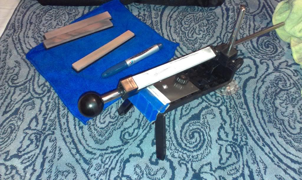

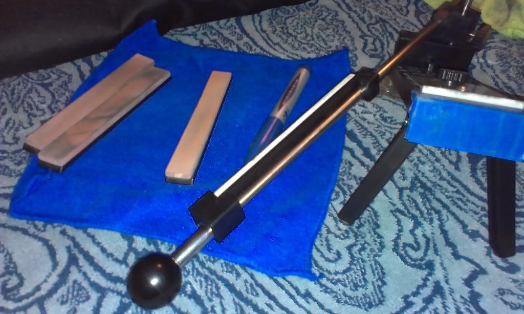

Mine didn't come with oil. It did come with a pen that works better for me than a sharpie. I think it was $30 shipped. The price was higher than other places because it was shipped from a US source so arrived in a couple of days.

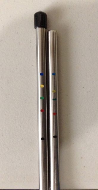

If inaccuracy...

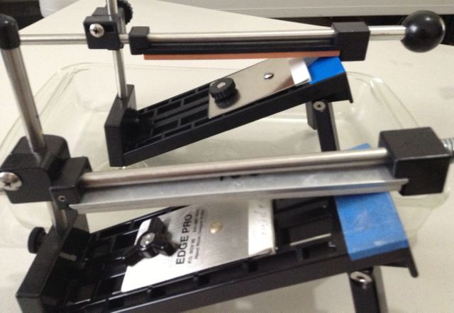

(Improperly cut angle markings)

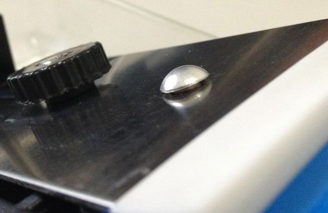

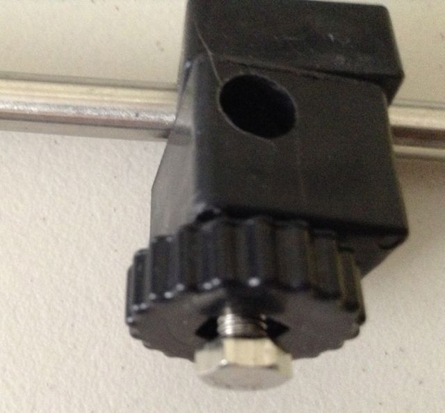

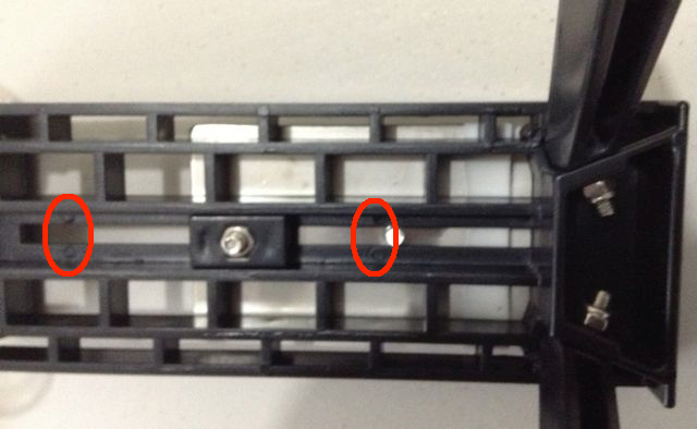

poor fit and finish...
(Knobs coming loose, plastic bits sticking out, poor finish on the bottom that interferes with the blade guide, loose pieces)
(Oh, and one of my suction cups comes loose after a few minutes)

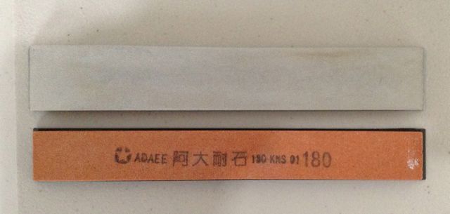

poor quality stones...
(Smaller, very poor cutting, mediocre finish)

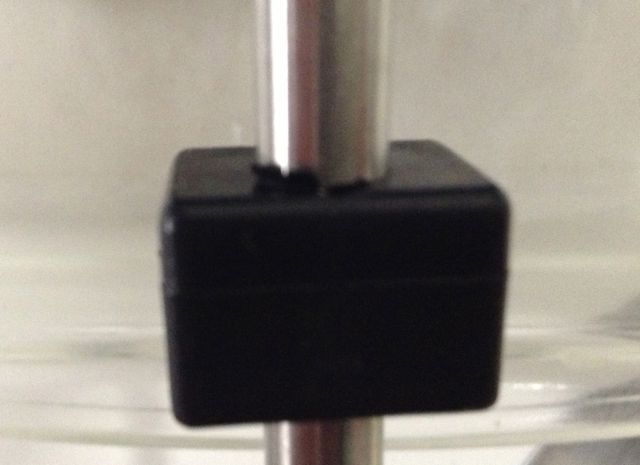

improper design...
(Lack of Blade stops in either direction, copy of older pivot design that's no longer used on "real" Edge Pro)

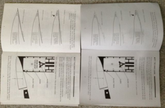

and a poor Xerox copy of the actual Edge Pro Manual...
(Some pages nearly illegible, but hey, they at least tried to white out all "Edge Pro" references)
(And no customer support... no email address or phone number anywhere to be found, so some of this could at least be addressed)
...don't bother you, then this is the sharpener for you! :)
In all seriousness... I bought one to compare, and this is what I found. If sharpening isn't a high priority, or you know enough to overcome some of the deficiencies, like the angle markings and blade stop issues, then maybe it's worth it. You can use "real" Edge Pro stones on it... at a minimum I'd replace the ones that come with this... they're awful. I wonder if, over time, the fit/finish issues will equal failure... I've had my original EP for years with no issues.
I'm not saying do or don't buy, that's your choice... just be aware of what you're getting.

What's wrong with the stones?
Hi guys! Can someone please tell me what's wrong with the stones?
Are they uneven, poorly glued, coarser than stated or do they have a bad finish? Are they irreparable?
I would like to buy just thease cheap stones for sharpening my axes and kitchen knives.
Buying sand paper is more expensive than buying this tones lol. That's why I want to try these.
I would buy a pack of six (240#, 400#, 600#, 800#,1000#,1500#) and a 3000 grit ruby stone.

I have a confession to make; I bought one of these things. The way I look at it is this: I would never have shelled out for the real Edge Pro system, but I did buy a bunch of authentic Edge Pro stones and accessories after purchasing this and discovering how terrible the stones are. Yes, the Chinese ripoff artists made a few dollars, but Ben Dale has also made some sales to me that he would not have otherwise.
If you don't have any ethical concern about buying this Chinese product, then you should at least budget to get the real-deal Edge Pro mounted stones. The stones on the Chinese copy are awful, but I appreciate that I had some super cheap stone to practice on for a few knives until they fell apart (yes, really). In my case, the 180 grit stone arrived broken. The 800 grit stone was so soft that it literally disintegrated after a few sharpening (was shedding pink sand even with a light touch). The 1500 grit stone fell off of it's flimsy plastic mounting block after a couple of sharpenings, though I rather liked the 1500 grit stone after it's layer of surface plastic/resin/wax or whatever it was got scraped off.
Oh, I almost forgot to mention... The stones leave a very uneven scratch pattern, so it seems the grits aren't graded very strictly.
Basically, the mounts are flimsy and provide no support to the stones and the stones themselves are very poor quality - they should be replaced with the real-deal immediately or almost immediately if you plan to use them on any knives you really care about.

I sharpened an axe with these stones with great results (soft carbon steel), but I wouldn't let these stones anywhere near good kitchen knives IMHO.
I've gotta agree about the stones. They are... ungood. The finishing (ceramic) stone is pretty nice though. They actually have fewer flaws than my Lansky stones do, but the mud is rediculous and I don't think that they are made to a very high standard. Big surprise! :)

As far as the markings on the rod of this imported sharpener, well... hell, who sharpens a knife without checking the angles with a cube or a protractor if they really care about precision? I've used my EdgePro for 15 years and doubt I could even tell you what the markings represent! I don't care. I check the angles with a protector, then set it with a stop collar.
