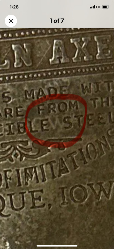

Saw this on the bay today. I messaged the seller saying it wasn't legit and looked like a reproduction/forgery. You can see other letters in the background,I'm thinking it may have been an attempted stamping. Looks like it is Dubuque, Iowa higher up on the axe. Maybe this was the first attempt. Looks like the font is off also. So many things wrong. Look at what is supposed to be the "&", looks like an 8. They soon took it down, seemed like the seller may have been duped. Anyone else see any other fakes/reproductions of these or any other axes??

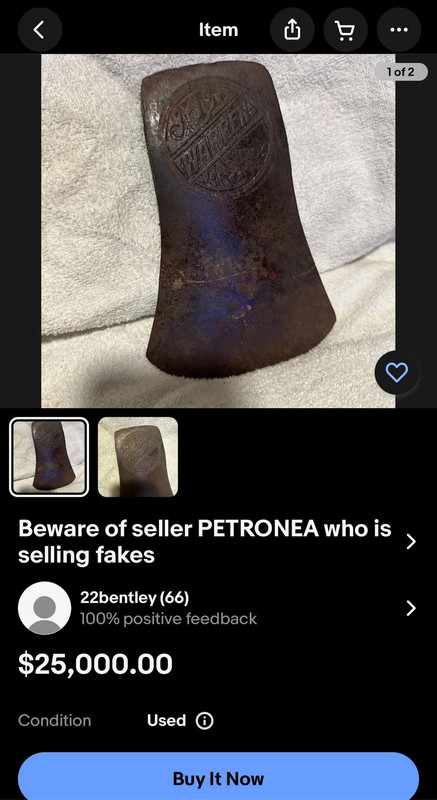

That A-ole has been selling fakes for over a month. He has been notified by many people and reported to ebay. Nothing works.

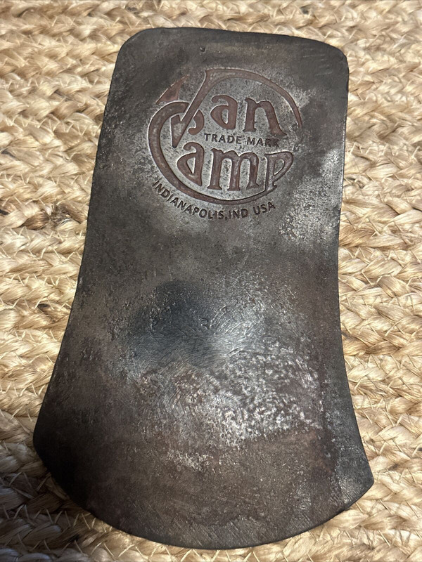

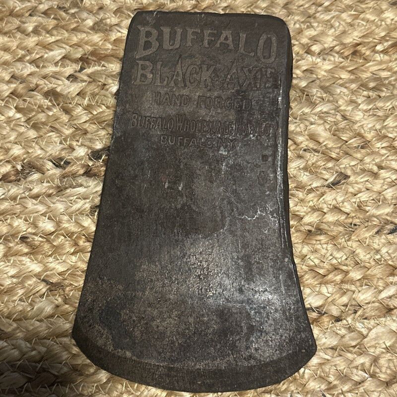

Another 3 listings from Petronea. Full size Michigan with 2 etchings from differnt periods. Buffalo Black Axe that is missing outside lines. Full size Van Camp with partially removed (Plumb?)or is it letter "P" and #3 maker's mark on the cheek.

Can you please elaborate on the Van Camp issue? Not doubting you, I just want to learn what to look for.
If you look at the picture he posted there is a dark spot on the cheek of that head. In that dark spot you can see leftovers of a p and 3 where they didn’t completely etch out before the restamp
Thank you. I see it now. I would have missed that. What did strike me weird is the new etching is awfully crisp considering the rest of the head. Thank again for the clarification.

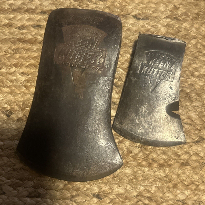

I was going to say I think the keen kutter hatchet is real, but I wouldn't even give that seller $1 for it.
