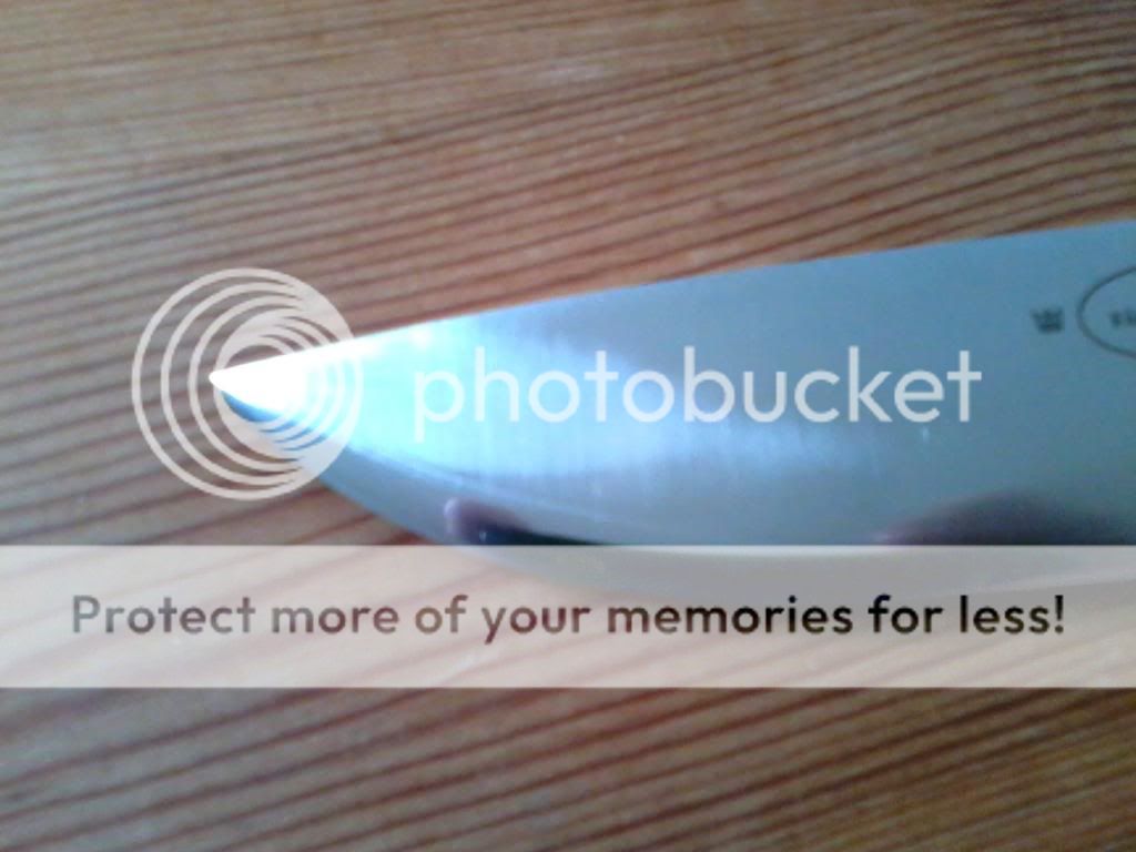

Later that morning I once again unsheathed the knife to prepare breakfast and that is when I noticed the damage to the blade and the broken tip. I searched inside the sheath and my bag for the broken tip but could not find it.

So forgive me if I sound suspicious when I see pictures like that I naturally wonder what has happened to the poor thing as I know from long experience how ridiculously sturdy the F1 is. I hope your F1 will be sorted out and you should write more about your adventures "exactly as they happened". They sound like a lot of fun. Take care.

I am not making claims against you. I am making claims against your review. I am sorry Welshman but you don't know anything about me or my use of knives so you calling me an indoor knife-polisher is unfair. And I don't know anything about you either. All I know is that I have seen a picture where the knife edge has quite clearly been used with a fire steel (judging from the brown particles surround what looks like a burn) and that the user has allowed a stainless knife to corrode.
Experienced users know the importance of taking good care of their equipment in the field. Especially if their life depends on it.
The circumstance of the broken tip or the damaged edge is still not known. I re-read your post and there is just a general description of an evening with camp duties. As I wrote - I am only commenting on your post. Nothing else.

to the op, as you went to sleep with a pristine razor sharp knife that was damaged when you woke up, did you conssider someone could have used your knife to do whatever crap could have caused the damages during your sleep ? say striking the ferro rod a couple of times because the fire died , using the edge and striking a rock with the tip in the movement ? people often lie in those situations. i'm surprised this option was not explored yet.
what i mean is that damage doesnt happen by magic even if the knife is defective the tip has not decided to get shorter, and as you inspected it after the only half demanding job you performed ... something else may have happened.

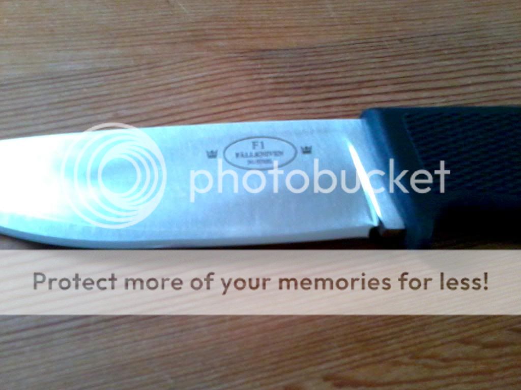

OK guys so hear we go, sorry for the delay in posting the outcome of my broken Fallkniven knife. I had to wait until Fallkniven gave me their response.
First up - I sent the knife when I was back in the UK after Christmas and Fallkniven sent the knife back to me less than 2 weeks later so im happy with their response time.
Secondly - The original knife was sent back to me but regrinded. To be fair it looks like it did when I first opened it at Christmas as a brand new knife. The edge is shaving sharp and the manufacturer has taken away the blemish's in the edge as you can see from the picture (sorry about the quality their from my phone).
I am a little disappointed that the knife was not replaced with a new one as I still do not understand why the tip broke so easily. That said I am happy with the finnish on the knife after its regrind and maybe this extra grinding/sharpening process will actually help to strengthen what was a brand new blade. A few members have said in this post that the knife really comes into its own after usage and sharpening - fingers crossed ;-)
Also I didn't hear anything from anyone at Fallkniven about the knife? After looking at the knife I presume they thought like many of the members who commented in this thread that I was mis-using the knife or that I lied about how it was broken.
