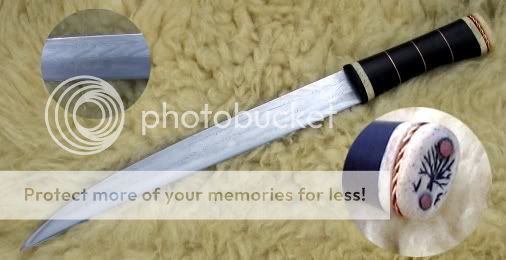

If you really want a true water hardening steel, get you some pure iron bar off ebay or something and carburize it. It's easy to do, even in a charcoal forge. One way I've done it is to forge the bar to about 1/8", then stick it in a goya bean can full of crushed charcoal and cook it at a welding temp until the can disintegrates. then you just fold it on itself, and forge it like a sanmai blade at a lowish heat to minimize carbon diffusion. you won't get a really deep casing on the bar, but you double the width of the HC portion when you fold it. PLain old iron and carbon with nothing else in it is outstanding to water quench in. I water quenched some of my tamahagane that I've made 6 or 7 times in a row with no tempering with no cracking, and that stuff sparks the same as 1084:D

This is a blade that I made out of 1018 that I carburized and water quenched. It came out fine.
