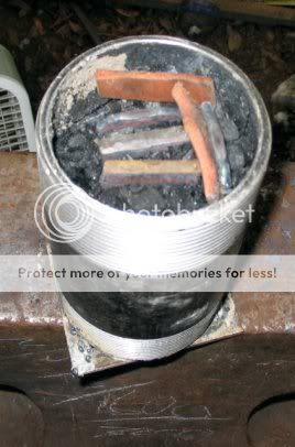

Here's a shot of one way I've done it. I seal the end with satanite before cooking it:
I've done it several other ways,this is just the easiest:)
