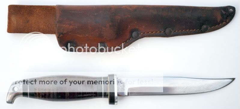

Just my additional 2-cent thoughts about the pommel design:
1) It looks similar to the 1950's USAF Boker 155, so the HEST's pommel design appears as an edgier resurfacing of the USAF design (and I'm sure others before and after the Boker 155 may exist - the bird shaped pommel is not original to the HEST).
2) The pommel may also serve to help prevent the hands from slipping down the handle.
Nothing is original to the HEST.
Just like you are copying HEST, the HEST has borrowed every feature from other long-existing knife designs.

I see no similarity between the pommel on the Boker and the HEST. Not sure what you're seeing.
