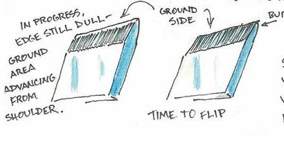

When you move to finer stones there is always going to be a drop off in feedback. It will still be there but will just become increasingly faint.
The best trick I have to counter this is two part.
First - always work from the shoulder to the apex. Do not think you can set the edge on the bevel and get best results floating in your margin of mechanical error (I still do this from time to time when in a hurry, but not when I want the best outcome I'm capable of). Is possible, but not very systematic.
By running from the shoulder to the edge you should find you always stay within your target angle. Although in theory you will be making it slightly more acute every time, due to margin of error you will find you simply maintain the target angle better.
Second - as you work, every so often lower the spine for a pass or two so you lightly "bump" the shoulder transition on the stone. This will give you an on the go tactile feedback that is extremely reliable. Just as you have been elevating the spine to get the feel of the apex on the stone (and so make the edge too obtuse), change that out to use the shoulder transition to recalibrate instead.
As you feel it hit, elevate the spine till it just drops off and keep grinding. At some point (with practice) you will find the edge becomes "trapped" between the shoulder and the apex - you'll begin to feel the apex catch/drag almost in the instant you feel the increased feedback from the shoulder begin to fade. I've tried to convey this in some of my videos, but the audible change on recording is not apparent (in a noisy environment it is not apparent in person!) and the tactile sensation does not come across at all. This is one of my best "tricks" and can not only speed up your hand grinding but increase your precision as well. As I'm pounding along I frequently give a slight bump and go every six passes or so - fewer as I get closer to resetting the bevel. At some point every pass feels sticky on the stone and I know without even looking I have a burr and/or am three finger sticky on the edge.
At this stage you have made the most flat edge bevel your mechanics and senses (and patience!) are capable of producing. Using this method and being honest with myself, I can make a near dead flat bevel - most often I use it a bit more loosely just to verify I am still in the neighborhood of my target angle.
On edges with very thin primary grinds and relatively small angle shifts between primary and cutting bevel there will be precious little feedback at the shoulder but it will still feel different from the bevel or apex hitting.
On convex you will need to work behind the apex and sneak up on the apex by slightly elevating the spine till you just feel it catching. On convex the bulk of the work is always going to be just behind the edge, the edge itself only requires a pass or three total to grind a new apex. This is true to a lesser extent on edges with extremely narrow cutting bevels and shallow angle shifts from primary to cutting bevel per above, and partially offsets the reduced tactile markers.

The old "shoulder bump" method needs to be a fairly subtle move - just a slight drop and go of the spine. Any evidence of it should be erased as you go. Too much rounding and you not only lose the reference point for future work but you negatively effect the job at hand.
I began using this when working on other folks knives and wanted a real fast way to set the edge to what they had, rather than my pre-programmed 28 inclusive. I'd do a few very light exploratory passes elevating the spine and once I felt the edge begin to catch I'd lower the spine till the shoulder catches. I now have the range that defines my dull edge. Is a natural extension to use it as you go, but avoid the edge bump as it rounds the apex - just a slight drop of the spine for a light pass, half a pass, third of a pass etc and back up. Dead on the bevel has the least feedback. You can also "look" for unintended sensations of edge or shoulder dragging to let you know where on the edge you're getting sloppy - very useful when working pronounced bellies, tips, recurves, where total contact area is at its smallest.
More practice on the stones is also needed any time you make a switch to different media, best to have some knives around that get taken out for this purpose and not your good stuff.
The Spyderco Medium will begin to speak to you just like the Norton. You need to examine what it is you're using (sense-wise) that clues you in on the Norton and DMT, and look for it on the ceramics. You must already be using tactile feedback but haven't analyzed it yet.
...and can usually tell if I'm too high or low if the feeling or sound changes
As you go to finer abrasives the tactile feedback drops off - is relative to abrasive size and how deep it cuts the steel - but is still present.
Another factor and another reason I religiously reference to the shoulder, the margin of error is relative to the abrasive. You can have an optically flat edge that has a bunch of convexity to it under the scratch pattern. As you work on it with finer abrasives, the lower density regions at the shoulder and edge will grind away first, revealing the rounded bevel. If you don't pick a point to reference to, eliminating that rounded geometry will be extremely difficult, hinge entirely on muscle memory and you'll have to do a lot more grinding to flatten the edge again. Here's the diagram I use to illustrate the concept:
1) is the abraded region
2) shows the range of variation one can have without any real change in tactile feedback. the region of highest density is dead smack in the middle.
3) is the funhouse side-view of these paths
4) is what happens when you start grinding away - the low density regions grind off first, practically guaranteeing you wind up with more curvature than you wanted.
