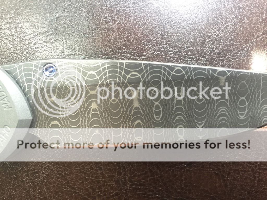

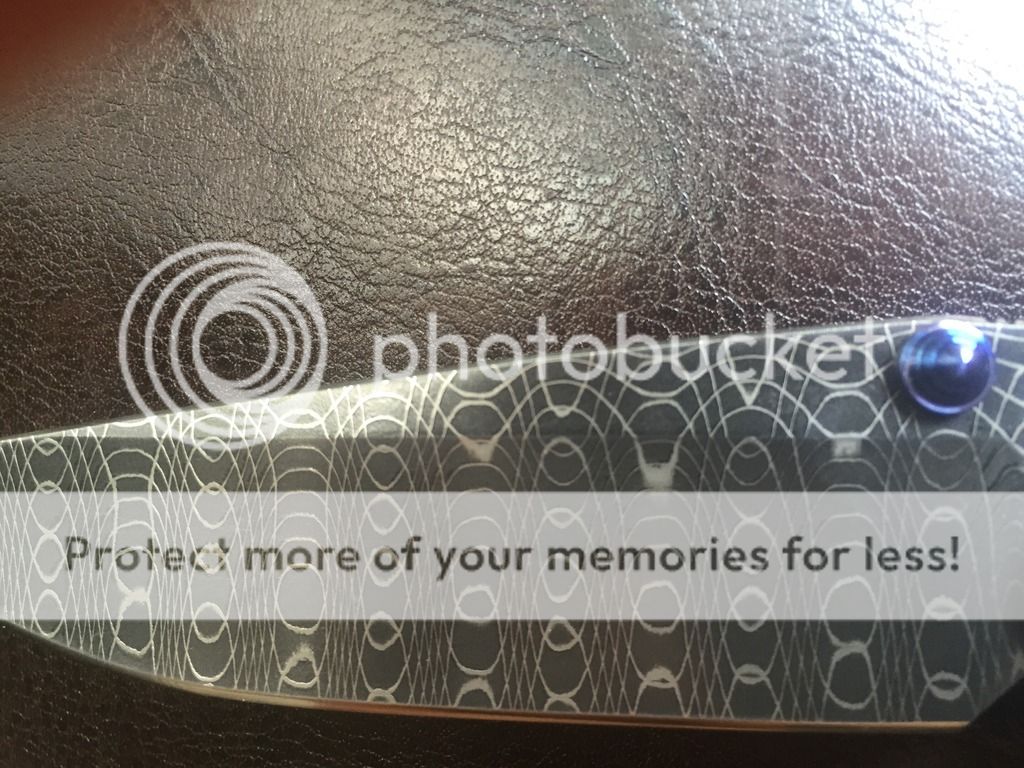

I got my new large sebenza TNK spirograph damascus today and was kind of disappointed at the quality of the pattern. Im well aware that it's not suppose to be perfect and wasn't expecting it to be but Im just not happy with it. I got 4 other damascus sebenzas and non of them have this type of inconsistency. I've also seen pictures of the same knife posted on the spirograph damascus thread and images online and haven't seen one like mine, it amost looks like they smeared the metal specially right on the middle of the blade.
I think for a $700 knife I was expecting more when it comes to quality control, I know for sure I wouldn't sell a blade like that.
I'd like to know your opinion in regards to this, thanks in advance.

Can you post a couple more pictures? It's hard to tell with the Damascus looking kind of faded in these pictures. (I know it is difficult to capture Damascus blades - I always have a hard time.)
Send it back, you're not the first to have issues with this batch of knives coming from TNK. They are great, and so is their CGG, but many of them have been flawed. That looks pretty terrible and I'm sure they'd understand the return.
I'll try to take some more pictures, Im not real picky but that middle section just stands out too much:grumpy:
I've seen previous batches and compare to them, this last batch looks a bit sloppy IMO
Yeah, I'd send it back. They have made the pattern a lot more irregular, which I like on the raindrop damascus more, but that pattern looks terrible in some spots.
If the retailer takes it back ... you are good to go. But frankly, there is nothing "wrong" per se with the blade. There is nothing consistent about any Damascus pattern. This is one reason I would need to see a picture of the actual blade before I bought it ... much like I would need to see an actual picture of a wood or Mammoth inlay. They are all different. I would bet the farm that CRK would tell you nothing is wrong with the blade .... that is just the way it came out. If memory serves me correctly (and that happens less and less frequently) one of the reasons CRK stopped using Spirograph is because they were having some etching problems with it (or at least the batches they were receiving from DT). Now, the dealer might very well take it back (and either exchange it or refund you) as a good will gesture. Hopefully, it will work out that way for you.

I also agree that damascus blades are all different, I wasn't expecting a symmetrical or perfect pattern but those spots on the blade look more like defects than character. Even my wife asked me way the blade looked that way.
"That's the way it came out" wouldn't be a good excuse for me, Im gonna call the dealer on monday and see if they are willing to exchange it, otherwise I'll just get a refund.

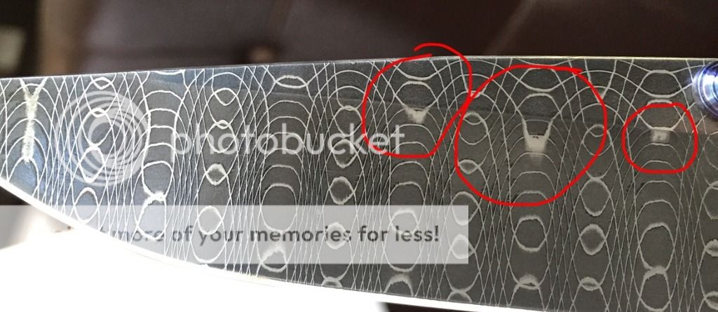

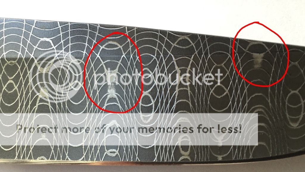

Here's a couple more pictures
Please tell me it doesn't look like someone messed up and smeared his finger on the pattern...
I can live with one of those but 3 on the same side...? I think that's a bit too much.
When you look at it, your attention goes straight to those spots instead of the actual pattern.

Again .... it's the nature of the beast. Here are some pics of spirograph blades I have (or have had). ALL are DT spirograph. All are different. Some exhibit etching similar to your. Others are totally different and much cleaner.

Those smudges are something that happen when making damascus, grinding a blade can also see all sorts of unexpected things happen to a pattern. That said, your blade does indeed have more than the smudge or two one might expect. The second picture of the presentation side is perhaps passable to me, but the pattern on the lock side is not great. That pattern does usually look much crisper.
Edit: Looking at the better pitures, I would say something definitely went wrong there. I would not be happy with that blade either. I hope you can get fixed up, good luck with that from what I hear. :)
You read my mind there :)
700 bucks and you are obviously not happy. For that money I would definitely want one without blemishes like that in the beautiful damascus. Perhaps you should get a refund and try some other batch or dealer. Thats what I would do, and just my opinion.

Having said that, it's important to understand these are not true "Damascus Steel" blades, though that term is used universally to decribe them these days. They are 'pattern-welded' blades. The pattern is not created by the acid etching, the etching simply reveals the pattern that is there. These patterns exists in three dimensions, and are not uniform though the stock of the blade, like you might think. The swirls of the "Spirograph" effect get larger and smaller, and the side of the knife simply reveals one plane of that pattern, which may contain "smudges", which are in fact the places where the pattern is transitioning from one steel to another. When the blades are ground it is impossible to predict where these smudges will be, so a portion of the cost of Damascus blades is to cover discarding blades that turn out very smudged, that customers would reject. All of the CRK patterns have these smudges on them, in varying degrees, with some very sought-after perfect patterns popping up from time to time. The ladder Damascus seems to the least prone, and the smudges are almost unnoticeable in the raindrop due to its already mostly random nature.
That is the crazy crux of the Damascus blade issue. The repetitive pattern appeals to our OCD, but the pattern itself is often flawed, which annoys us! CRK could issue only perfect DT Damascus blades, but they would have to discard a hell of a lot more blades than they do.
