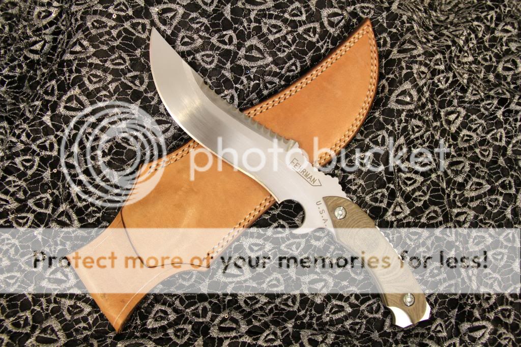

I own both, love both. The Fehrman Extreme Judgment is their only true chopper, the Final Judgment can't compare with it......and Busse did make the EJ first under a different name. The 3V Eric puts out is perfectly HT'd and my only complaint is corrosion resistance. My EJ has begun to actually pit in a couple spots. Where my Infi is bright and shiny all day every day. The Fehrmans have basically one handle and while it's decent, some may find it lacking.
Final Judgement not a true chopper, can't compare with extreme? Huh? Aside from being a bit wider what's the difference and how much of a difference makes "can't compare with"? :)

For me, they are pretty much equivalent. The Fehrmans come with a more acute angle, and have better edge holding when cutting fibrous material. Busse has more variety and is supposed to be tougher. 3V at 58 or so is more toughness than I'll ever need. The only Busses I've been disappointed with are the "boney" series, the INFI is hardened to above 60, and you give up toughness for edge retention, but for me, the edge retention wasn't all that great. Regularly hardened INFI is fine with me.

Weight EJ 1.49lbs, FJ 1.36lbs not too much difference
Balance point FJ about .6" forward of scales
Balance point EJ roughly 1.1" forward of scales so it is a bit more blade heavy
FJ 1.62" high
EJ 2" at widest point
EJ .042" or 1.06mm thick behind cutting edge grind
FJ .072 or 1.83mm behind cutting edge
So the FJ is thicker at the cutting edge and a hair thicker than (.249" vs .247) the EJ so it tapers much more quickly to the spine thickness and wont bite as deep as the EJ. So each of these measurements aren't much individually, but all rolled into one package (the Extreme Judgement) and you have a MUCH better chopper than the Final Judgment. Also with the curve of the EJ, the sweet spot is more concentrated and makes for a VERY effective chopper. To sum it up, the EJ is heavier, taller, thinner grind, more blade heavy and has a natural focal point.
This is "my" experience with loads of use of both. Don't get me wrong, the FJ can be used as a chopper, but the EJ outshines it. The FJ is a 9" blade 1/4" blade, but so is a Chris Reeve Shadow I and Mountaineer but they are by NO means a chopper.

I my hands I prefer the FJ. I feel better control because of the almost half inch less wide blade. I get better accuracy there because of it. I really can't say I notice any difference in chopping depth. If there is it's so slight as to not be a factor in my use. I do get fatigue in the forearms and wrist beginning faster in the EJ, but that's not all that great either.
In short I just prefer the FJ due to the better control it gives me. My chopping will be limited anyway as I much prefer axes or better yet mauls. I keep an 8 lb in my car even. :) When I was heating my house I used a 12 lb maul so to be honest chopping knives are not going to be primary at any of my perceived wood splitting needs. The chopping difference between the two Ferhmans is sort of trivial. I would feel that way even if that's all I had anyway. I'm more interested in accuracy and ergonomics than any difference in cutting depth. I'm curious. Have you compared bite depths in actual measurements? There is less differencein knives this close than in the differences between wood types ( Gum vs. Oak, or Birch. for example. Pretty large difference even on non knotty sections much bigger difference than between knife types. ), moisture contents and temps. ( below freezing is better). Now the difference between an 8 and a 12 lb maul is pretty noticeable. Two knives essentially 9 inches, 1/4th inch, and similar weight would have me thinking about comfort factor more than bite depth. The thickness numbers you gave are interesting but not difference makers to me. In fact, I never noticed the thickness differences in mine. The coating makes a bit of a difference though in my experience. I'll never buy another coated one. :)

My "can't compare" is a bit over exaggerated, but it's my excitement to tout on the Extreme Judgment that clouds my speech on occasion. It's great the FJ is your perfect blade and I had one for quite a while (still have my early keyhole editions) but the EJ for my "wants and needs" foots the bill so much more.
