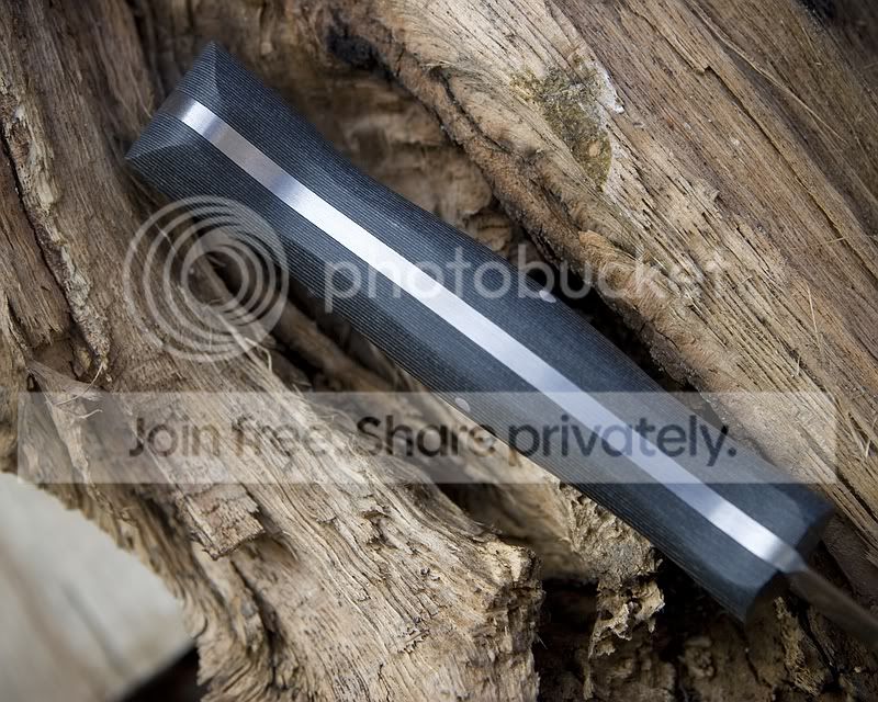

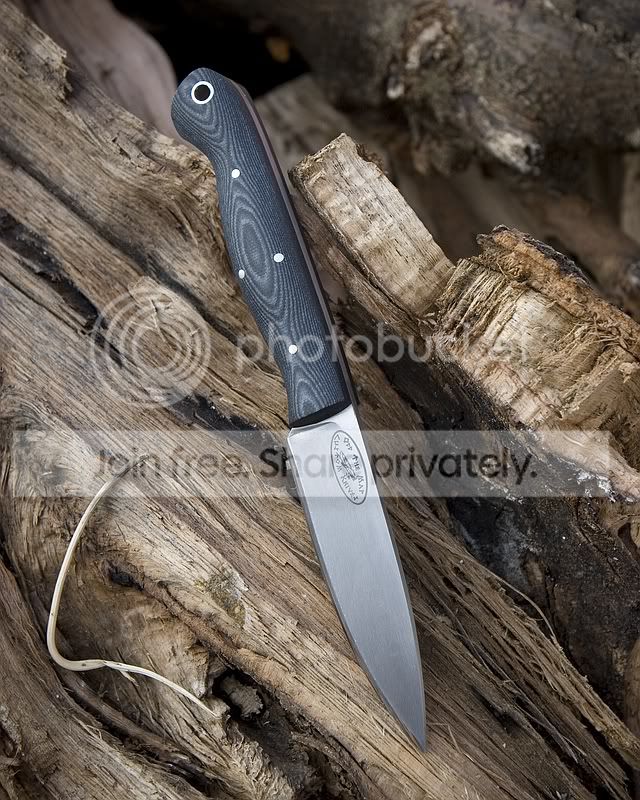

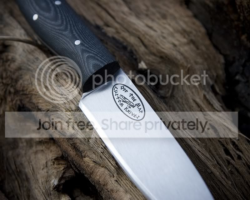

I designed this knife for a female friend, who is a backpacker. It was intended to replace a lightweight folding knife on backpacking trips.
Keeping the mission in mind, there were two main goals for this knife; To keep the overall weight low, and to have maximum blade length while keeping the overall length as small as possible.
Here are the design features considered when making this knife.
- Thickness from edge to spine: Was kept on the small side for this knife. More steel was going to add more weight.
- Less handle thickness: A trade mark of my style is generally a fairly large, shapely, hand filling handle. That is because I want knives to be comfortable after hours upon hours of use. However, keeping the backpacking goal here in mind, and the overall weight, I wanted a smaller lighter and more streamlined knife. The intentions for this knife is not go sit for hours and do a bushcraft project. It was designed for more casual use, yet to still be comfortable.
- Steel thickness: This one is 1/8” : A backpacking knife is generally called upon to do lighter tasks, such as opening food, cutting food, cutting rope, and depending on the area, even fire prep. Sharpness and slicing ability rule! Yet any that have used thin steel hard knows that a thin knife can still take plenty of abuse. Should you need to call upon it for more strenuous tasks, the benefits of a fixed blade over your folder will make it worth its weight in gold.
- Maximum blade length, but still minimum overall length: This was done first by giving the desired blade dimension. Then, to cut down length, a formal “guard” was eliminated. Instead, besides the palm swell and generous curve was put in place before the cutting edge. There is also another slight palm swell, so that the handle is shaped in all 3 dimensions. I felt, again with the intended plans for this knife, that these things are good for reducing possibility for forward movement of the hand toward the cutting edge. Just a quick aside, on my knife philosophy; Most “cutting” motions tend to pull the knife from your hand, rather than force your hand forward. I consider the design of the “butt” just as important as the guard. Also, any motion that you do that wants to move the hand forward should be handled through a combination of secure grip, provided by the shape of the handle, or proper knife hold (such as placing the butt in the palm of your hand). Proper handle shape will help decrease the possibility of movement, while proper knife hold will eliminate it all together. Proper knife hold should be utilized any time there is a chance of that occurring. With that in mind, I tend to be more comfortable with “less” guard than most, but will design anywhere from a generous guard, all the way down to almost nothing, depending on the knife intentions.
Also, of special note, this knife was designed around a female hand. Therefore I think it is better suited for women, or men with hands on the smaller side. The reason is I have found that the “forward” grip works just fine for me, but when I turn the knife completely around, I feel my hand fills up the handle too much. With the smaller hands that have tried this knife, all different knife grips worked extremely well.
Enough talking about it, here are the pics.
If the handle pins looks like a rip off of NWA's style, it is. My friend also knows Nick too and she asked if I could do the 4 pin thing. I asked Nick and being the nice guy he is, he said okay and set me up with some pins. While I love this a lot, it will probably be the last time I do it so that I am not copying one of his trademark things : )
Additional Specs:
Blade Length: 3 5/8”
Overall Length: 7 3/4”
Thickness: 1/8”
Handle: Midnight Tiger G10
Grind: High Flat grind, with polish convex secondary bevel.
Steel: O1 (Considering offering this one in other steels as well)
This design is a bit different. So, I wouldn't mind hearing some feedback, especially from you backpackers.
I am letting my friend name the knife, and whatever name she comes up with, I will more than likely make an XL version. Just a touch bigger and more roomy for a guys hand.
Now......the part I must admit. My wife wanted one too. So, I have another almost complete in pink G10 (rolls eyes) LOL. Not a big fan of pink, but what are you going to do : )
Thanks,
B

Oh, really dig that logo you're using!

Love the entire knife - although I have to wonder about your choice for a secondary bevel that is then convexed. Why not simply convex the entire blade? Either have the ease of a fairly large secondary bevel - or convex the entire thing - why did you choose that?

Couple questions...
How much does it weigh with the sheath?
Are we talking about long distance backpacking or more the weekend warrior types? (Qualifies next questions...)
What kind of stainless you thinkin bout? (oops what kind of "other steels")
Is the sheath kydex?
All I would add for thoughts is that if were talking about longer trips, we know what the O-1s gonna do when, not if, it gets wet, as well a leather sheath might not be best if exposed to long periods of wetness.
Also a serious backpacker intent on making miles isnt neccessarily going to want to tote sharpening supplies or something to keep the steel from rusting.

I love flat ground blades, and usually wind up putting a convex bevel on mine anyway. The handle looks AWESOME love the G-10. The blade shape and overall dimensions are SPOT ON imho. That knife is a perfect size.

Just for the sake of healthy dialogue; Does a serious backpacker intend to use a knife? Any knife will have to be sharpened eventually. However with the convexed edge, all one would have to do is apply some fine abrasive compound to one's belt and strop as needed. Do you mean an UL backpacker? One is not necessarily always the other.

Having met your friend, I'd say she'll love it. Having shown it to my wife, she says it looks great but could be a little shorter in length. Decreasing the handle length to 4.00" and keeping the blade to about 3.25" would knock the overall length to 7 1/4". Dropping to 7" total length would be even better.
Great blade shape, reminds me of the Bryans kat blade a bit, but yours is more pointy. I think the flat + convex edge is the perfect grind for this blade!
Just for the sake of healthy dialogue; Does a serious backpacker intend to use a knife? Any knife will have to be sharpened eventually. However with that convex edge, all one would have to do is apply some fine abrasive compound to one's belt and strop as needed. Do you mean an UL backpacker? One is not necessarily always the other.
Not UL vs heavy persay but lots of backpackers dont wear belts. The convex edge is certainly the way to go though, I would carry a tiny piece of sandpaper (800 i think) and could manage a touch-up on my calf (do not try at home!)
