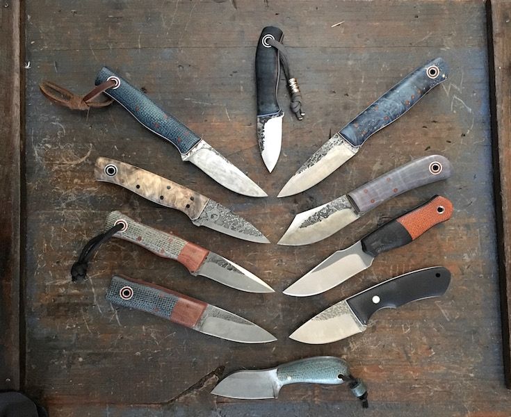

As usual, what follows are my very idiosyncratic impressions of fantastic handmade knives; my preferences, relatively lame tame uses, and personal bugaboos are near and dear to me, but bear no reflection on the top-shelf quality of any of the knives in question. I am more certain than ever that some of the attributes that might turn me away from a given knife are precisely those that will render it perfect in another's hands and life.

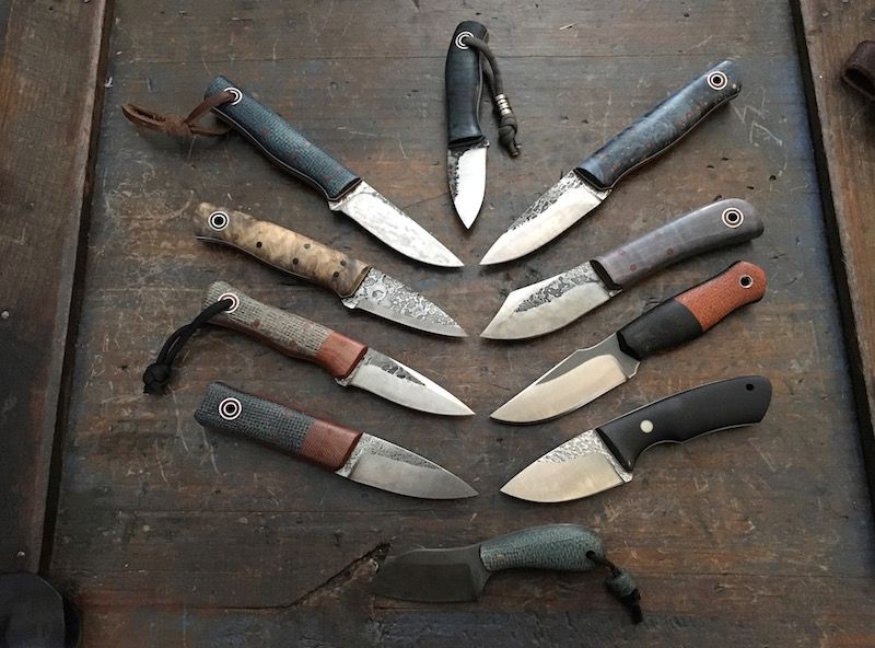

The sojourners join my Fray:
IMG_9202.jpg~original
Left, from the top: Patch, EDKarda, Esquire, Sgian Dubh; Right, from the top: Handyman, Sylvrfalcen, Fletcher 24/7, OK&T Tusk; top and bottom center, Runt and a Freeman Forge Pocket Muk

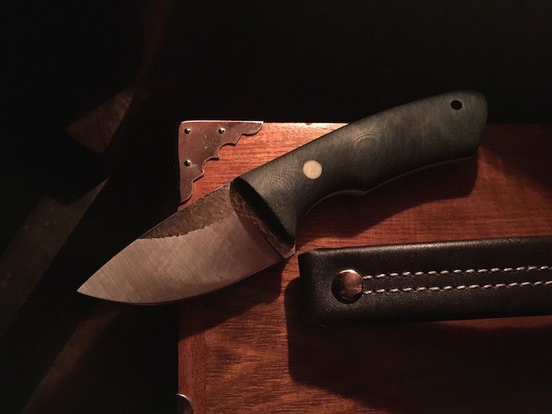

The Tusk upon arrival, in the winter dark:
IMG_8963.jpg~original
Once in the cold light of a new day, I was immediately put in mind of the appointments on my GS Mini:
IMG_8994.jpg~original
IMG_8993.jpg~original
IMG_8995.jpg~original

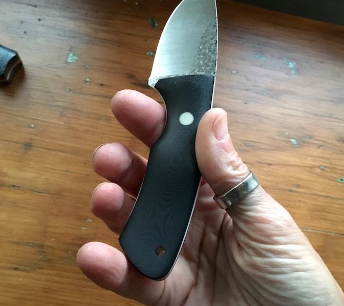

As with my previous experiences with Chris Linton's knives, my first and abiding impression is one of painstaking refinement. I find Chris's work to be characterized by a certain tautness of design, a purposefulness in execution-- and this wee Tusk is no exception.
I don't tend to prefer G10 for knife handles, but it really works well here; its minimalist elegance complements the pattern's lines while providing welcome weight to this smaller piece.
IMG_9019.jpg~original
IMG_9020.jpg~original
(My hand and I especially liked the flare here at the front of the handle)
IMG_9028.jpg~original

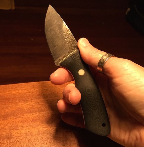

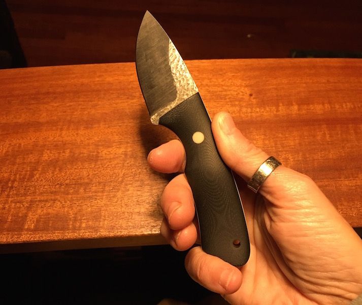

The Tusk's handle is made to sock in well via the front finger groove in front, and the angle and finishing on its pommel to the rear:
IMG_9011.jpg~original
And here, my first pictures weren't as clear in demonstrating the following as I'd hoped, so I paused just now to take the following in lamplight.

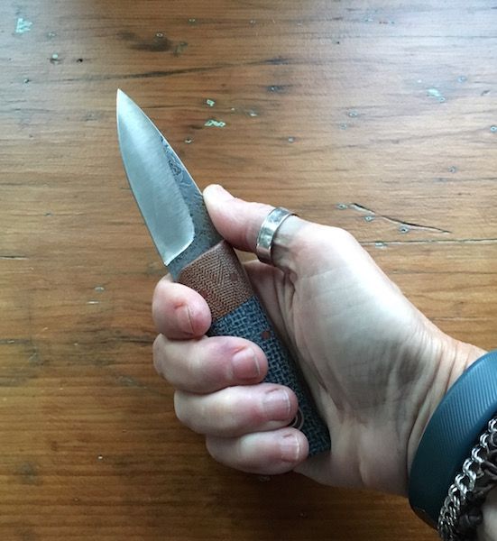

As in the previous picture, the contours of the handle and how it fits fingers:
IMG_0581.jpg~original
And here's the rub: the handle will undoubtedly fit bigger hands really well, and I'l venture that almost anyone seeking out this knife will larger hands than I-- it hits its target market.
But for me, if I align my hand in the most comfortable position, in keeping with the handle's cues (index finger in front groove, pommel of knife nestled between ring and pinky fingers), I am left holding the knife by its tail-- or so it feels:
IMG_0582.jpg~original
If I move my hand up to a more optimal position...
IMG_0583.jpg~original
... my middle finger lands exactly on top of the descending ridge, unless I scrunch it forward to share the groove with my index finger.
IMG_0584.jpg~original
Now, I can grab-and-go with this knife, let my fingers fall where they may, and possibly still determine it to be relatively comfortable over time and use. However, because I can envision
how great the knife would feel if it socked into my hand as designed, I would likely always wish it, or I, were other-- not a welcome feeling.
Dang.

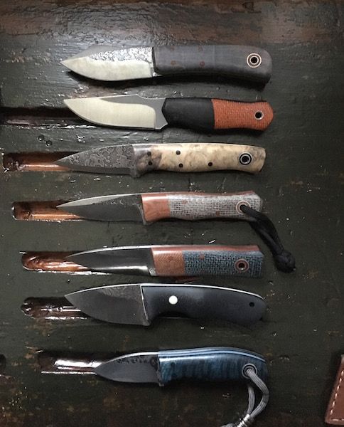

In line with the Sub-7"ers:
IMG_9055.jpg~original
IMG_9066.jpg~original
With the 'falcen...
IMG_9058.jpg~original

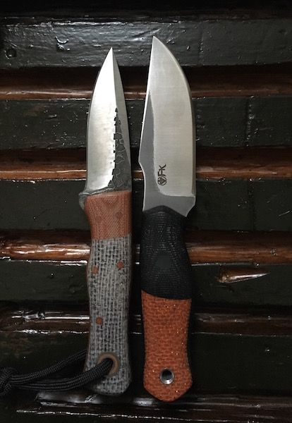

... and an Esquire:
IMG_9063.jpg~original

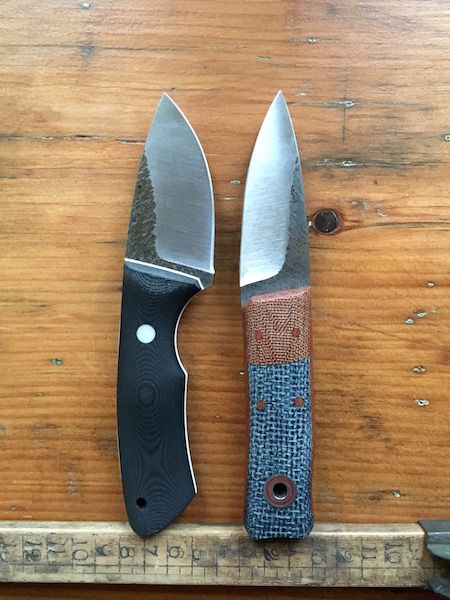

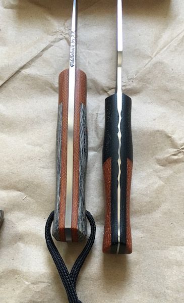

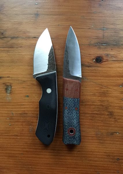

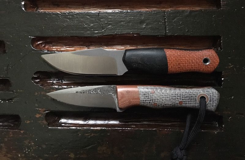

This fascinates me: look at the difference in blade-to-handle ratio in these two knives of similar relative length:
IMG_9064.jpg~original
There is also this!
IMG_9113.jpg~original
The 24/7's handle is not only significantly smaller, it is slimmer throughout, especially in its waist.

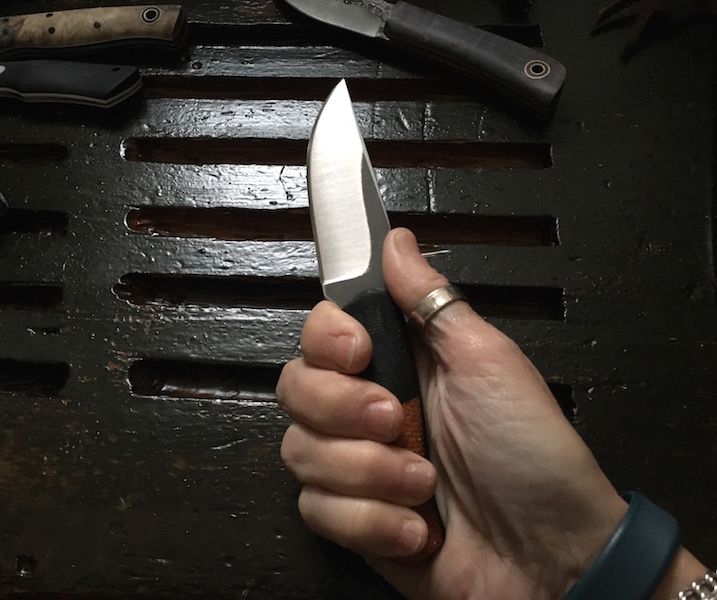

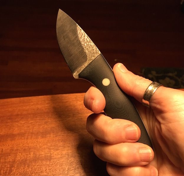

But, what's this?
IMG_9060.jpg~original
A knife that feels great in my hand. :cool:
I took more pictures trying to show Why, but they all looked like the one above-- my hand with a blade sticking out.
The 24/7's handle just plain works for me, its vertical contours swallowing up my hand in a very pleasing way, astonishingly so given its relative shortness. This particular knife is lighter than I'd anticipated (neither a plus or minus, and of course a consequence of steel width and handle material). I also really enjoy the relatively large blade.

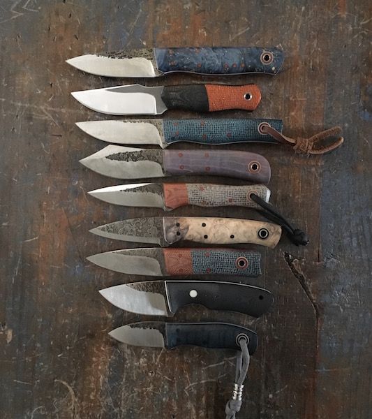

Speaking of which, look where the 24/7 falls in my blade-length line-up:
IMG_9211.jpg~original
Like I said: COOL.

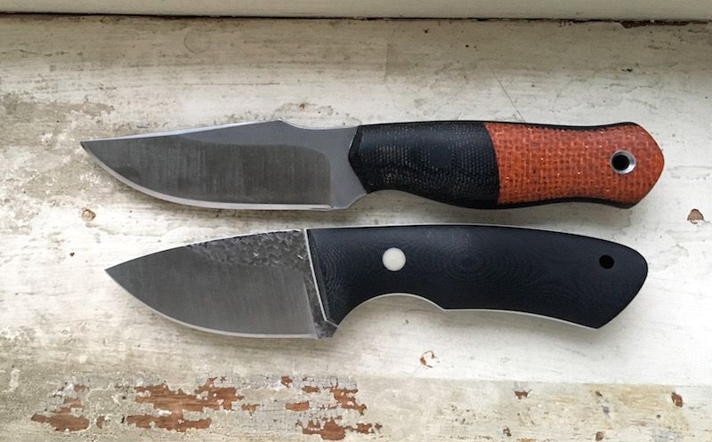

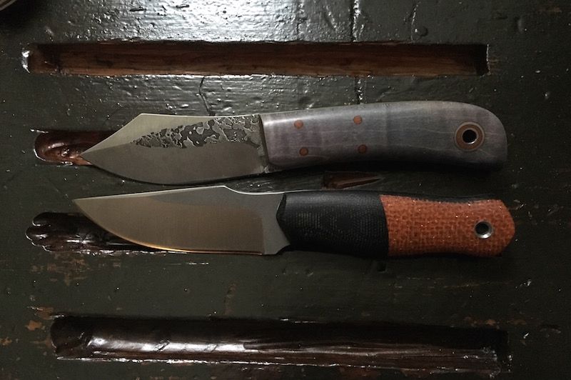

One of these things is not like the other:
IMG_9200%201.jpg~original
One of these things does THIS:
EvilGrin.gif~original

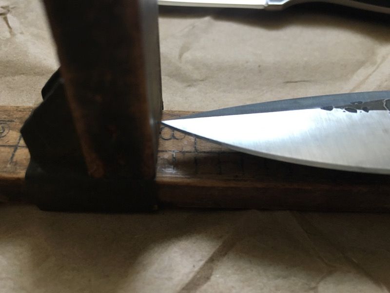

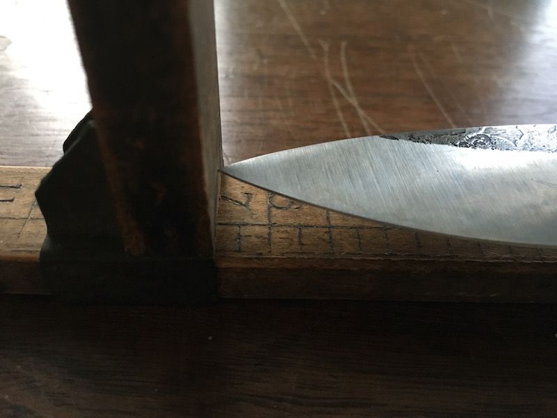

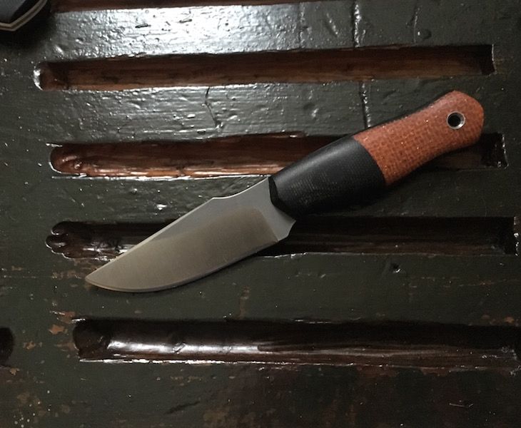

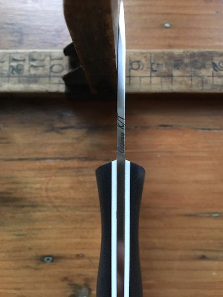

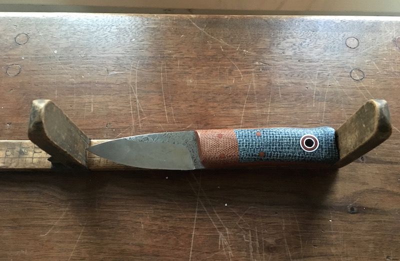

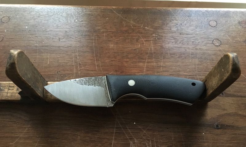

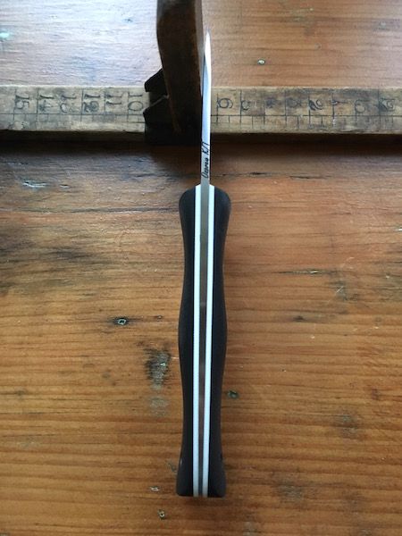

I also put both the Esquire and the 24/7 on the useless, hand-drawn measure thingy (I believe it's an antique foot sizer?).
Esquire:
IMG_9116.jpg~original
Wouldja look at that swedge, those lines. Ooh, la.

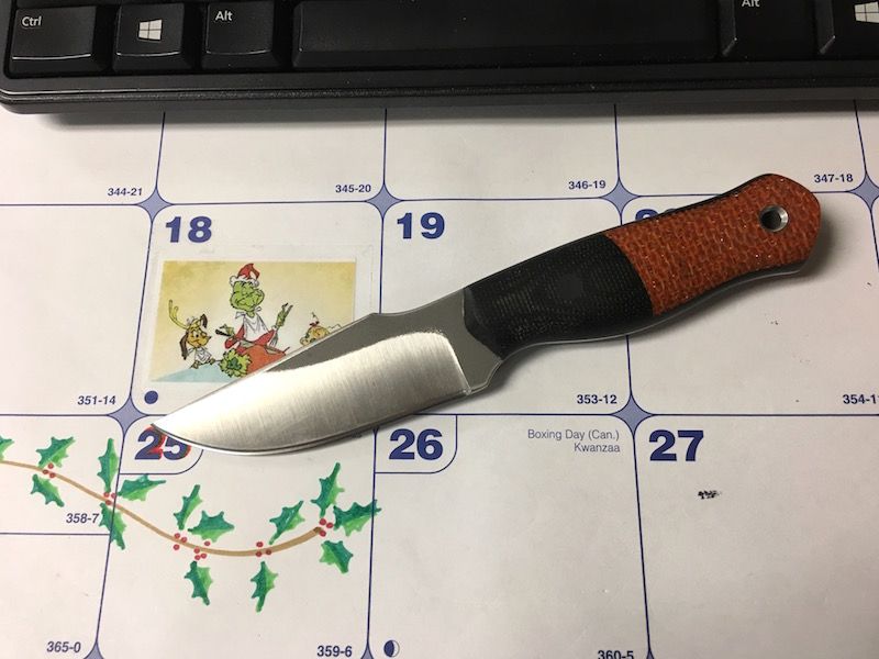

24/7:
IMG_9115.jpg~original

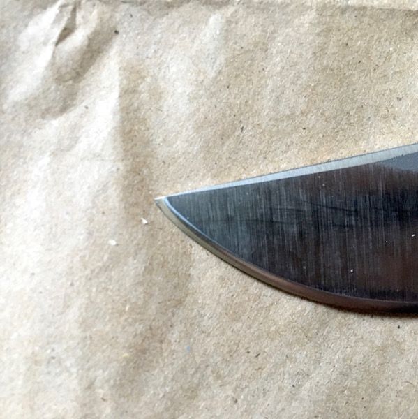

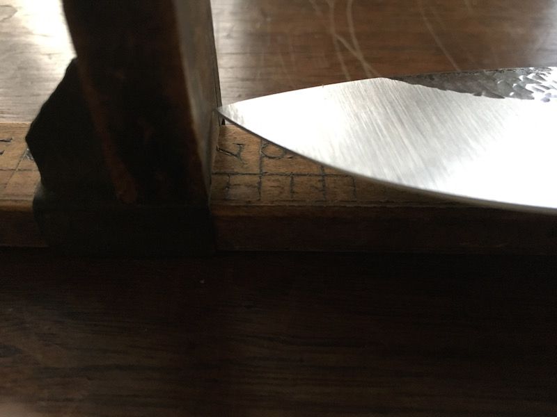

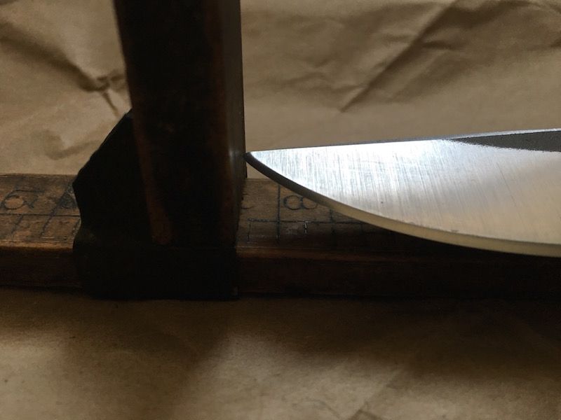

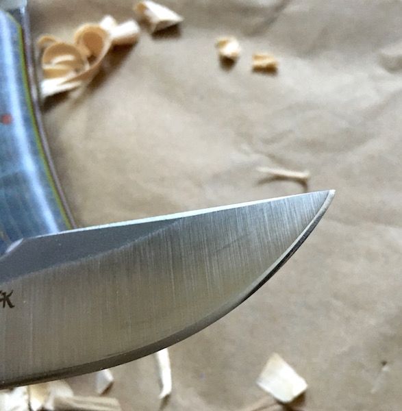

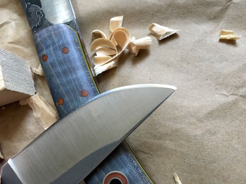

And herein we glimpse a question mark regarding the 24/7: the blade tip, or lack thereof.
IMG_9121.jpg~original
IMG_9123.jpg~original
The mark side seems to be snubbed, and the point isn't sharp. Whether or not the blade was like this from the get-go or had an Incident, were this my knife I would want a pointier, pointed point on the blade, hopefully from the maker, Tim the Wizard Tim the Wizard 'd if not.
In other news, notice how blue my BLUE Sylvrfalcen appears in these illustrative images:

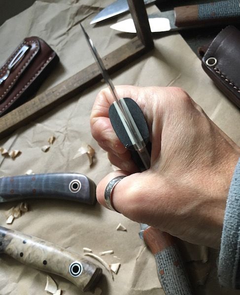

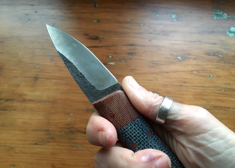

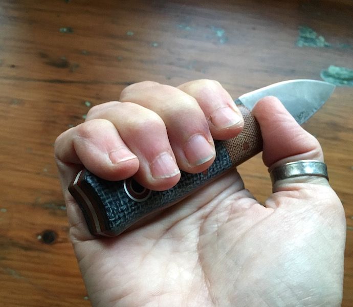

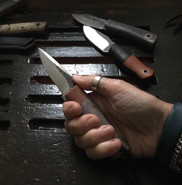

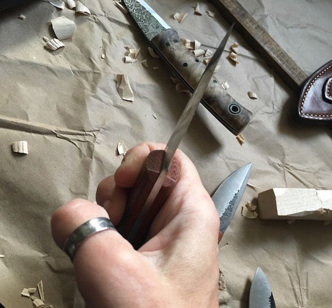

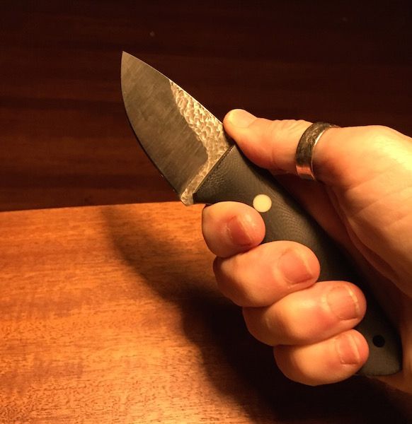

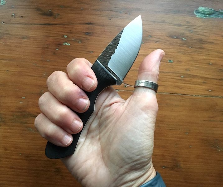

A final consideration in this go-round: as in previous Compares, I once again picked up each of the knives in succession to inexpertly smallen a block of basswood, and once again learned a lot, fast, especially when making draw cuts. The knives in my current stable fared well, the newcomers less so.
(Draw cuts make up a statistically small percentage of my regular knife tasks and uses, but when I want to make 'em, I want to make 'em.)

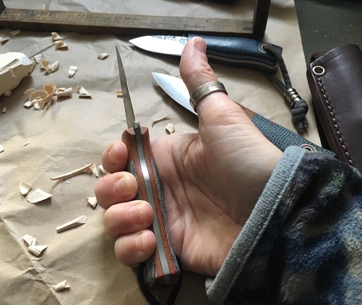

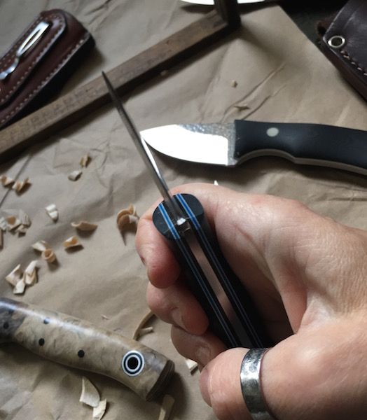

I spent a lot of time trying to determine which attributes factored in to the knives that worked well, and those that did not, and then trying to capture this in pictures.
In addition to a handle's linear geometry-- parabolic knives tend to be problematic, and the Tusk was no exception-- I need a certain degree/type of handle width in order to firmly grasp the knife in my fingers. If a handle is too thin, even (especially?) if tall, I cannot comfortably achieve the fingers-only grip needed.
It all comes down to the openness of 'C' formed by my fingers when grasping a knife's handle.
Esquire:
IMG_9140.jpg~original
Sgian Dubh, with a clearer view of what I mean by the 'C' of my fingers:
IMG_9145.jpg~original
The SD's girth makes it possible to keep the knife in my fingers, with no extra effort required to prevent it from falling down into my hand.
IMG_9144.jpg~original

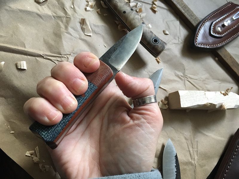

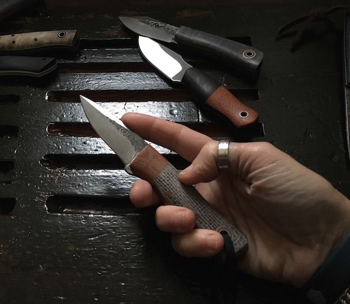

The Runt stepped up to the plate:
IMG_9150.jpg~original
(Again, notice the relative openness of the 'C')
The EDKarda in the left background excels at this grip, but its illustrative picture didn't turn out. Meantime? Get thee an EDKarda; it's a woods monster, at least in Scandi form such as mine. It looks at wood, and wood flays and chips and dwindles. #word
The Tusk revealed itself to be a 100% fist knife, so completely that I ended up more in awe of design intent than frustrated that it wouldn't 'behave' as I wanted it to. In fact, it is more comfortable for me 'backwards' (once fully in hand) than in a regular forward grip.
Fingers only; once my hand closes, my thumb fits into the forward groove.
IMG_9018.jpg~original
Hmmmmm.
sly.gif~original
When attempting to hold it for a draw cut, my fingers had to almost close in order to maintain a firm grasp, with the handle constantly trying to wriggle down into my fist throughout:
IMG_9152.jpg~original
[The blade angle and handle geometry of the 24/7 also did not lend itself well to draw cuts; it's manageable, but not the best choice. I didn't take a picture of Why because I want one anyway, so there.]
