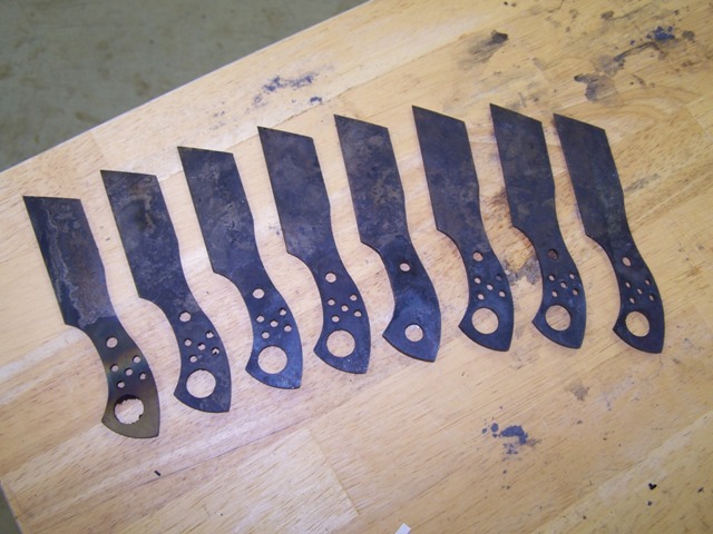

I make currently make 7 models. I've submitted the drawings to Great Lakes Waterjet, and I usually have him deliver me 20 or so blanks to add to the 10 or so I might profile myself. I try to heat treat batches of 30 or so blades, then finish them up in batches of 4 or six at a time. I only use 01 steel for my knives, and my grinds are convex. Most of the time I like using a corby bolt for the front pin. The lanyard tube I've been making up sometimes is metal, then g-10 or mikarta, then metal.

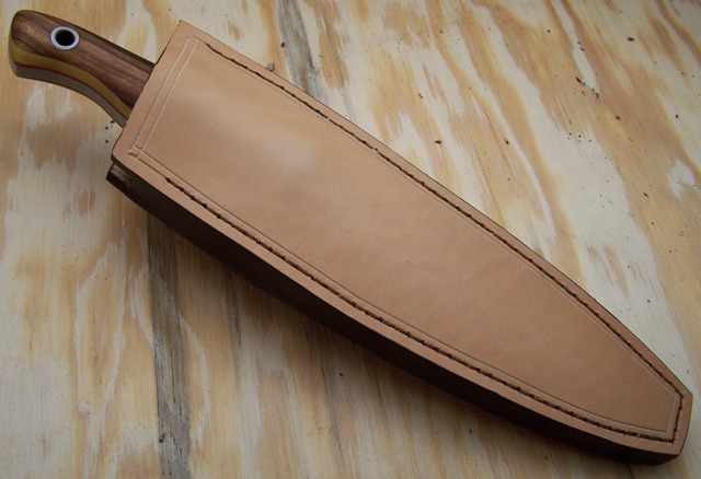

I'm moving away from making my own sheaths. I will offer them as an expensive option, but they're a money loosing proposition for me. I've now sent all 6 of my models off to JRE so they can make patterns for them. JRE makes a solid sheath, and its WAY more cost effective for me to buy them because it takes me almost as long to make a sheath as it does to make a knife. I will make one if someone insists and is willing to compensate me for the effort.

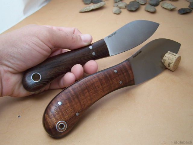

I make two Nessmuks. THe smaller one has a 3/32" thick blade that is 4.5 with a 4.5" handle. I leave for ge scale on this knife because I think its appropoe to the design. The larger blade is mainly wider and curvier the blade is 1/8" thick and its roughly 10" long.
Small:
Large:

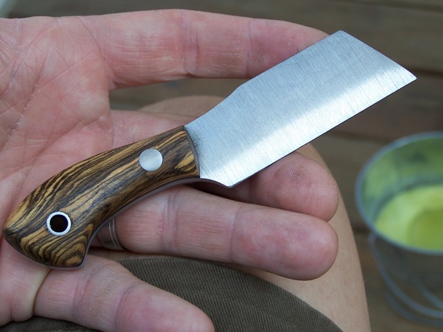

I decided I needed to make a neck knife, and drew up this one I call the Bow Legged Joe on a whim at my desk at work. I thought it looked silly, but after making one I was really impressed, so here it is. Its main function is a work safe knife to open boxes or trim paper, etc. It is 1/8" thick.

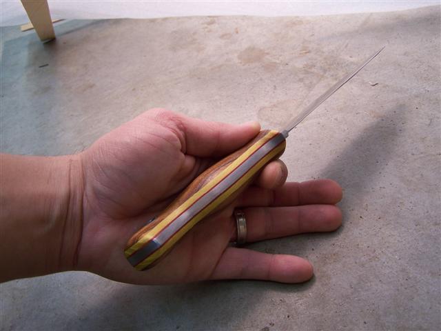

This final knife is my Woodsman. Its 10.5" long. 5" handle. This one is 3/16 thick, and its the thickest blade I've ever done. They're going to be 5/32" thick usually, but I may ocasionally do a few in the thicker steel. The front pin is a SS corby bolt. The handle is Goncalo Alves (maybe my favorite wood) and Osage with a red liner. This is my favorite knife I make. I made this one for me so I can do some testing. I even spent a bit of time hand rubbing the blade.
