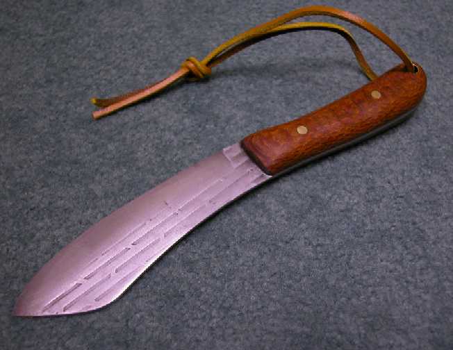

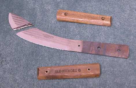

I started out modding Old Hickory blades (boo Ontario!), they make a great platform for the newb to get started and make his own cutting tool!
Don't be afraid to drastically change the handle shape, drill new holes for pins, and ignore exsisting holes!
If you're interested in doing this project, there is an EXCELLENT tutorial by Dirk Potgier here:
http://forum.ramanon.com/showthread.php?t=43069

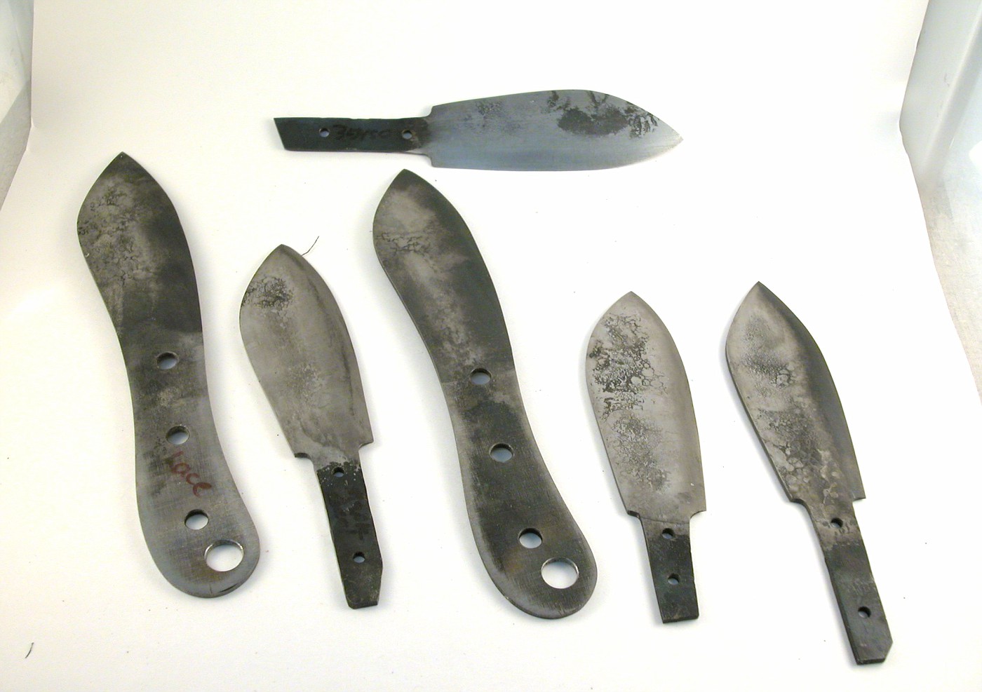

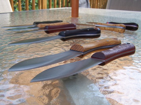

Hollowdweller helped to guide me into designing my own, and soon I did this batch. It was my first! They are 3/32 (thin) 01 tool steel. THe blade is ~4", the handle was 4". Since then I've added .5" to the handle, but pretty much try to follow these guidelines. Once or twice I've gone up to 1/8" on these. Nowadays I use 1095 usually.
Batch #2. The forge scale didn't turn out as interesting on this batch, so I ground it off. Thats usually my deciding factor. If the forge scale makes interesting patterns, I leave it on there. I hate polishing blades, so if it doesn't I take em to 80 grit, then go to scotchbrite.

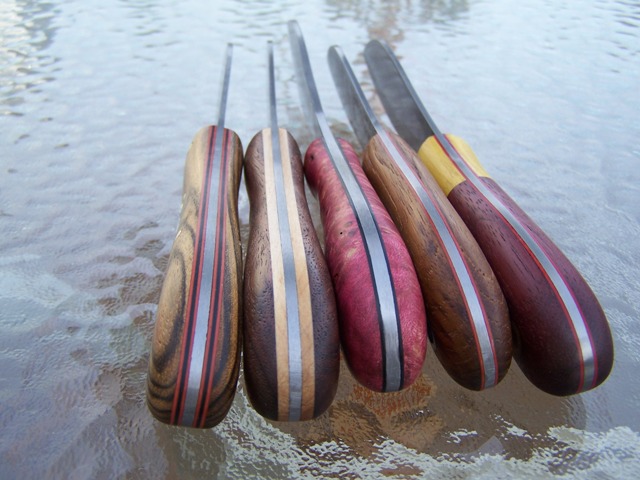

Handle shape is very important to me. Here you can see some of the contours I put on the handle. Its time consuming, but I want a tool you can make 100 notches with and get no blisters!

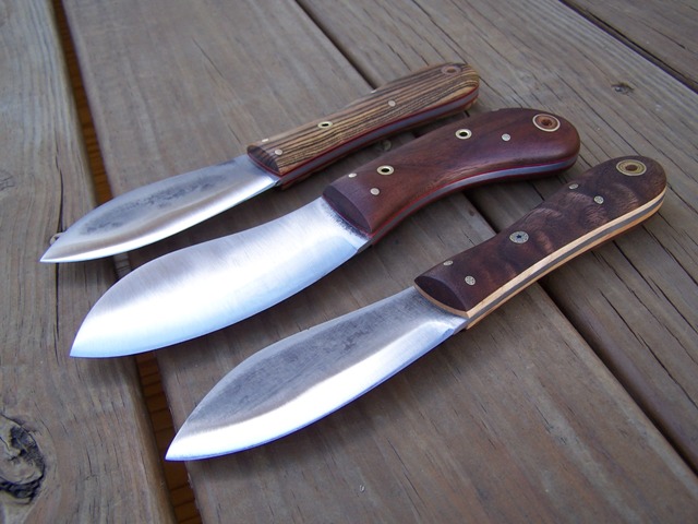

The bottom two knives in this pic are my larger thicker fancier Nessmuks. They're 1/8" 1095 steel. They're really not all that much longer, but they're thicker and curvier.
Lacewood and Purpleheart... Yummy.

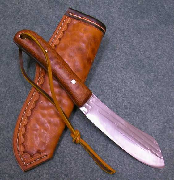

NIce work as usual Andy, What kind of grind do you usually put on a nessie?
I usually put a convex grind on everything I make. Though, lately I've been experimenting with flat. But I find convex to the the best in most cases. Some of these (batch #2 I think) I did a convex scandi grind like the one Dan is doing now.:thumbup:;) I liked it, but I worried that it was going to be harder to maintain. I haven't heard any complaints though.

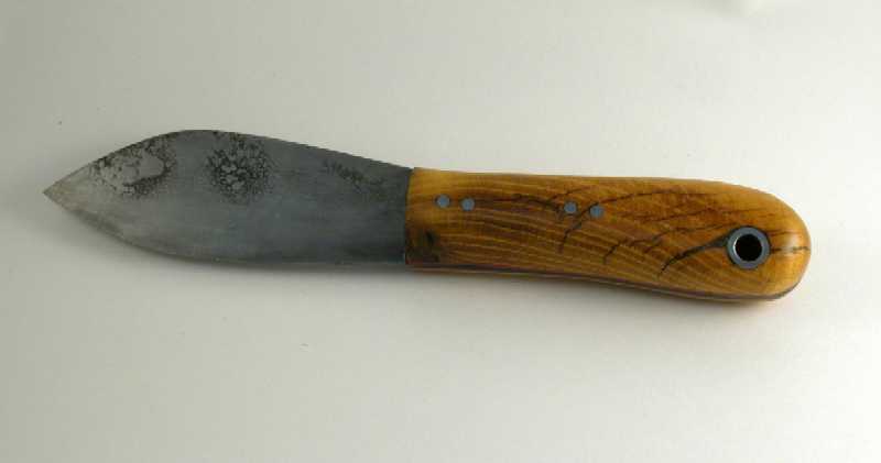

For the life of me I can't find a pic of the knife I made HD. But he posted a pic, so I'm goint to link to that. Its the 2nd fromt he left.

I've got a charcoal forge (Tim Lively style). I take them to non magnetic and allow to cool in still air 3x, then get them to non magnetic and allow them to soak then quench in peanut oil. (for the 01)
For the 1095 I quench in parks. Same process. I've found I like the 01 a lot better during heat treat, but it costs 3x - 5x more.
