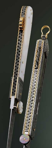

I would like to know your opinion on file work. In most cases it serves little use but man I like what it ads.

I like it when it's perfect, subtle and fits the overall theme of the knife.
But that's pretty rare and I don't like it now as much as I did in the past.
No explanation why
I'm sorry, but as a collector as well as a maker, this is a bit of a soap-boxer for me... (Not that it should really matter. Just one man's opinion so please read it as such...)
Very subtle little accents are fine... But, when I see file work on the edge of every surface it leads me to believe the maker has some trouble getting dead flat surfaces to meet each other cleanly... It is a cool skill to learn, but I have yet to sell a knife that had file work on it...

From a practical standpoint, file work is just a place for bacteria and other nastiness to accumulate. It is also a good place for a scale to start popping off, or to chip out if dropped. Sharp angles in file work are a great place for stress risers to start as well. I might add, when it does come to file work, some of my favorite that I consider tasteful is seeing file work with dyed epoxy laid into the file work to match a spacer. That looks clean... Like this...
I think it is one of those things that is faddish and kind of catches you up when you first start getting into higher end knives. You start looking at customs, and see the gaggle of them out there that have file work, and a first are really impressed. It looks cool, and catches your attention. Then you settle down and start looking at true fit and finish, or make a knife yourself and you realize there is more skill in perfectly mating two flat surfaces, or getting a clean 90 degree joint between materials than there is in marking off a spine and filing a pattern. The exception for me is when we are talking about folders. Folders are already, by nature, a hotbed for trapping every piece of pocket lint and crud from your hands. Just fitting up a custom folder is hard enough and shows enough skill that file work doesn't appear to be hiding anything. There, it looks good to go a little overboard. But, I have an exception in that I like the file work on the spring-back and liners, etc, but not on the blade in that case... Dunno, matter of taste I guess.. Like here, it looks good to me...

I meant to add, what you have pictured there is nice, clean, uniform, and looks great...

I like it! This pattern is not over the top to me.
I like it on the spine of a hidden tang (when done with taste)
i agree with some of the points lacy brought up but i do like the file work you have done. Tasteful yet simple and not over the top in your face.

image.jpgGreat break down! pictures, correctness, humor. File work can subtract, as well as add to the piece. I like the epoxy filled look. I haven't seen that before. I did a full tang in a similar way but with only one size file. It may be a little much but I still like it.
I tend to like filework if it's done properly, if it's even, fits with the overall design of the knife, diminishes with tapers of the blade, etc. It serves the same function as jimping, but with a far more artistic element. It shouldn't be on kitchen knives for the reason that Lucy mentioned nor should it be on tactical knives for obvious reasons-but any other knife, it has its place if done right.

Edit: just to add. The filework I see on your knives Michael is just about what I would consider right. Fitting for the style of knife, and not improperly deep or too busy a design. Now if I tried to put your filework on my style of blacked out minimalist nitty gritty knives it just wouldn't look right at all...

I don't like it going all the way up the blade either. It also looks best when the cuts are either filled or blued to accent the pattern.
I like the design you have, but it's too much for me - would have liked it better if you would have found a nice way to cut it off at the ricasso.
Mattd...I like file work. I think it ads an artistic touch to a knife. Can you give us a tutorial on how you did the twist pattern in the knife shown?
I would love to give a tutorial a shot. I have only done a few but I am happy to tell you what I know. It will be good to hear what the more experienced guys have to say too. I'll work on it soon and post it here. Guys have done a couple good YouTube vids as well.
