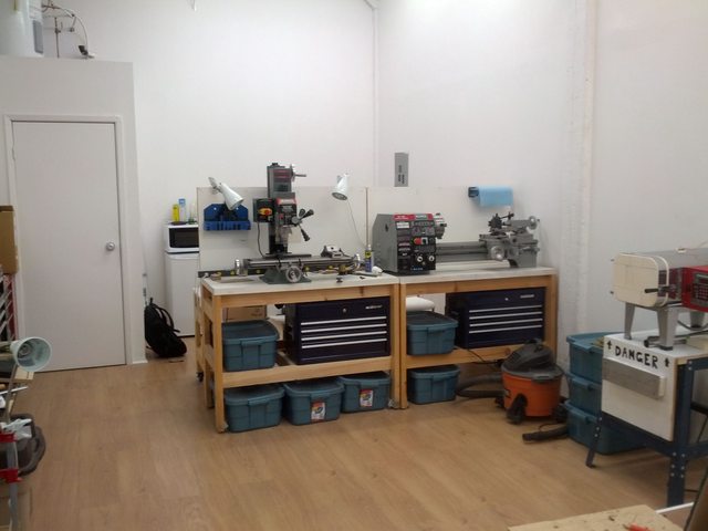

Aaron, just spent 5 minutes watching in pause the snapshot of our shop at the beginning of the video, cool way you choosed to separate the dirt/clean areas, can you share some more photos?

Hey Pablo!
Here are all the images I have in my imgur account that show the layout of the shop:
The fans and filters keep a very slight positive pressure in the 'clean' area, which helps to stop dust from getting in there. Not sure how effective that system really is as it's fairly new, but the filters are definitely catching dust which is nice.
I'll be pulling up the floor soon as I recently discovered there's a nice painted concrete floor under the laminate, and I could do without the fire hazard! I need to do some work to make the place feel a little more homely too, as right now it feels a bit sterile...
Hope that's helpful!
